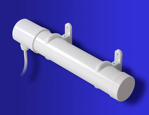

I just bought one of these to heat up my airing cupboard (now the hot tank has gone)
650watts (less than 3 amps - so OK to run from lighting circuit) and has a built in thermostat. Small. Cheap too. It works really well.
