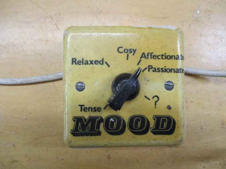

So far I've only been able to find one I built which clearly does have a bridge rectifier (with 1970-sized discrete diodes). It was built around 1970/71, when I was at uni (hence the labelling of the device :) ), and I imagine must have been one of the first times I used flex with 'new colours'.
Kind Regards, John
I hope the settings between 2 and 5 o'clock brought much joy!
That was clearly the intent, but (through all the uncertainties of long-term memory!) I'm not convinced that it every actually worked :) .
On reflection, unless I (and/or those I associated with) had a thing about bright illumination at the time, I presume I must have wired the potentiometer 'back to front'!
Kind Regards, John

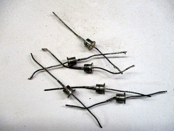

Been a while since I've seen top-hat diodes.
I have plenty just like that, but it's certainly been a good while since I used any of them.
However, there's obviously nothing 'obsolete' about that shape of package. These are relatively modern medium-power zerer diodes ...
Kind Regards, John
