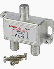

Something like this 1741770302316.pngwill have something inside, so the signal is shared. It is not a case of winding the wires together.

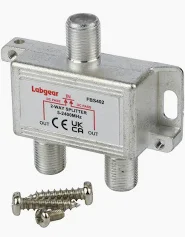

Something like this View attachment 375922will have something inside, so the signal is shared. It is not a case of winding the wires together.

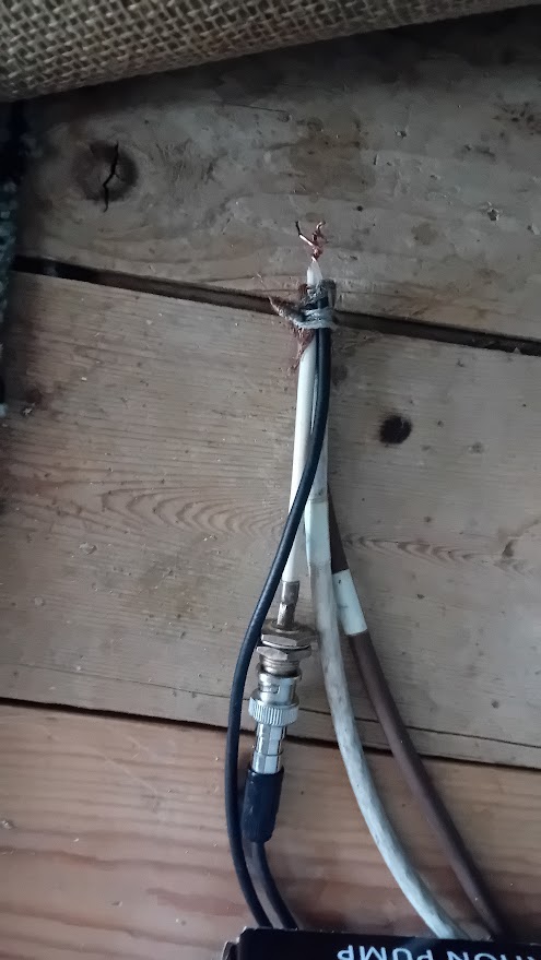

It's rather embarrassing to admit this:
is one of two of my TV network joints lurking under the floorboards, the brown and white are the feed from the aerial and to the other joint, the 2 blacks are 10m ish feeding TVs, the top is 1200Ω (1.2KΩ, typical of car radio aerials), the short piece of cream is 75Ω and the bottom black is RG174 (3mmOD 50Ω).
The other joint is just the same construction and includes RG58 (50Ω), RG59 (75Ω low quality video type), RG62 (92Ω data) along with regular cheap TV coax with a hint of screening.

I could just use electrical crimps for the split and then solder - solder to increase conductivity.
No, don’t do that. Use the splitter that I linked to.
It’s not about increasing the conductivity, it’s about matching the impedence.
I am curious, what would happen if I did do it? What end-user effects would I see? BTW, it would have worked. Explanation to follow.
