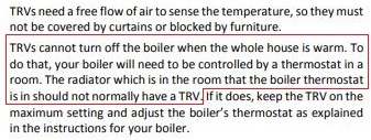

The guideline I have been given is that one rad must NOT be on a TRV otherwise boiler has nowhere to pump water, just closed loop.
This is a standard basic TRV.
So are you saying I should have the TRV working in the hall ?
If that is HIGH it will have boiler pushing out heat until it is satisfied (if Prog on) if set Low then it would be turning the boiler off before other rooms are warm.
I have wall fixed the stat/programmer in the hall (where Honewelly stat was), and removed TRV valve'head unit' from the rad in the hall, seemed logical not to have 2 stats in same area.
The heating system should be designed with a by-pass so that there is always somewhere to allow water to flow. This may be in the form of a radiator with lockshield valves so that it can't be turned off fully, an external by-pass device, or a by-pass that is integral with the boiler.
This is a different matter to the practicality of having a TRV on the radiator in the same location as the room thermostat. The bottom line (as you have figured) is: If you have two devices trying to control the temperature in the same room, one will interfere with the operation of the other. Most thermostats come with this advice.

If the TRV turns the radiator 'off' before the temperature set at the room thermostat is reached, then the room thermostats control is overridden, it will not operate and therefore becomes ineffective.
That is what I expected ... so have done the right thing and removed the TRV ‘head Unit’ ... pretty sure R3 o I g the adjustment head puts it on full flow.
