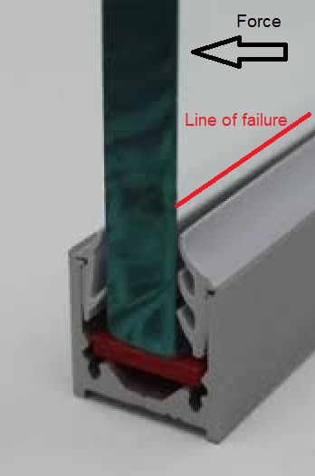

If the channel does not release it's grip on the glass then the force ( the weight of person falling ) will snap the glass. Think of car windscreens the have been head butted.
So are you saying that a structural glass balustrade suitably mounted to an adequate structure and designed to enable people falling against them and subsequently breaking will actually break if someone falls against it? The image you posted is irrelevant and woefully inadequate to support structural glass.

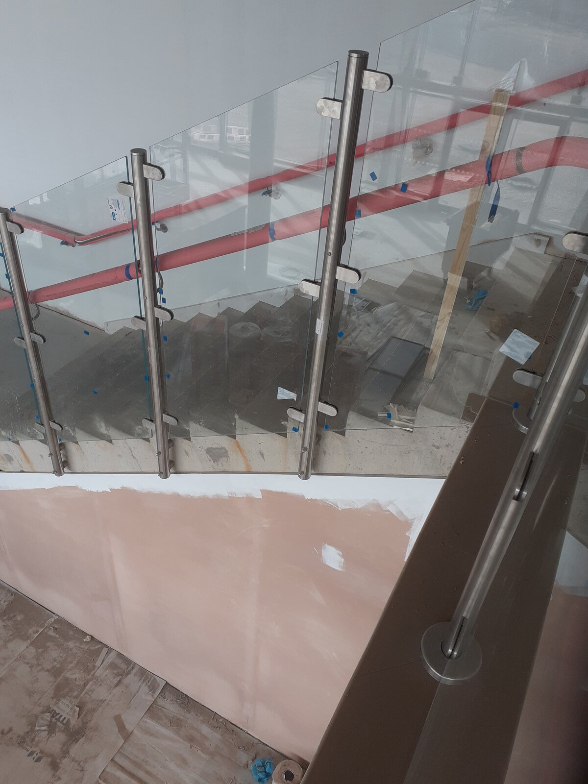

On most of the bucket section I've seen the glass is resin bonded into place - you'd certainly want to do that on a staircase to circumvent any tendency for the glass to slide downwards. A lot of the glass used is thick laminated glass, like this:
(Alright, not bucket held, but illustrates the same sort of glass). I can assure you that it takes quite some force to break one of these thick pieces of glass and breakages are often ascribed to faulty toughening (not that.you see many) - I have seen then being hit by pallet trucks loaded with a tonne or more of cement or timber.
