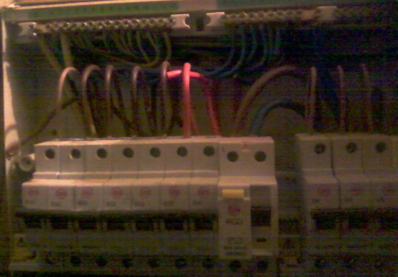

I'm hoping for a bit of advice here as I have followed guidelines thus far and come to a halt.
I've just completed the structural work on a loft conversion and have got as far as finding power sources for the lighting and mains circuits.
On direction I had a look at the existing setup which is a consumer unit running an 80A RCD with 6A MCB lighting circuits to the left (unprotected) and 32A MCB mains to the right along with cooker/showe protection.
I would find it very disruptive to access the consumer unit and add an MCB as the routing is very complex. Ideally I would like to tap into 1st floor circuits which are more accessible.
I have checked and the mains circuits appear to be radials (twin cables in, no continuity when powered down from RCD and multimeter bridging neutrals removed at the sockets back). This ties in with the information the last spark gave me when he tested the house.
I was hoping to tap into a double socket and extend upwards on 2.5mm cable to a 13A fused FCU and take sockets from there. However as its not a ring circuit I am unsure if this is advisable.
I feel stupid about asking regarding the FCU but the information I have seen so far is mainly covering ring only circuits.
Also, can I break into the existing lighting loop at looped ceiling rose and add 2 switches and 2 bulbs?

The lighting circuit can be extended by branching the circuit at a convenient rose as you propose. Note that you will need to add an RCD to the lighting circuit unless you follow the rules for non-RCD protection, which will normally mean surface wiring or trunking.
As for the socket circuit: If it really is a radial circuit protected by a 32 A MCB, then you may extend it with minimum 4 mm² cable to supply more socket outlets, subject to de-rating / voltage drop / Zs limitations.
You need to ensure that it really is a radial - 32 A radials for sockets are not common. Have a look in your CU - what size are the cables for this circuit? are there 2 line conductors connected to the MCB?
If it is a ring, then you can supply multiple sockets via a 13 A FCU, but the spur will clearly be limited to 13 A load.
I'm struggling with those pics to see clearly, but they look like radials. Are the cables 4 mm² with stranded conductors?
Yes, 4mm (or slightly more) with copper stranded conductors. Is there any way (better/closer images) to determine more accurately?
Measuring it wilth a ruler is useless - it's the area you need to determine, not the diameter.
But it looks like this is indeed a 4 mm² radial circuit. The cable sheath may be marked with its cross-sectional-area. That would confirm it.
On the basis of the above, you may branch/extend that circuit without needing a FCU, provided that the cable is not subject to any de-rating factors (like being installed in contact with insulation) and its length is such that the voltage drop and Zs are within limits. You will need to use
the same size cable, i.e. NOT your 2.5 mm².

You can branch from the most covenient accessory anywhere along the circuit. If it saves cable and is easier, then you can have further branches, branches off branches etc.
Tip: Use deep back boxes: you might get 2 x 4mm² cables in a 25 mm deep box if you're neat. 35mm deep for 3 cables.
Please confirm the cable size of that circuit before proceeding: you need to know, and building control will want to know. It's no good to 'assume'.
