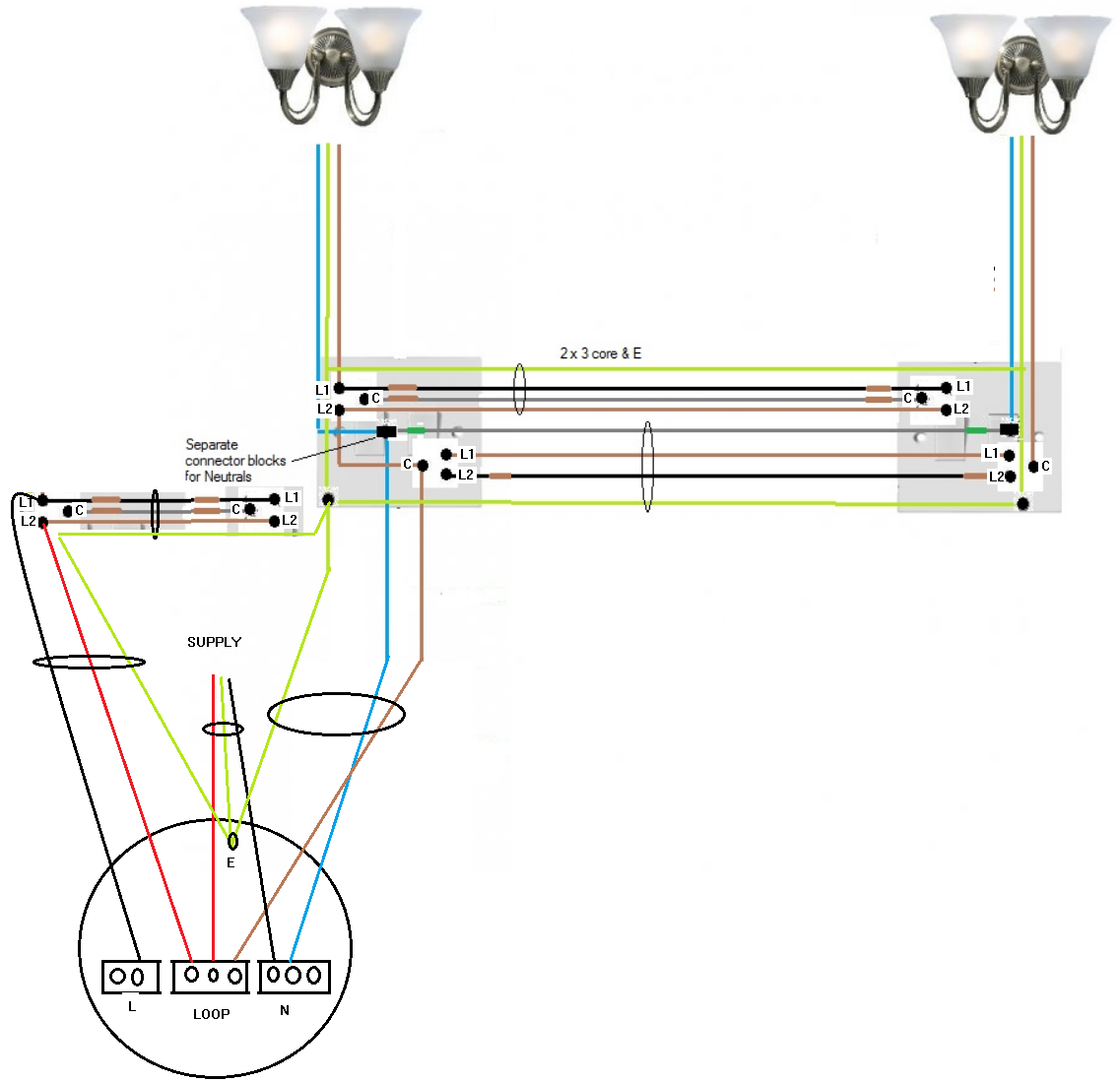

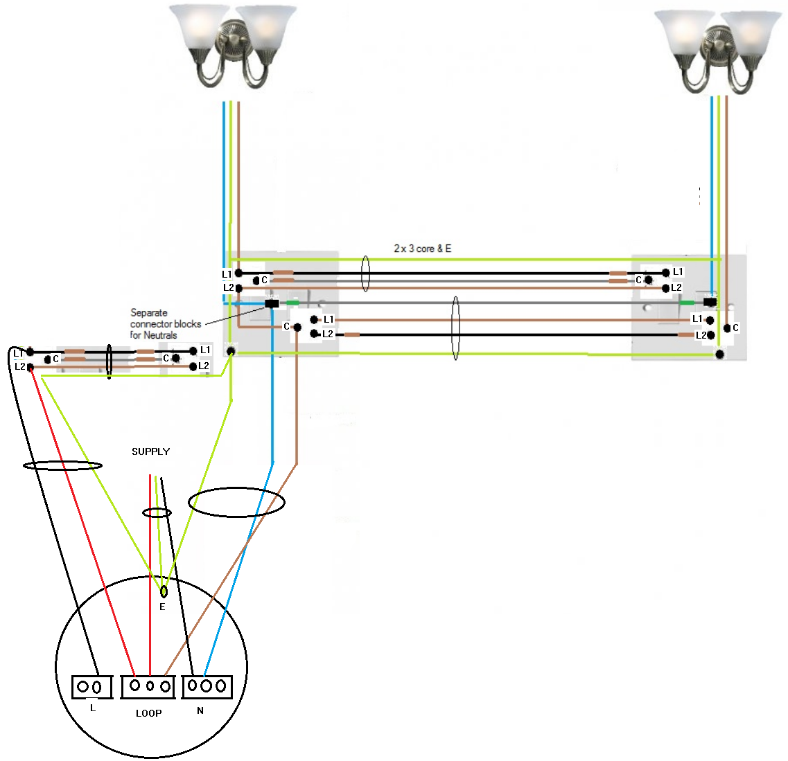

Adding new bedside lights to existing layout.
The only thing that still makes me unsure with that picture is that both the 2way switch wiring is unclear as to which points are l1 l2 and common.
Does this help?
I've included what I predict is the existing wiring [in red and black only to make a distinction]
Does this help?
That is very helpful, thank you so much for your effort. Ive only done basic 2way in the past like run a 2way landing light, so when there are more wires as in this case i get lost.
