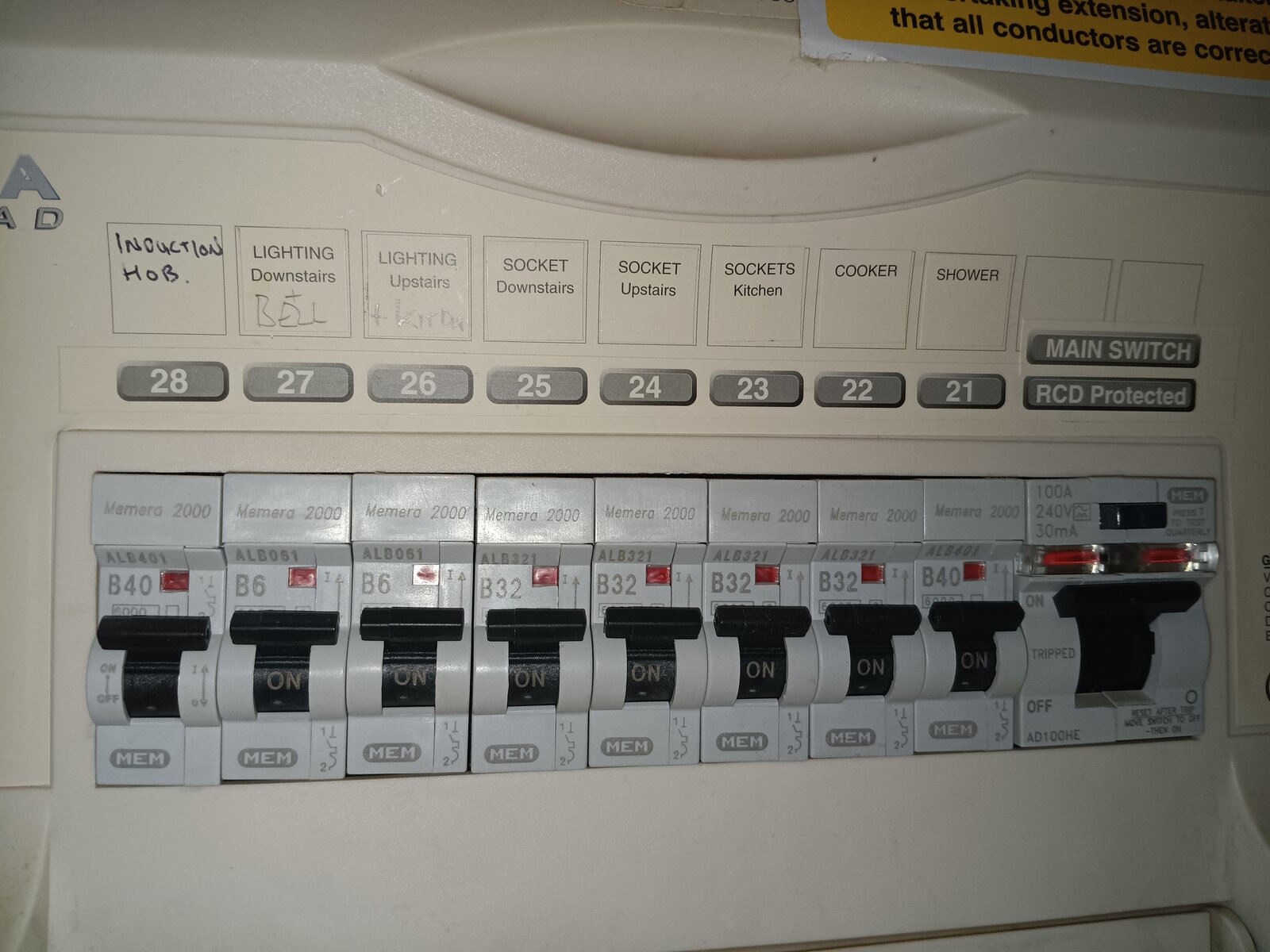

If things go well on here the discussed project will be carried out by an approved electrician.......that's not me.
Plan is for garage to be converted into living space andcwill accommodate the following:
TV, 1.5kw panel heater, fridge, dowlights and 4x twin sockets.
First question?

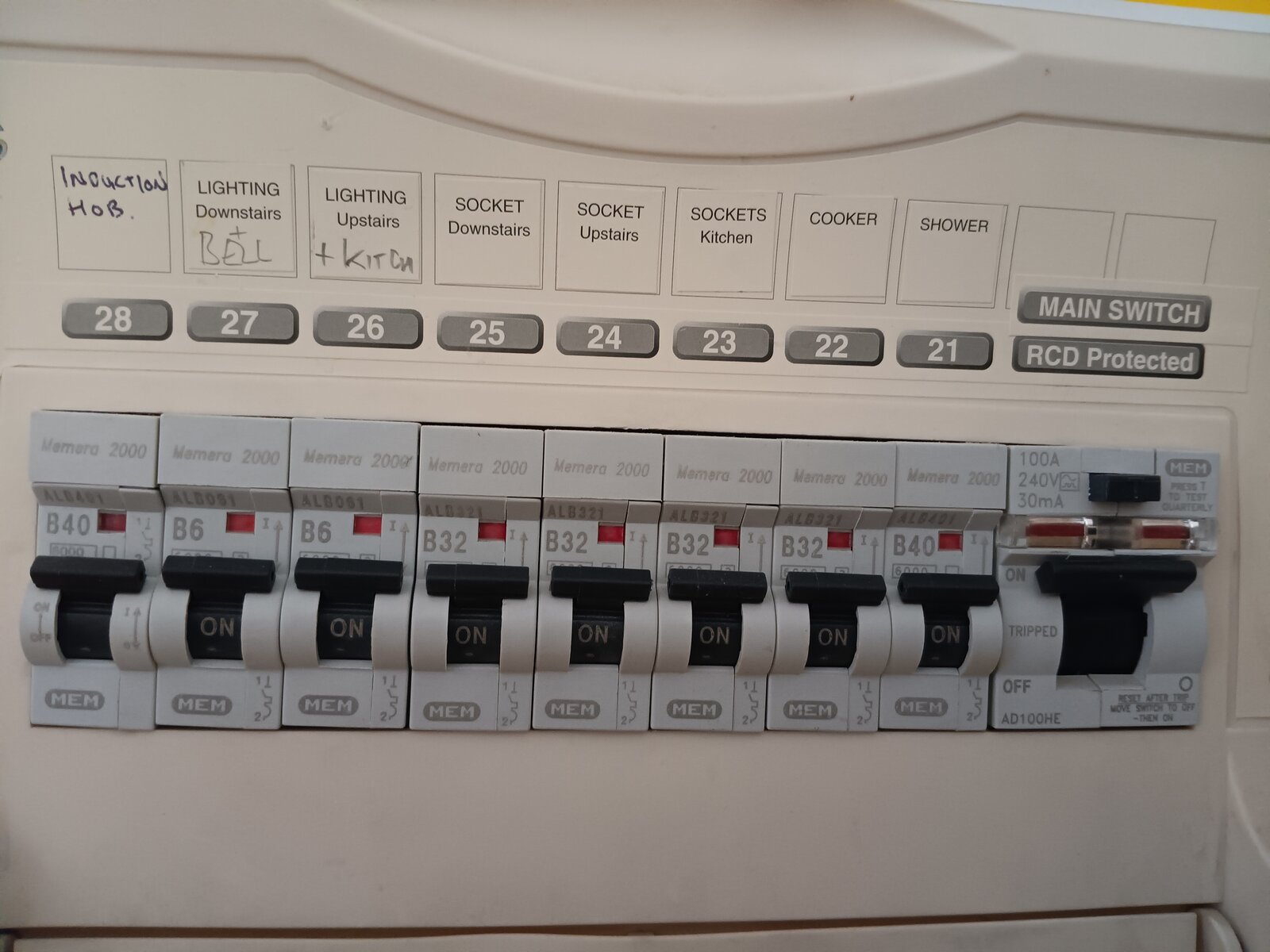

No spare ways at main cu. Can the cu in my house accommodate an additional 40amp mcb if upstairs + downstairs lighting is double upd in 6 amp mcb (see attached)?

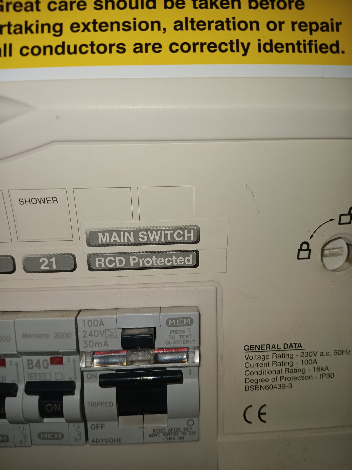

Like many similar installations, your whole house has one RCD (main switch). This means that an earth fault on ANY circuit will cut power off to the whole house until the problem is resolved. This is not only bad practice, it also goes against more up to date regulations.
Your plan to combine the lighting circuits also goes against the requirements of 'separation of circuits'. Your CU also is made of plastic. This also doesn't meet today's requirements. Any new circuits must meet the up to date requirements. Adding a secondary unit really only kicks the can down the road, and that can is called "install a new CU that meets todays requirments"

Your new CU could best have RCBOs, rather than a small number of RCDs. This will cost more, but is a better solution.
You old CU is fine quality, but about 25 years old, and has no room for expansion. It would be possible to retrofit RCBOs, but this would be expensive and no easier than a complete refit, which will be a better job, and you can allow room for future expansion. A large empty tin box costs little more than a medium-sized empty tin box.

The CU you show is no longer suitable, it will need changing, if for no other reason it would be hard to get any parts to fit it. The consumer unit is a type tested distribution unit, and to retain the type testing, you can only use parts which the manufacturer have included in the type testing.

If you had a spare way it would be perfectly acceptable to add it to the existing board
But
Bite the bullet, get the CU replaced before your builder starts and make sure you have 3 or 4 spare ways

I would change it too, it's not worth messing around with it.
It's a poor set up anyway, having an RCCB as a main switch. If there is a fault, you lose everything.
Far better to get a new board with RCBOs.
