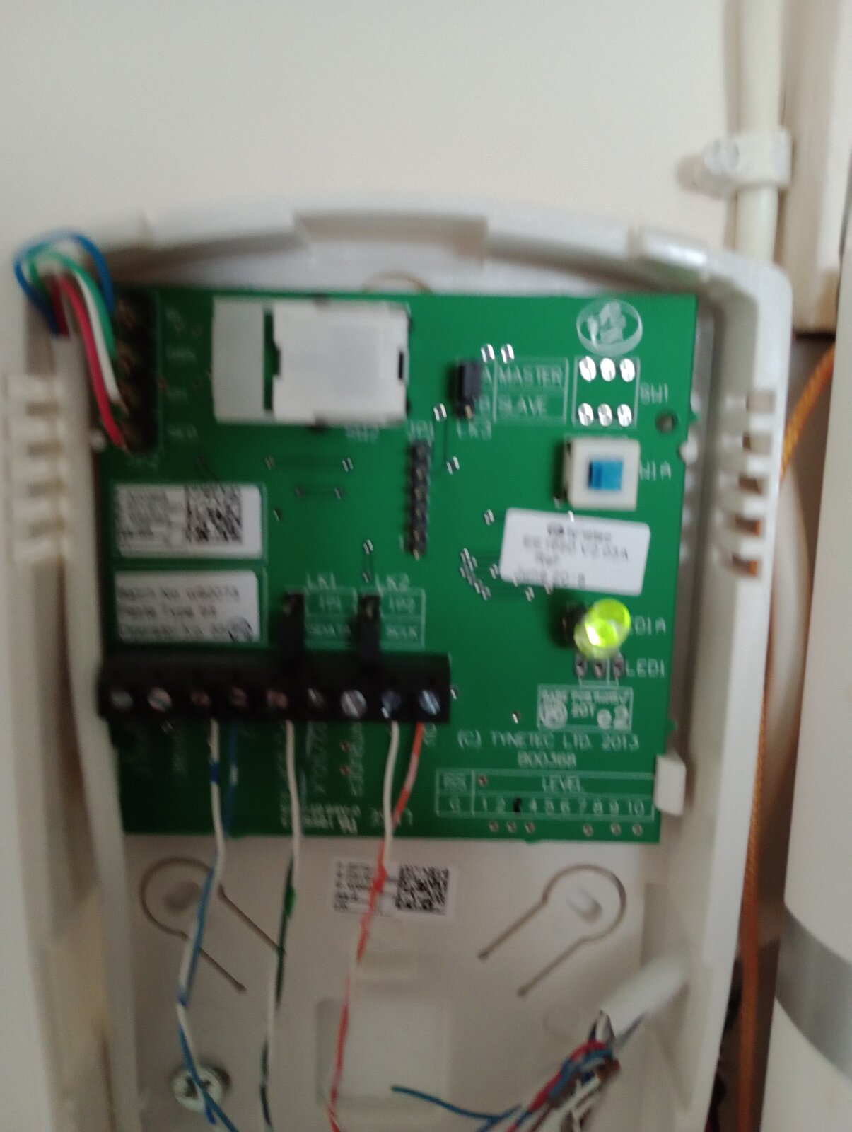

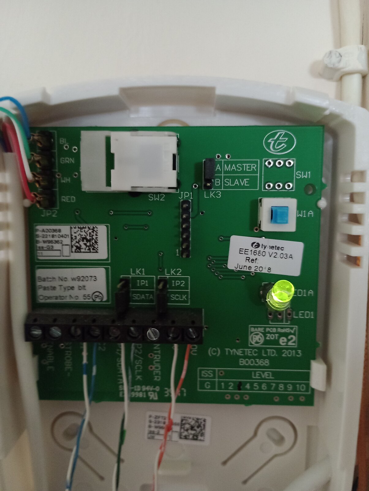

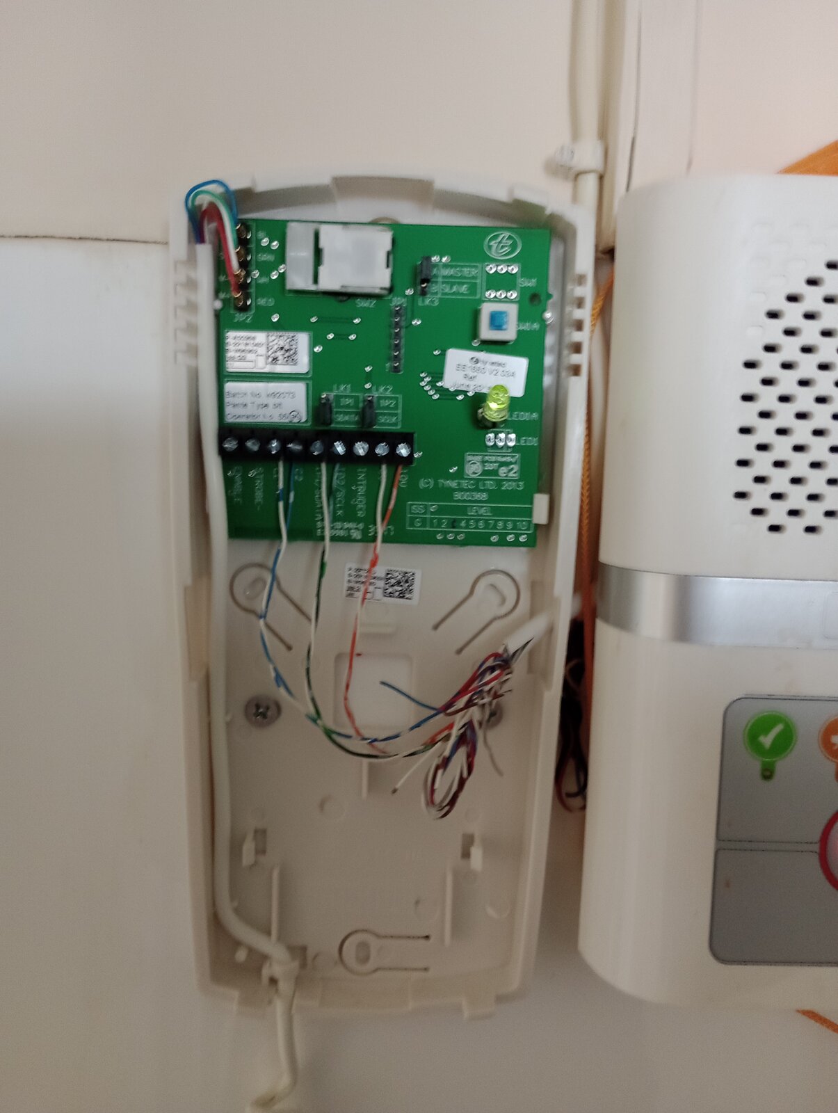

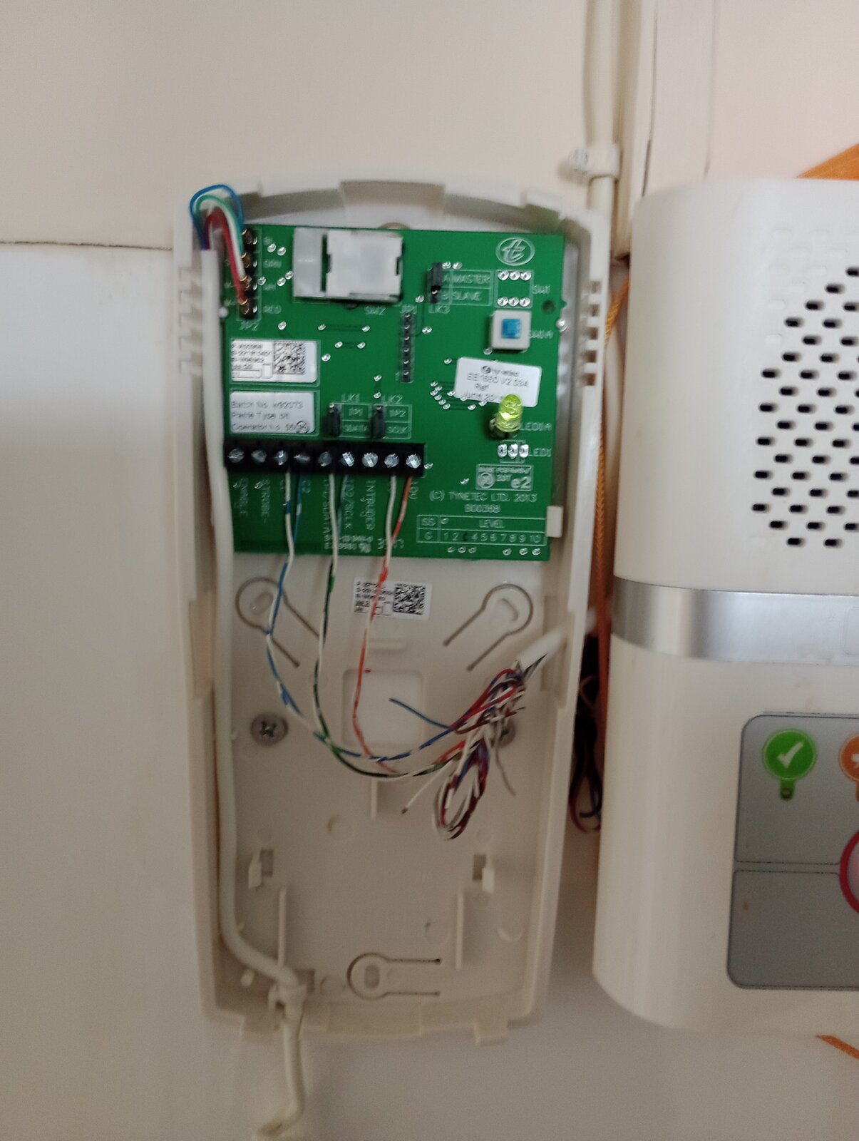

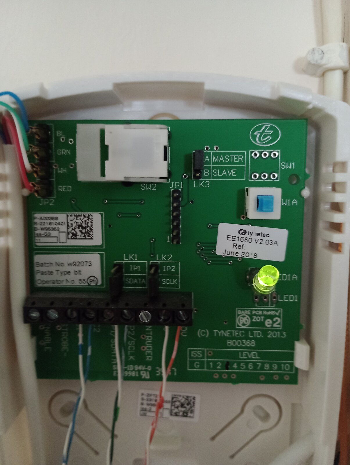

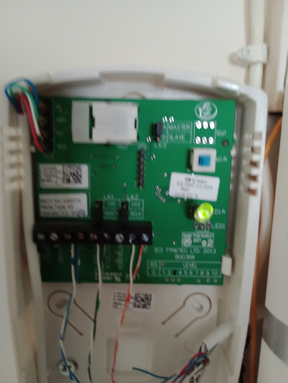

Thanks for your reply hope these help

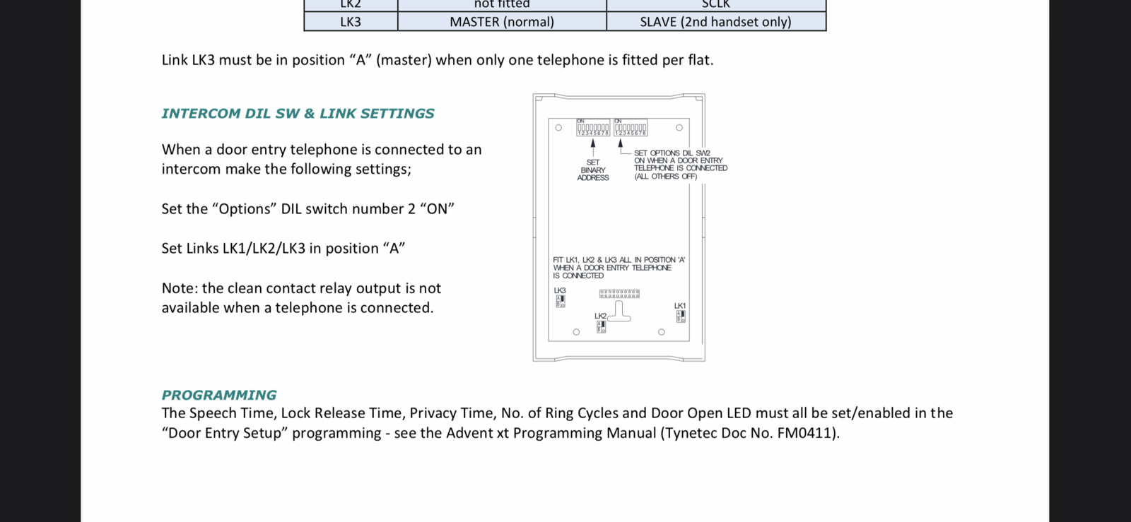

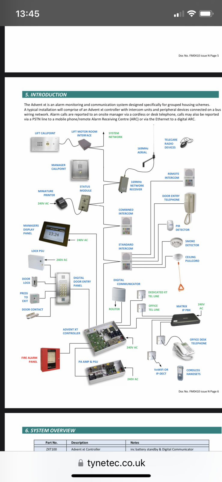

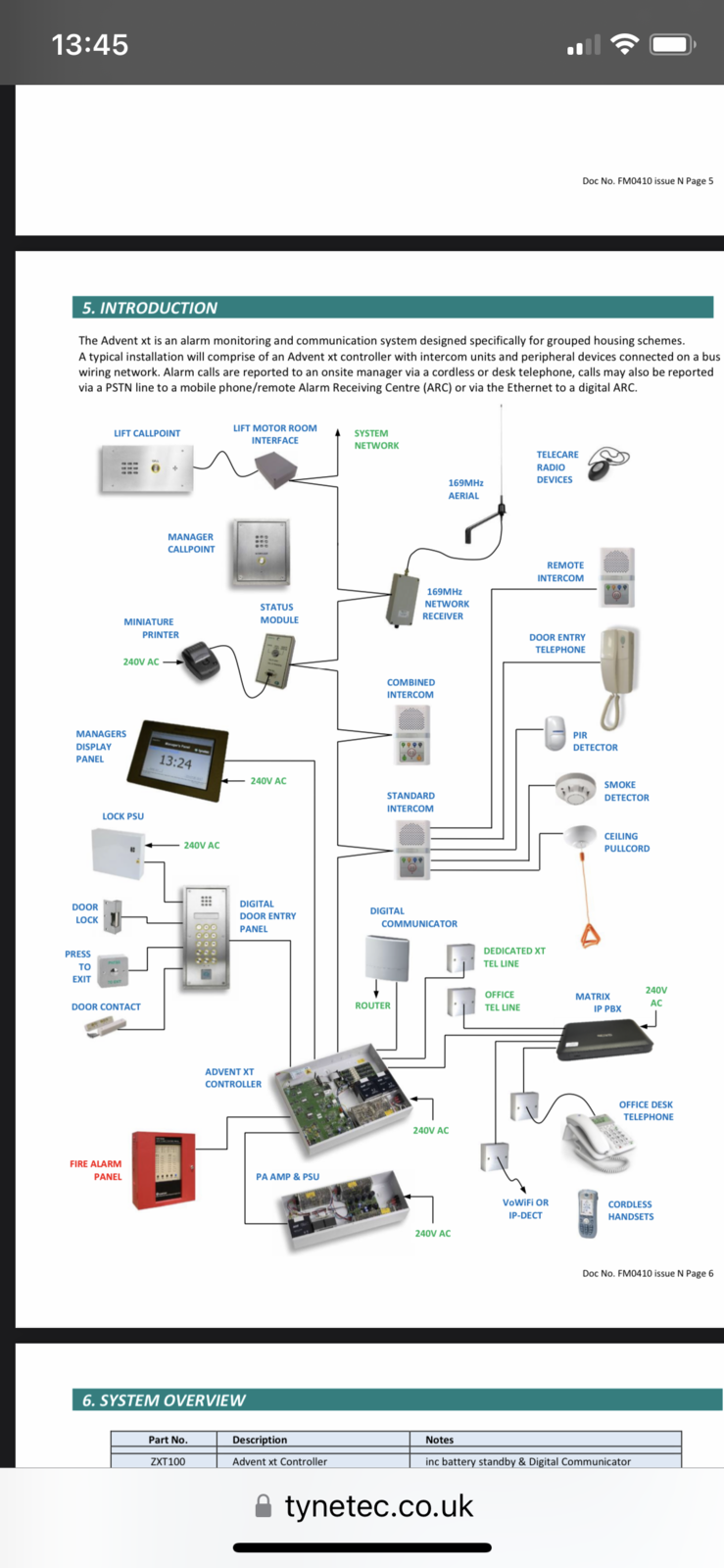

There is no call wire on that handset look at pictures ….I guess who ever programmed the privacy option got it wrong ….who owns this system ?
