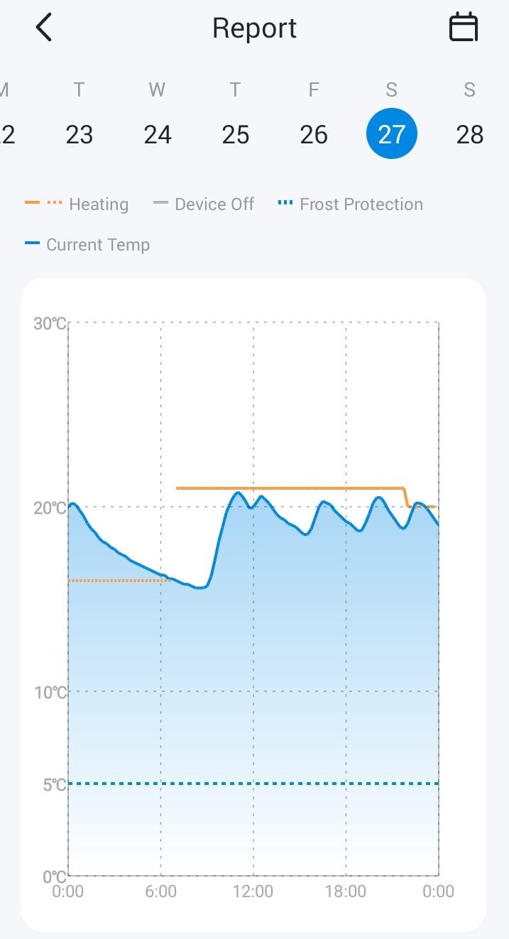

I would have thought the TRV gives one a good idea what is going on. This Report full day.jpgis with no analogue control, on my oil boiler, one should get a smooth top with analogue control.

So mother's gas boiler was circulating water cooler the more the by-pass valve opened, and hot water returned to the boiler, but we are clutching at the last 1 or 2% of saving by adding weather compensation, so maybe £12 a year, is it worth all the effort? The whole 11% is around £65 per year, so not worth spending very much on weather compensation.
