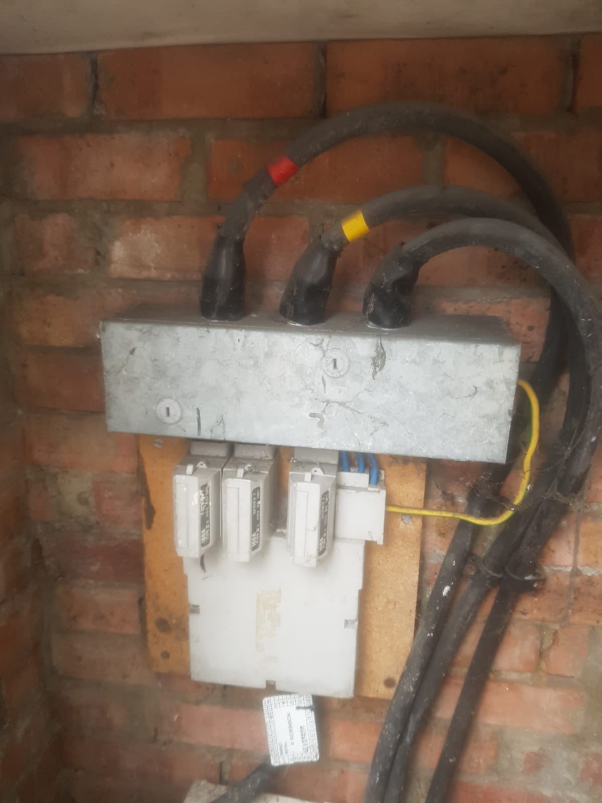

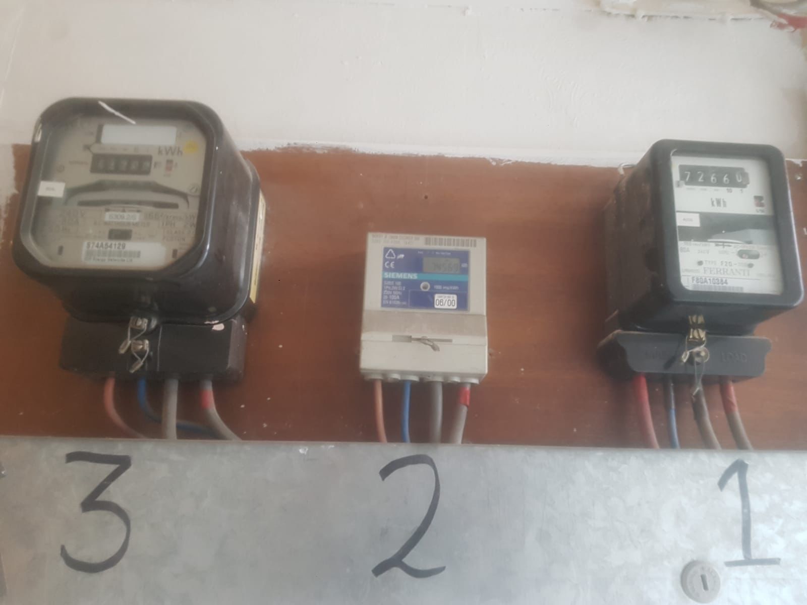

I ve inserted two pictures
One of the current meters and one of the current fuses at ground level
I am told by UK Power Networks that "are no spare fuse ways" and I need a new distribution board - However I honestly dont know which distribution board to ask an electrician to install
The current setup is that I have two RCD boards for each flat but they are both wired into one meter and I dont want to be paying for someone elses usage

The problem is that you have 3 meters and 3 separate fuses, presumably one for each.
A new meter will require an additional fuse, so that the supply can be isolated when installing or changing that meter.
The loading for each flat also needs to be considered.
Is one of those meters for a landlords/common area supply?
What size are the flats, are they all electric, or is there gas heating?
Are the meters and the fuses in the same location, or far apart?

just to explain things better. The distribution board that is current there is in the communal hallway with three fuses for three meters
there are four flats in the house and four rcd boards. Two boards are connected with meter tails to one meter so that is simple to change once a new meter is installed
If I want a new meter I need to install a new fuse on the distribution board presumably which is what o am trying to understand. I do not understand what Uk power networks mean when they say

I think what the DNO are saying is that instead of the current setup of the cutouts directly feeding the meters, a distribution board needs to be installed, which will then be used to feed the meters. So you will have a DB on the "supplier side" of the meters.
What I don't know is what type of DB the DNO would consider appropriate. A normal MCB board would seem less than ideal for this application for several reasons (not least that it makes electricity theft too easy).
I suspect what you should be doing is looking for an electrian who has experiance working with the DNO and get them to contact the DNO on your behalf to hash out what is needed.
I would say they want the two flats to have separate tails, which is understandable, so what is needed is for the place where both flats are combined to be separated, but you don't show where they are combined, likely it will need isolators, so the DNO can simply wire to the isolators, but we can only guess as we have not seen where it splits.
So what @plugwash says, need an electrician use to working with DNO to know what they will accept.

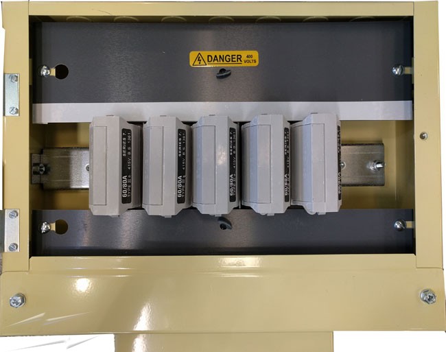

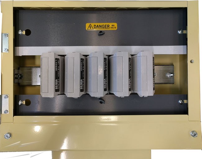

The solution is probably one of these:
installed above the existing 3 phase cutout, with new wiring from that to the metering positions, which may also need additional work depending on space and what's already there.
4 of those fuses for the flats, 1 for the common supply for lighting, door entry etc.
