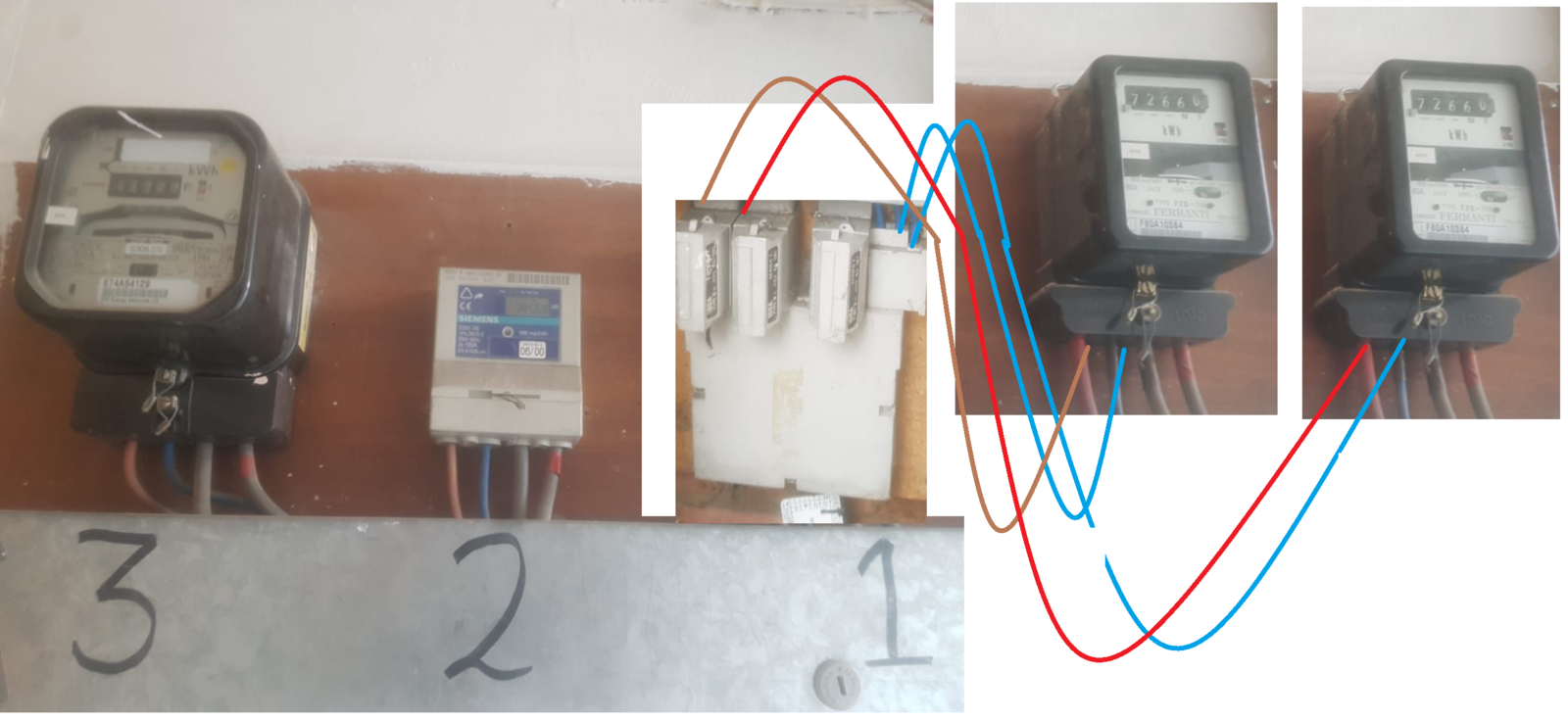

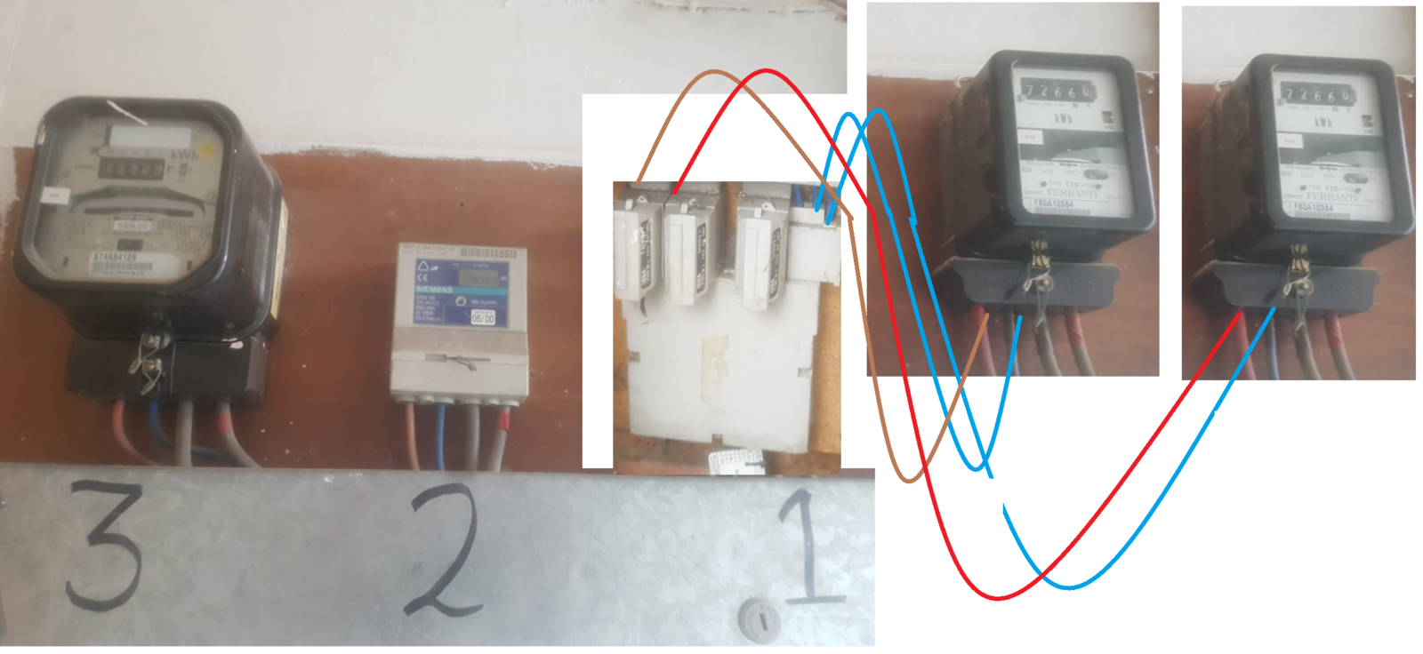

Additional meter installation distribution board
Ryefield board.

Ok Thanks - So this morning the electrician that originally came sent me an invoice for doing the work
He wants to replace the three fuses and install one of these CHINT NXDB 6-WAY TP & N METER READY 3-PHASE DISTRIBUTION BOARD (3872V)
https://www.screwfix.com/p/chint-nx...rd/3872v#product_additional_details_container
Its a days work which is fine but I just want to make sure this will solve it?
I would say your electrician doesn’t have a clue. As others have posted, the ryefield board or the Lucy equivalent. Be prepared you will possibly have to arrange meter operators (for potentially all four meters) to reconnect their meters to this new board once it has been connected to the existing cut out by the DNO. This needs to be done in conjunction with the other flat owners, as it affects their electricity supply

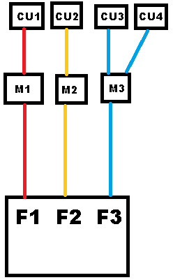

You currently have this:
3 fuses in the service head/company fuse feeding 3 meters then 4 consumer units.
I have tried to show:
an additional company fuse containing 2 fuses to include the new meter. I accept it's a 'bit scrappy' but by no means wrong or unusual.

You currently have this:View attachment 242699 3 fuses in the service head/company fuse feeding 3 meters then 4 consumer units.
I have tried to show:View attachment 242701 an additional company fuse containing 2 fuses to include the new meter. I accept it's a 'bit scrappy' but by no means wrong or unusual.

I understand your drawing thank you. The problem with that is oh need to have a new meter and that requires a mpan number and that requires dno which means a ryeifled board
