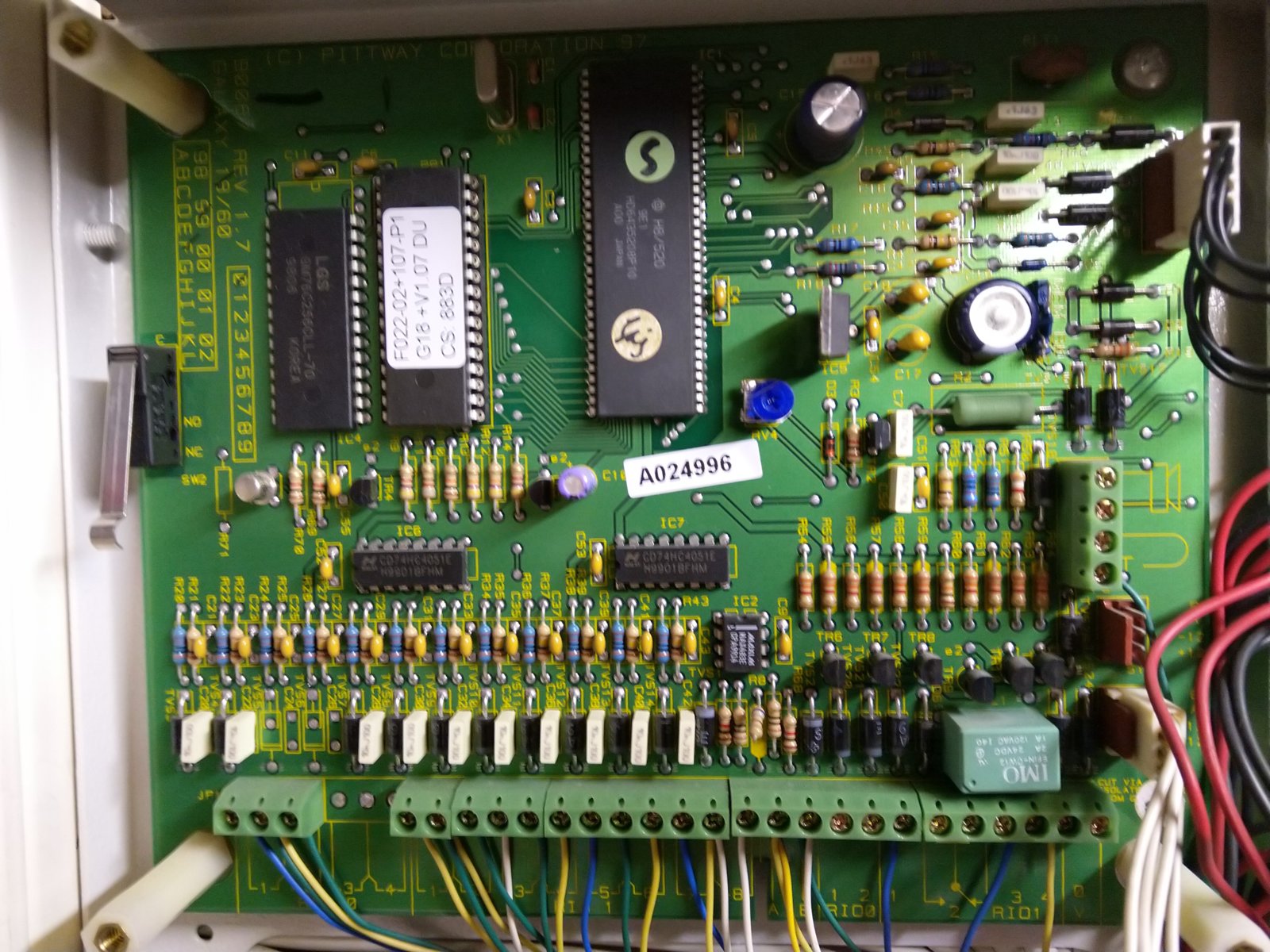

I have an Ademco Microtech Galaxy 18 alarm that looses memory on a full power outage. can someone point me to a replacement battery that can be soldered on the PCB? Below a screenshot from the PCB where I can't find the battery:

Thx. It was printed as a C so I thought it to be a capacitor. I'll open the unit again and check if I can read the specifications on it to order and replace it. The memory link is closed indeed
Just to be complete in this thread in case anyone else needs this info. The original component on the PCB is a DB-5R5D104 - Elna, 0.1F 5.5v Supercapacitor. Thanks again for pointing me out to the location @sparkymarka
