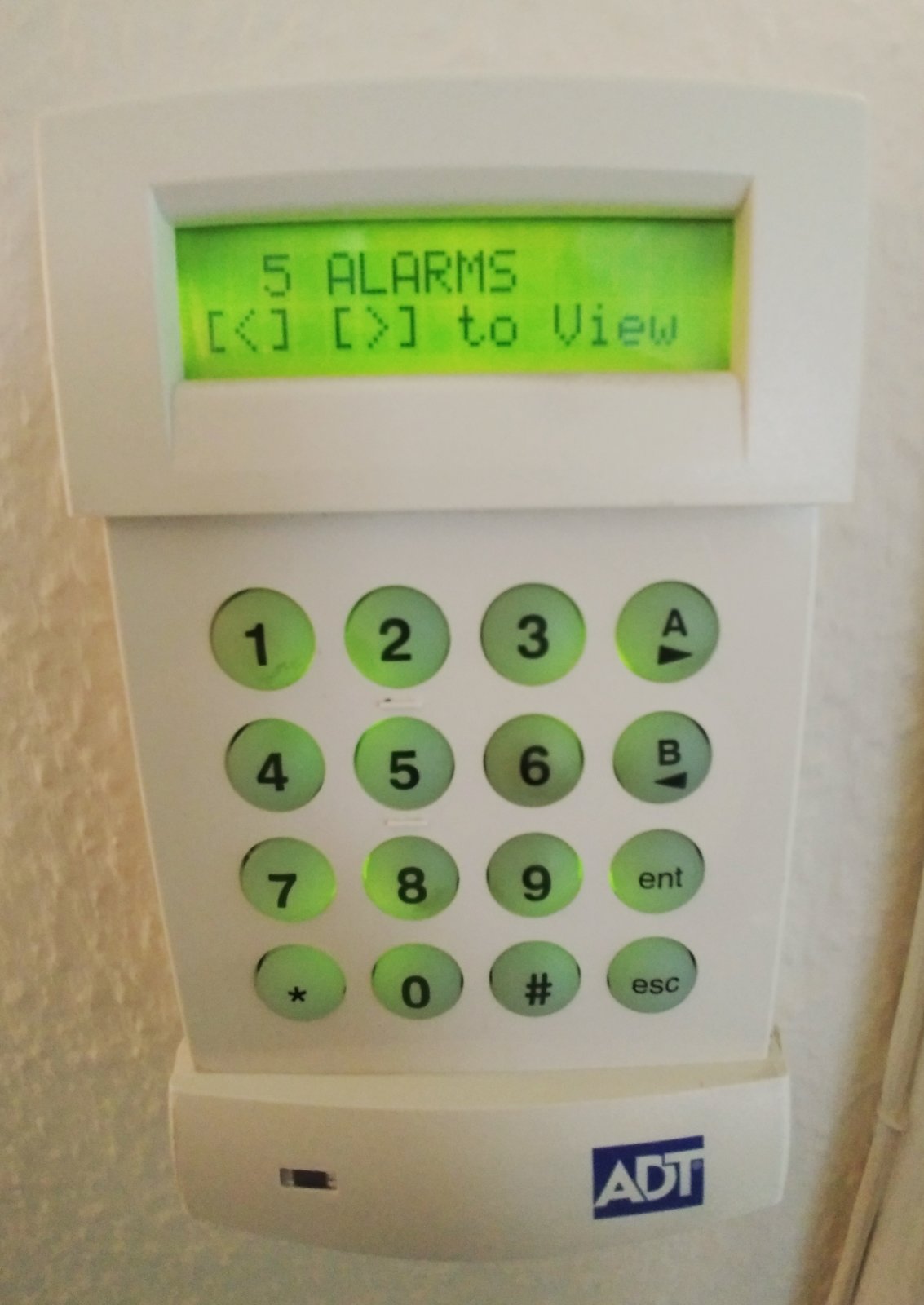

I then tried 1234ent and it said: 5 ALARMS [<] [>] TO VIEW

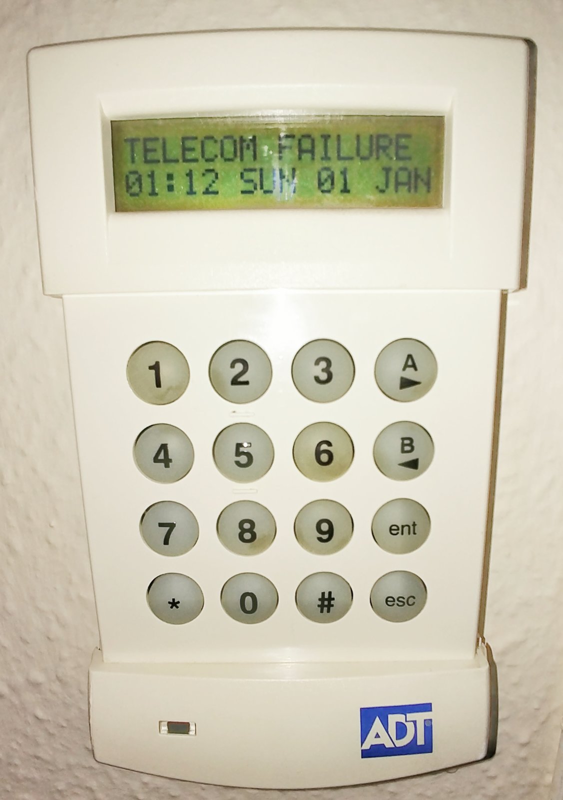

It then goes to TELECOM FAILURE

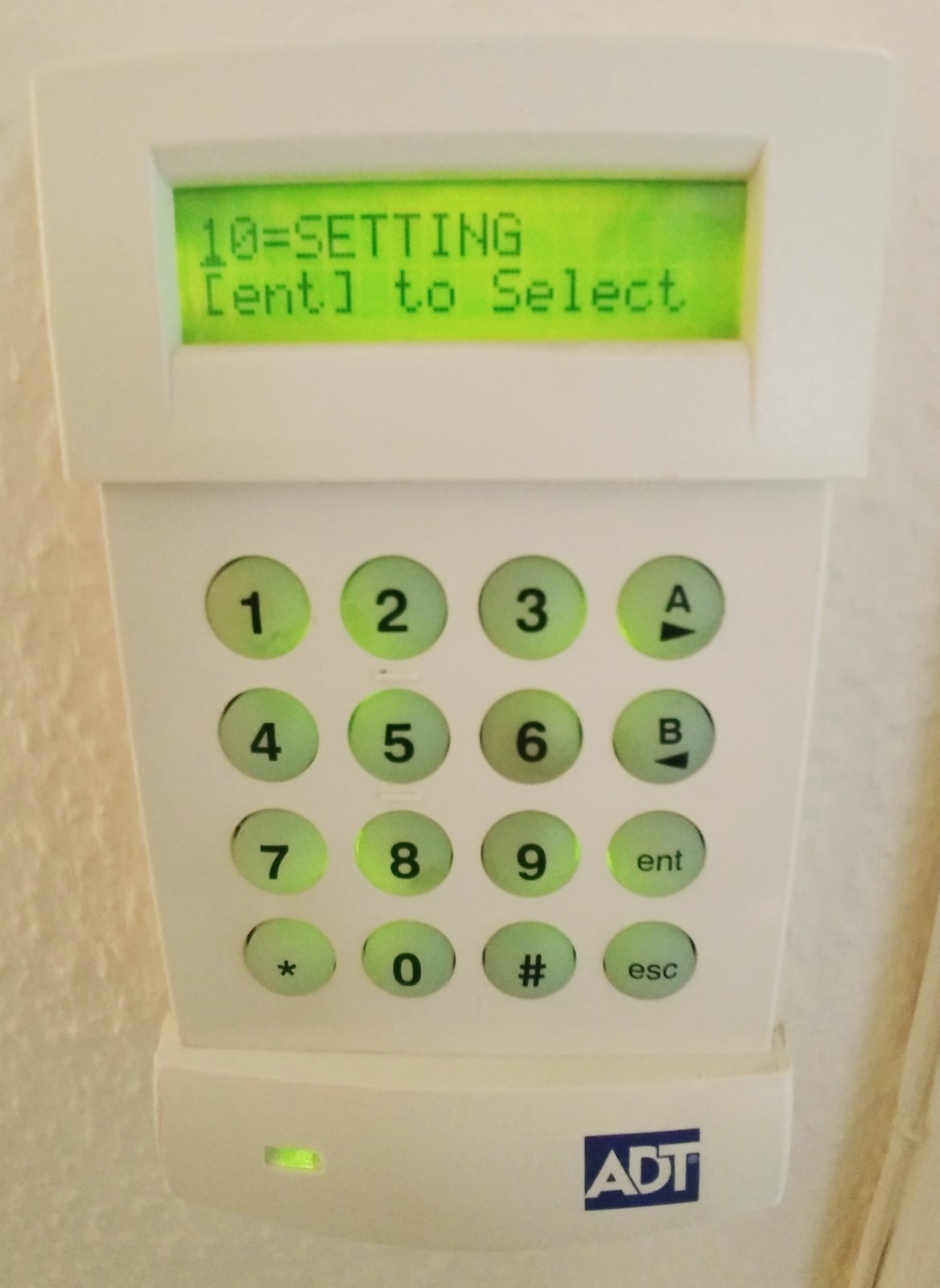

I then pressed 112233ent and comes up with 10=SETTING.
I'm presuming that this is where I can reprogram the whole panel?
Thanks a lot for all the help so far!! Finally getting somewhere!

You need to turn off the telephone line monitor
Option 56
Then option 10 line volts turn off
That should now stop the telecom fault

Thanks. That worked. It now says Engineer Mode.
112233 takes me to settings
I'm going to 20 = Display Zones ent
