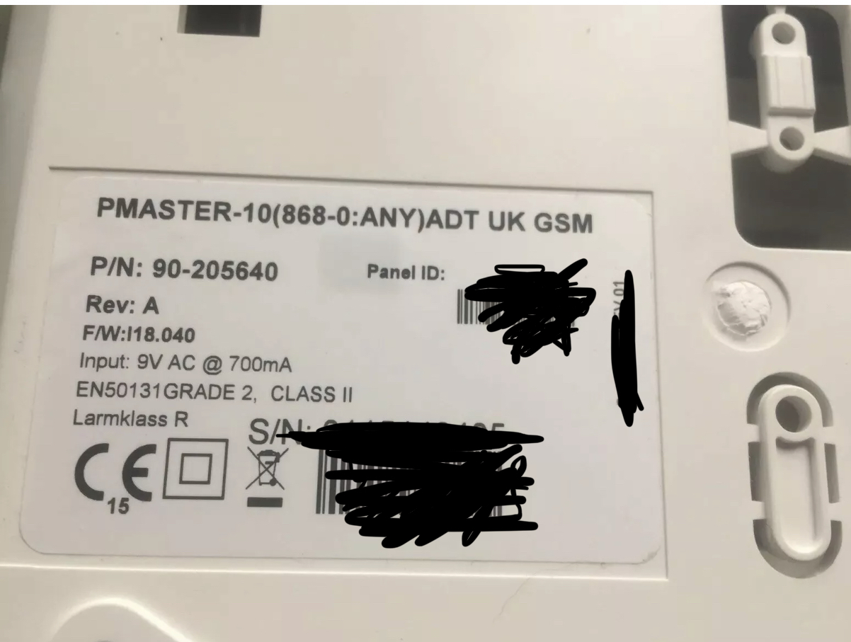

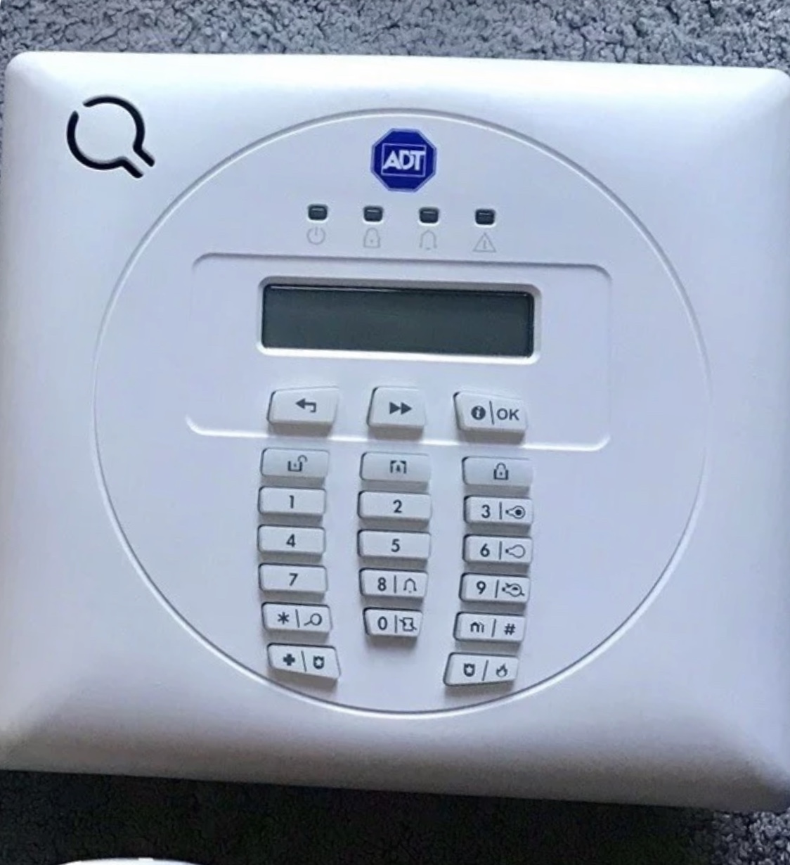

I have queries of my own in regards to ADT P10. See photos.
New place I moved into has the ADT P10 box fitted. It is made by Visonic who also make and sell a non ADT version of P10. The alarm system is still working without the ADT subscription.
I have been able to find manuals only for Visonic’s own P10 box online and wondering if the same installation instructions would work for the ADT even though both boxes look physically different on the outside.
I’m guessing ADT had a custom version of the Visonic P10 made for themselves. Possibly a custom firmware too as I have read Visonic ADT boxes only work with accessories supplied by ADT and not regular Visonic ones.
My second query is to know if their a way to reset the box so that it goes back to factory codes & ideally a straight Visonic box.
I want to do this so that firstly I can reset installer code and secondly make the box open to working with standard Visonic accessories.
Any advice would be appreciated.
