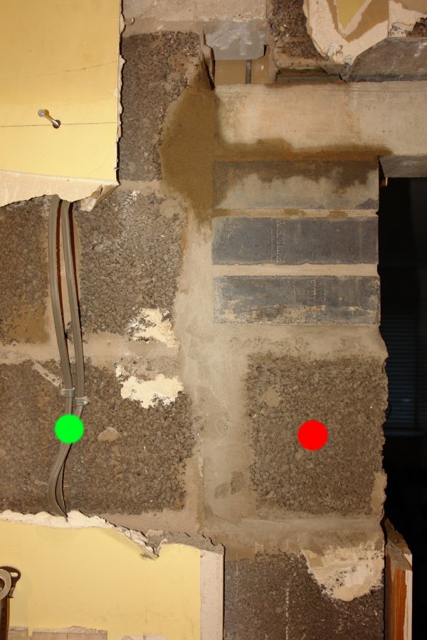

Ok, Lintel is beautifully level siting on thin bed of mortar, above gap keyed in 5 places with slate, slate was gently hammered nice and tight. Everything looks great but something bothers me. I attached photo of left side, that brick with red, does this course of bricks look safe? All four of them are starting at same point creating long line of mortar, would you recommend to maybe tie this red brick with one next to it (green)? Maybe I am paranoid a bit. but just want to do top job here, this is my house :) Thanks.
yeah you should see some of the things we all find holding up lintels
thanks a lot, I wish I knew some good builder, would not have to bother you all the time!

Dont forget to get building control organised before covering it up,
Neat job thou.
