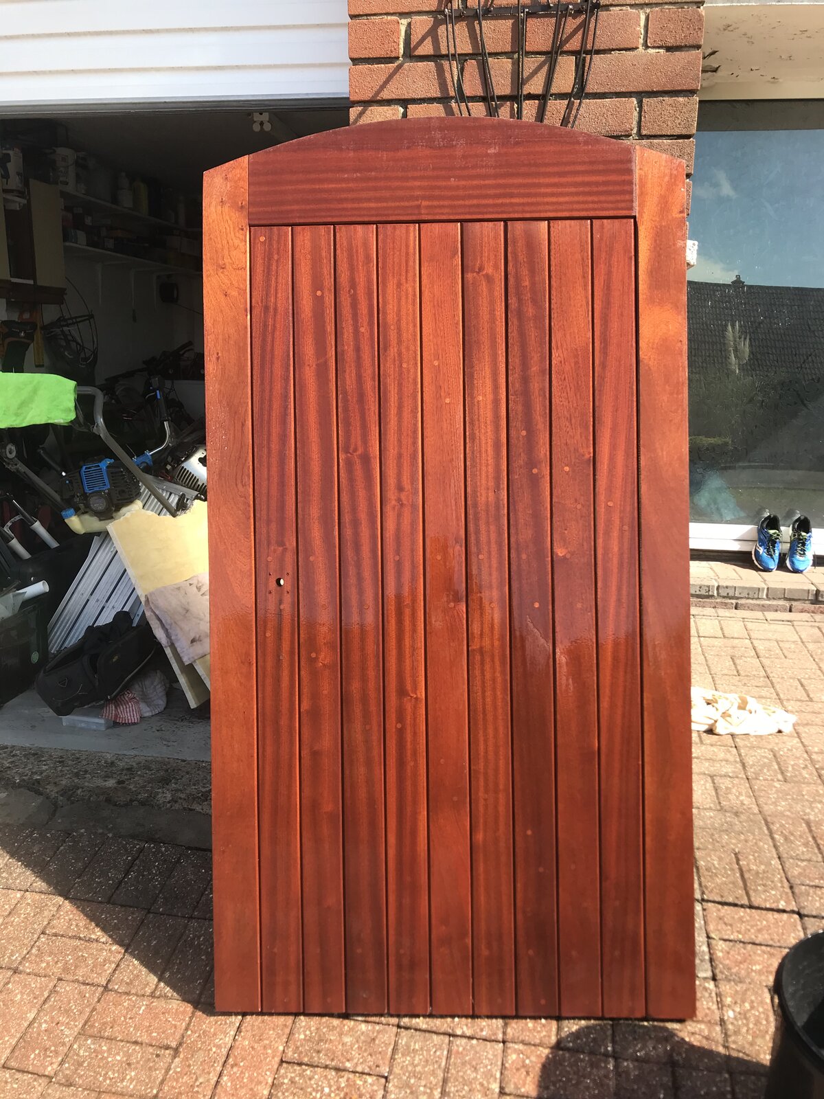

Just gave it a wash down and I LOVE the wet/semi gloss look!
I know it’s been painted with Sikkens Mahogany Filter 7 but it’s satin.
Anything else I can use to give it a slight sheen or should I stick with Satin?
