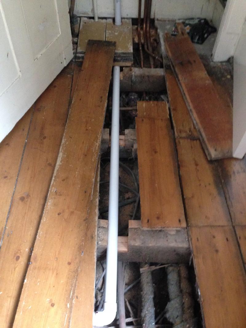

Had a new condenser boiler and radiators fitted last week. Due to location of the boiler the drain pipe gave them a small problem which they said they quickly worked out a solution.
We live in a ground floor flat and they told me that it would be connected to the main waste from the bathroom.
I was in the coal hatch last night (as you do) and noticed some damp under the bathroom so a crawled to investigate. What they have done is connect to boiler drain pipes to the old cold water tank overflow pipe, seems they caused a leak in an old elbow pvc elbow joint no doubt by connecting the new pipes up to it but this is not my main concern.
Main problem is the actual length of the boiler drain pipes, it runs approximately 15.5 meters under the floor boards with about five 90 deg bends where it eventually then runs to my front garden. Its almost impossible to get it all running down to get gravity to drain water and you can see low and high points in the 15 meters of drain pipe when under the floor which means water must be static in certain areas.
Also been reading up and the ph of the waste water is around 3-6 and not good to have running onto my mortar or general garden.
Should I contact the boiler company or is this the norm?
Please see pics, new pipe is white, then goes to the old grey pipe. White pipe passes main toilet drain pipe in one pic.

It appears to be dripping onto the ground directly outside your house. The condensate is acidic and will eat through concrete, including wall mortar and concrete foundations.
It should have been run to a drain, such as a kitchen or bathroom waste.
If there is no gravity flow because the boiler is too low, it should have a condensate pump to lift it.

So a condensate pump would get the drain water flowing but it will still just dump in my front garden. Isn't almost 16 meters of drain pipe way to excessive.
I meant, connect it to bathroom or kitchen waste pipe. If it does not have enough height, add a pump so it flows to the waste.
get hold of the Manufacturers Instructions for the installation of your new boiler (which the installers are obliged to follow) and I expect it will specify how the condensate is to be drained, and that what they have done does not comply. That makes it an open-and-shut case.
Checked the boiler installation instructions and as you can imagine does not recommend anything like what I have ended up with.
just as I thought. The installer has an obligation to comply with the Manufacturer's Instructions so you have a right to demand that they correct their defective work.

It is possible to terminate like that if the condensate has been neutralised first.
Having said that the internal run with little if any fall is not good.

It looks like he could've connected to the adjacent soil pipe perhaps?
Also, it looks like the 'checks' that have been cut out of the 5x2 joists are huge!! I'm sure that'll weaken them structurally.

Thought when I saw the huge holes cut in the 5x2 that its not the done thing, more issues to raise with them.

I'd also be concerned as the amount of wood missing from each joist notch, that's effectively halved it's strength.
