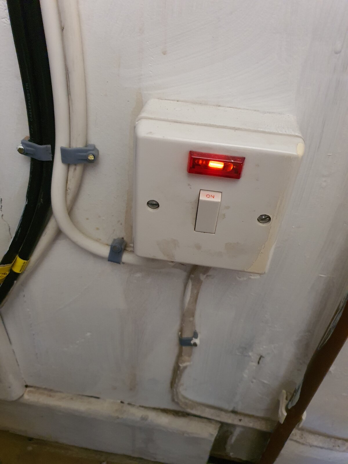

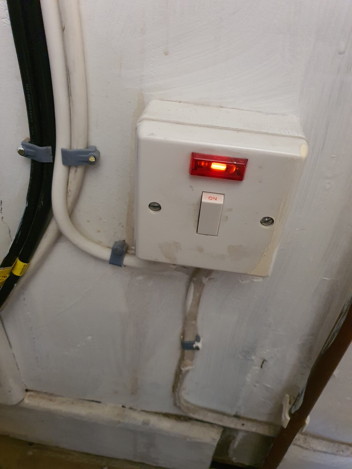

I collected the pump today. I noticed there are two wiring connections, one with 2 cores and one with 3. If I wanted to connect directly into the electrics via the switch on the wall, would I use 2 or 3 core?
The Conlift comes with a nice instruction booklet with wiring diagram(s).
The acronym RTFM sometimes applies.
OK, then, use the three core only unless you know what you're doing. The two core is used to interrupt the boiler switched live to guard against condensate spill in the event of a pump malfunction.
