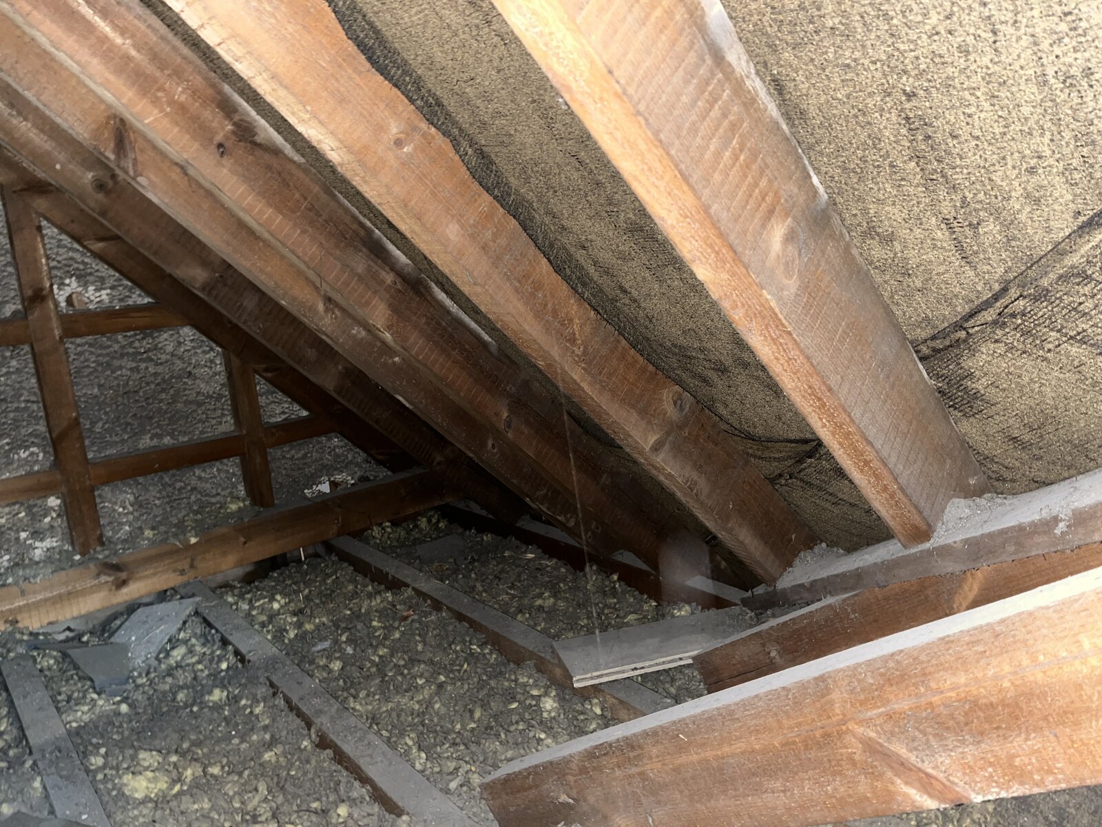

Would you say that I should push for jacks on the top windows too?
Unless that cantilevered roof is supported on a beefy cantilevered joist each side or some other way then yes. Have they been in the loft to check?
Unless that cantilevered roof is supported on a beefy cantilevered joist each side then yes. Have they been in the loft to check?
Nope, they never went into the roof to check at all.
My worry is they are just trying to bodge it best they can as they really don't want to remove all the frames.
Perhaps put them on the spot. Just say you are not totally happy with their statement that the top bay is non-structural and doesn't require jacks, but you will accept it if they confirm in writing that the top bay is not load bearing and jacks are not required.
If they are sure, they shouldn't have any hesitation in stating that. If they are unsure, and trying to fob you off, they will resist putting it in writing. I think you'll know by their response what to do next.
They are however adamant that the top window does not need window jacks and claim that it is not load bearing. They are intent on leaving the poles resting on the UPVC cills. Shall i push for Pole jacks on the top windows too?
I am unconvinced thats ok
In my opinion the baypoles create rigid connections between the brickwork and the rood structure
otherwise that brickwork is only connected at the top by fixings into upvc framework which is flexible
think about what happens when you get 60 mph winds on the face of that window -they will want to flex. If the bay poles are there, they are kind of indpendent to the windows as they are rigid poles between brickwork and timber roof.
Think of wind, that roof will be subject to wind lift so hopefully the timbers inside are strapped in well

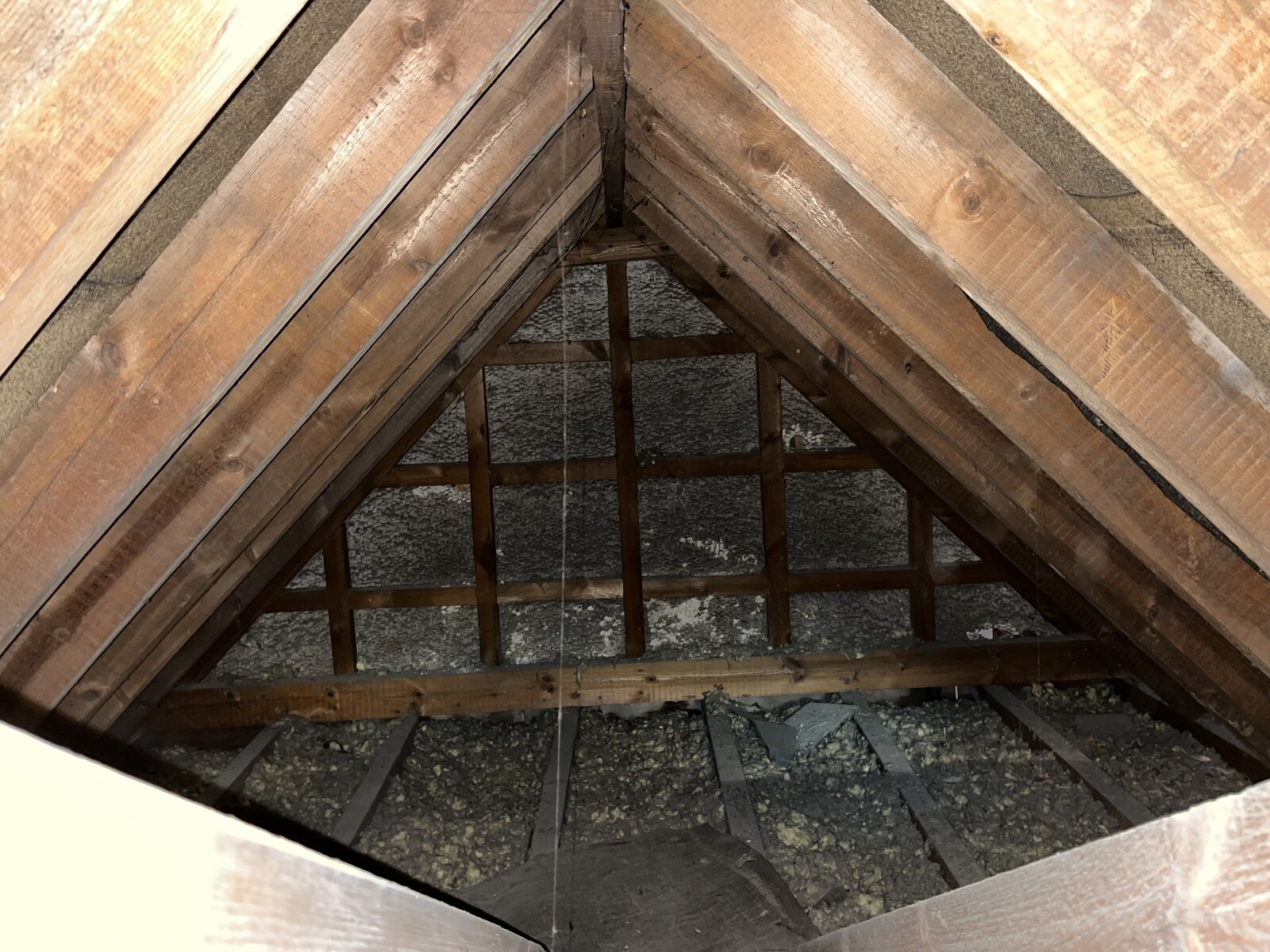

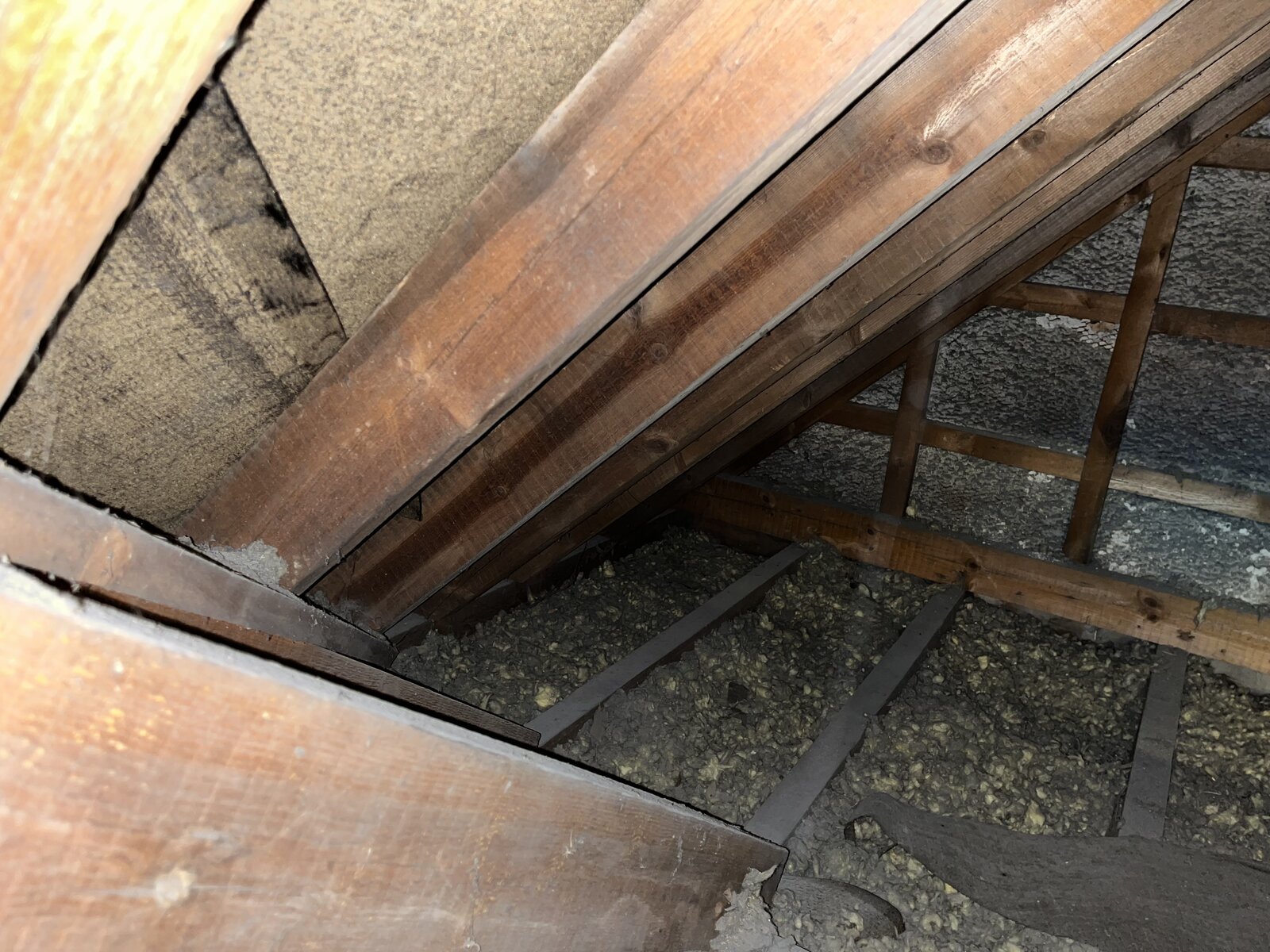

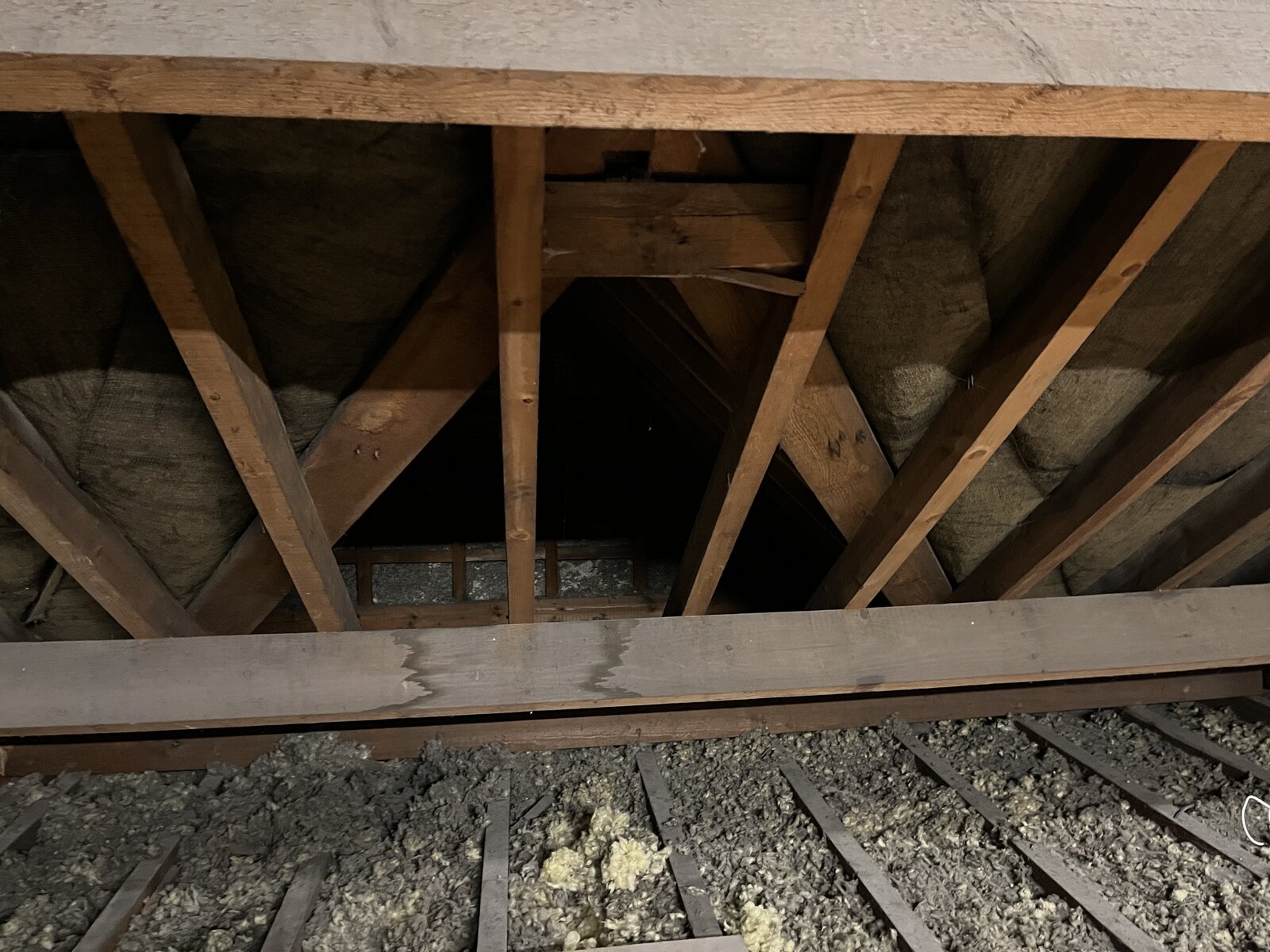

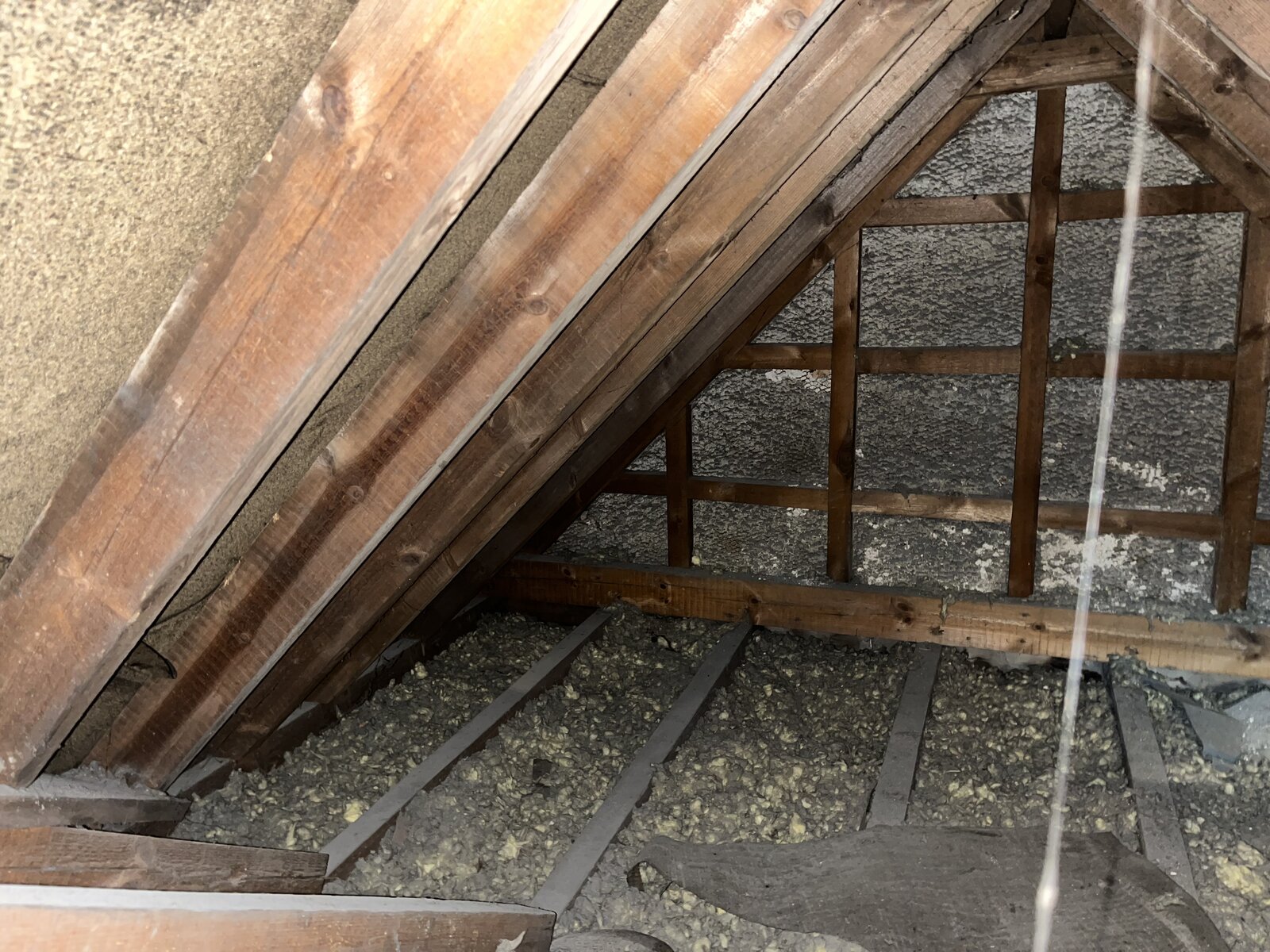

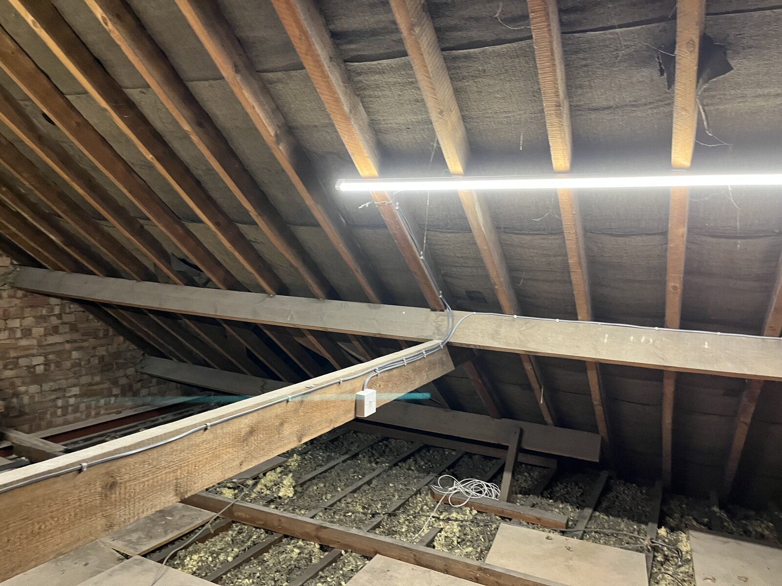

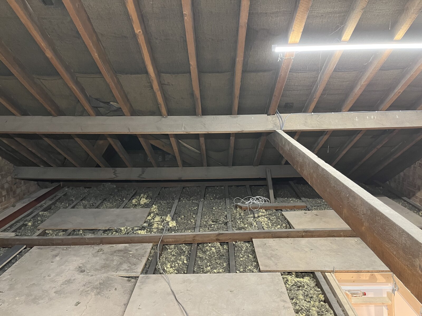

I have attached some pictures of the loft. Can someone with more experience than me advise?

Thank you! I have attached some pictures of my loft in the thread above as well.

So the windows are currently fitted. The bottom bay's have the jacks and the top windows don't have the jacks.
Only issue now that i am getting them to rectify is that the frames against the walls are all bowed and our of square! they have ordered replacement frames.
Personally I see no evidence of any cantilevered support for that roof. However, looking at the frames, as there are so many jambs I think you'll get away with it - fingers crossed!
