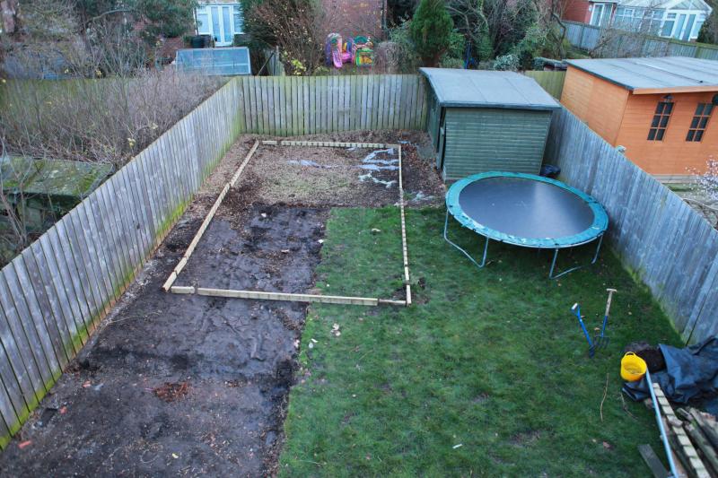

So here is the plot where the garage is going to go
Cleared the decking and roughed out a garage shape with where i would ideally have it (under 1 metre from boundary)

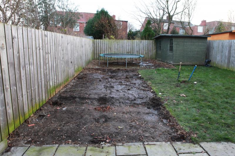

So heres a pic as it is

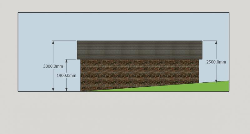

and a sketch of how id like it from the same view (although this is with it 1m from the boundary)
You may also be able to see from the pictures that the garden is on a slight slope up towards the back of the garden. At a guess id say id need to dig the back out 50cm to get the garden level, would this be a problem for water seeping into the garage from the neighbours gardens?

The 2.5m is measured from the highest poit of surrounding natural ground level. If you must excavate one part of the garden down by 50cm then you may build 2.5 m above that so from the base of your excavation to the top of the built building is 3m. If your heart is set on 3.5m you'll need to dig down another 50cm or apply for planning. Personally I would just put it in at 3m ridge and 1.9m eaves giving you a 26 degree pitch, and use the sides for storage, workbench etc so you dont need a large room height there. Or I'd dig down the extra 50cm and put a long shallow sloping driveway in, provided you have a drain available to take the rain runoff.. If your drains aren't deep enough you need to rethink that part

I did wonder what the deal is with height after digging down and when i read up i got the impression that it was measured from the immediate surrounding area. So for example if i was to do a 3m height overall and dig down 50cm at the rear i could get an extra 50cm height by digging, however at the front id still be measuring 3m which would be over the 2.5m allowed? or am i wrong in thinking this and the height is measured from the highest point around the build?
a little drawing for reference
Also i wasnt set on a 3.5m overall height i just figured it looked nicer and wasnt sure what the minimum pitch would be to have tiles as a very low pitch might not work with tiles? i like the idea of what you said with a 3m overall height if i can get away with it and the pitch is sufficient?
Highest natural point. Natural is not defined and assumes a common sense definition that may be lacking in some council edicts
Minimum pitch depends on overlap, tile design, exposure and so on, but can be as low as 12.5 degrees
