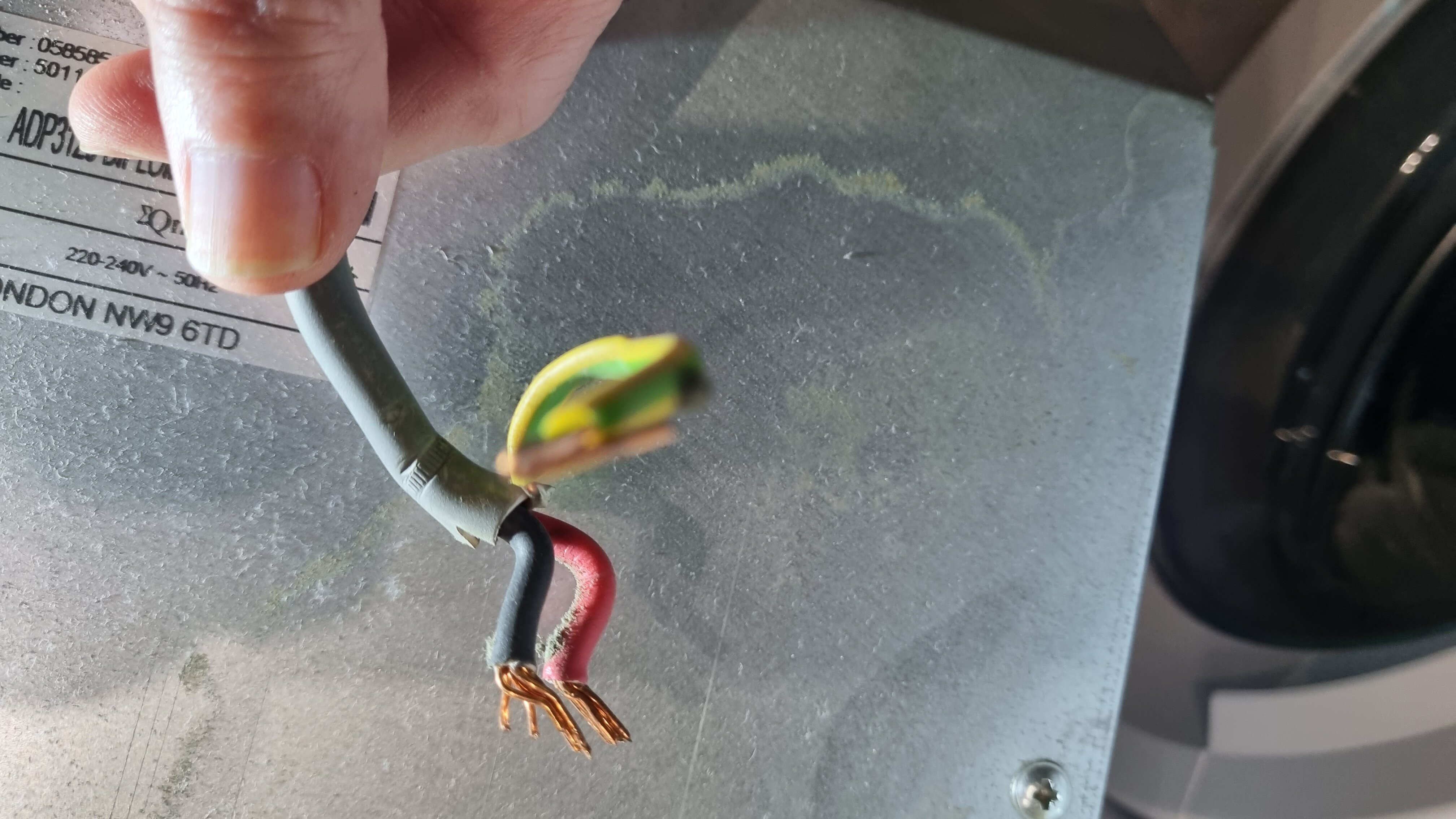

So, I'm looking to purchase a 2-gang socket to replace the cooker socket shown in my earlier photo. I'm a little concerned about the size of the 6mm wires that will be feeding the socket. The following photo shows the cable end that was removed from the old oven and the oven circuit cable is the same size.
I haven't opened up the cooker socket yet, but I really hope there is only ONE 6mm supply cable. Are cooker circuits normally wired in radial?
Looking on Screwfix, many sockets specify 3 x 2.5mm or 2 x 4mm cables, but don't mention 6mm, although given this is less than 2 x 4mm, a single 6mm wire should fit in the terminals.
Can anyone recommend a particular brand of socket? Is it best to use a socket with a "plate" in the terminal connection, rather than just relying on the screw to hold the wire, especially when the wire is made of multiple strands?
Cooker circuits usually have a single endpoint. Long as your double socket is a reputable brand (so avoid supercheap Chinesium offerings from online tat bazaars) you'll be fine.
