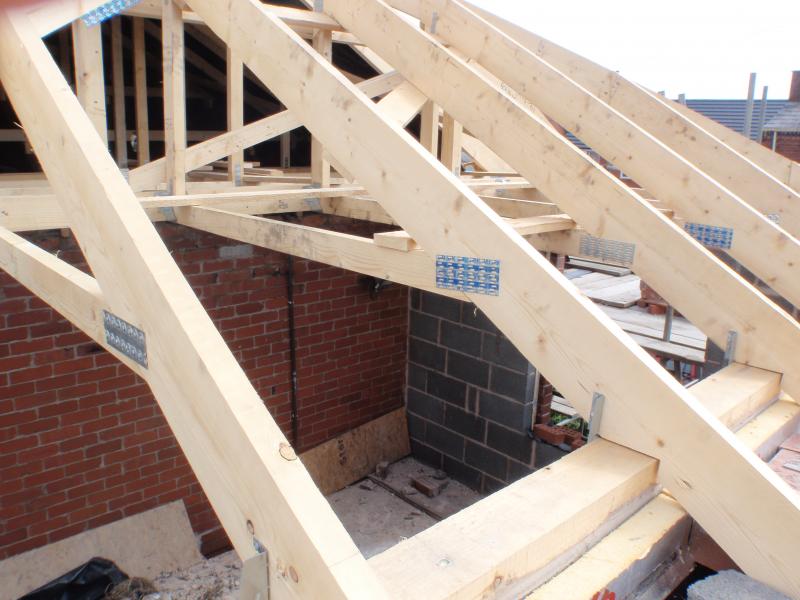

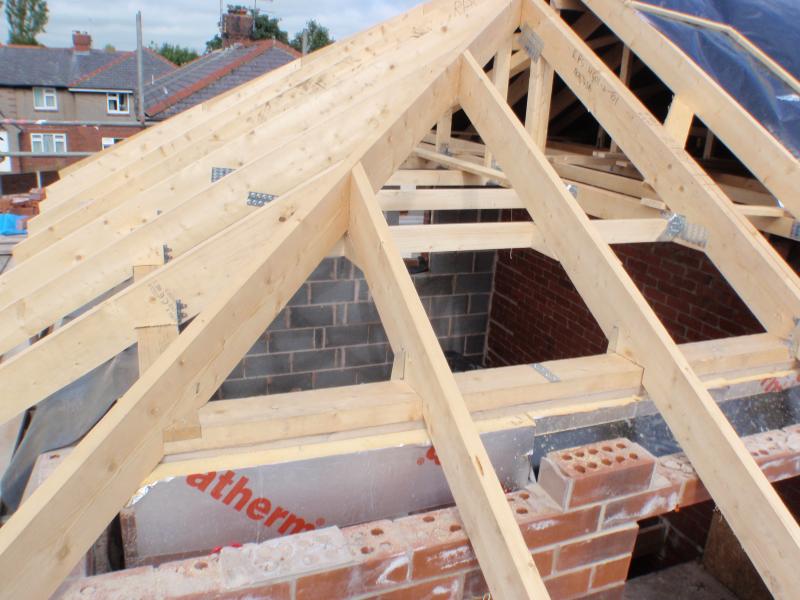

Photos attached:
View from front corner:
Angle showing how high ceiling joists are:

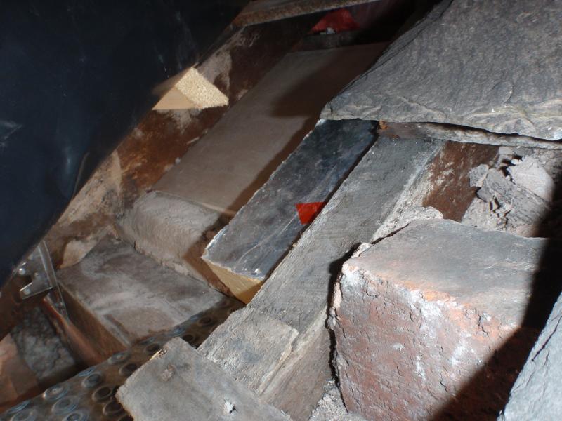

Inside existing roof - I've put a bit of 50mm celotex in against existing plasterboard slope to show depth we've got to play with.
The conflict we've got is: architect says seal the cavity at the head, put in 270mm Rockwool and use eaves ventilation system. Building control say don't seal cavity, put in your egg boxes and insulation and get your roof on (laid back). Since it is a raised tie roof we do not have 270mm of space where the ceiling slopes, just the 147mm depth of the rafter. From the reading we've done, if using breathable mebrane ventilation is not necessary but we can't have a 'well-sealed ceiling' since the old and new buildings share a loft and cavity is not sealed and damp as hell in the existing.
OK, so in new roof, the rafters are 147mm deep so we could put 100mm celotex in between rafters at the slope leaving ventilation gap. Do we "birdsmouth" the insulation so it 'wraps round' the wall plate and butts up to wall insulation then tape it as per wall insulation? To meet BR it would need to be 200mm though!! We could then put rockwool type stuff in remainder of ceiling even though there wouldn't be much space above it when there is 270mm in!! The Celotex alone would be ££££££££££. Oldun suggested insulated plasterboard on ceiling slopes inside but we were thinking maybe 35mm Celotex then foil backed plasterboard, just cos it might be easier to handle.
Do BC just let you get away with a bit in raised tie roofs as they seem to be problematic? He doesn't seem too concerned, which would be fine except we've had 12 years of mildew on bedroom ceilings so we want it right.
Any recommendations for eaves ventilation system? How do you stop Rockwool closing the ventilation gap? Is this the "egg boxes" that BC officer was talking about? What about eaves trays?
My husband is concerned about condensation in the loft. If it has at least 10mm ventilation at the eaves and 5mm at the ridge, plus breathable membrane, should we be concerned? Do we need to close the cavity to reduce chance of condensation? Can we use DPC under the last course of brick that needs to go on? - we would run it from above insulation and wall plate to under last brick course so it acts as a run-off, or does eaves tray do this?
What about the existing roof? We are thinking 50mm celotex in there since rafters are not as deep or will that not be good enough to prevent cold spots?

New extension - 100mm celotex friction fitted between rafters and continuing to wall insulation, all sealed with foil tape and gaps filled with expanding foam.
BCO has looked at all our wall and roof insulation has agreed to let us use 25mm under rafters instead of 40mm since it's so well fitted it will probably exceed published U-values :D
When the existing roof is stripped this week we are going to fit 50mm celotex between the 75mm rafters in the old roof and also run some down into the cavity, compressing the cavity wall insulation that's already in (some has been blown out/dropped during building work).
We've been running the celotex up quite high between the rafters so that it is 270mm above ceiling height and trimming the back of the top edge of insulation vertical to act as a 'retainer' for the rockwool-type loft insulation we will fill the loft with when the roof is on. This will hopefully stop our 25mm ventilation gap getting blocked by rockwool.
We are going for a breather membrane suitable for cold, non-ventilated roofs although still ventilating it - we just want to be careful to avoid condensation since this is the first time our roof will be felted.
