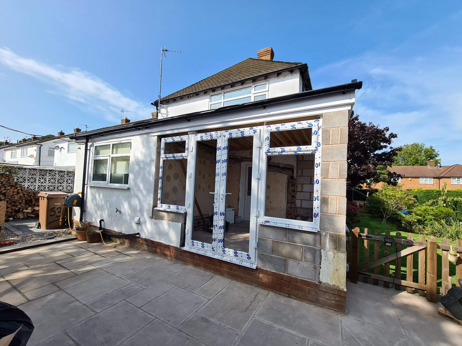

Advice on insulation under new flat rubber roof please :) pics added

Spoke to roofer, he said they didn't used 6x2 as trying to keep weight down as most of the wall is windows and will be using noggins to secure the current joists to together
In 38 years of building control I have to say that is the most stupid ridiculous thing I have heard to date!!!
Hmmm yeah I am not convinced. he said he has done this a few times, and on garages with same timber etc and they are fine. He guarantees his work and will come back if any issues occur
Think my best is to ask him to add some large joists like 145x45 next to some of the existing ones and use these large ones to fit my plasterboard to when i do the ceiling? i could add a 145x45 every 2nd joist approx and could use this to fit 1.2 x 900 plastboards is that makes sense?
The plasterboard will sag it needs doing on every joist.
very true didnt think of that

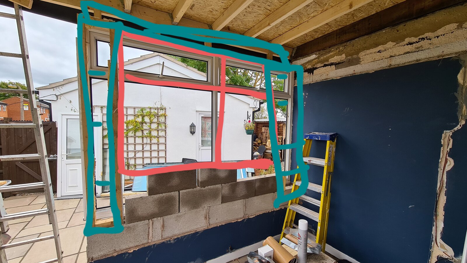

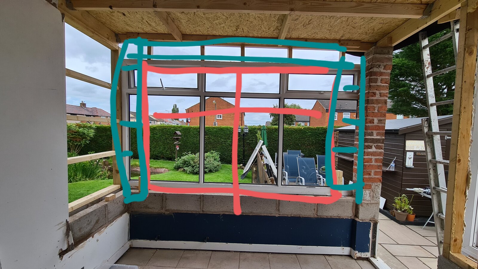

Could i re jig and buy a window and frame up each side to give some more support to the roof?
Some basic pics to show windows and some frame work?

Re your post the extra windows etc isn't going to stop the centre of the roof sagging.

I've stopped them working now and asked them not to continue - had to argue a fair bit with them, promised to rectify it but I'm not having it id rather find some one else. Promised some money back over the next 3 weeks.
They had 3.2k and i requested 1.5k back which i think is fair so he's kept 1.8k - he still thinks 1.5k is too much to give back when i really need to start all over again! He said hes paid the lads to do it and they refuse to give him the labour money back for the poor work hes at bigger loss. Personally though i dont believe that's my issue now as hes paid the lads for the job under his company name and that is an issue for him to resolve.
Will have to see if i get any cash back in the coming week like he promised. he was persistent on finishing it off himself and not using the same lads so he wasnt not walking away and giving some money back. i just want t cut ties now the trusts gone now and get some cash back to resolve it.
He brought a conservatory expert round who said its an easy fix, acro it up, nock brick pier down, use timber to support it in the corner rather than brick, then use timber 'wall plates' on top of the windows to support it all. and he said the current joists are no problem it wont cause an issue. I wasnt convinced thats a proper fix from comments here and on other forums.

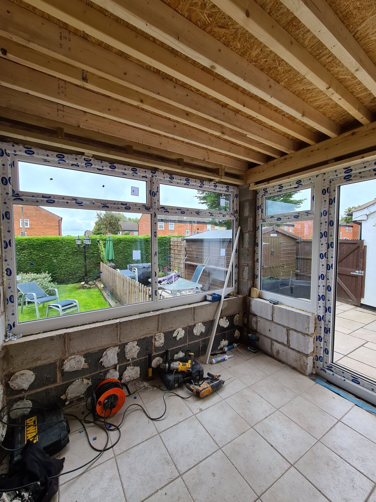

Update guys
Got the money back of the fella and got someone else in and nearly glazed now.
They have built a pillar and tied in all the roof properly. They fitted 5x2 along side the old ones as it was alot of work to remove all the old joists as was all in situ
My question is whats by best solution wise now for cold roof insulation as alot more joists than needed so board is going to be a pain to cut and fit in. Am I best with a wool type insulation and leaving a good 50mm sir gap above it to roof and then just using foil back plaster board for a vapour barrier

or could use some wool type insulation and leave a gap, and throw up some insulating plasterboard on the ceiling
