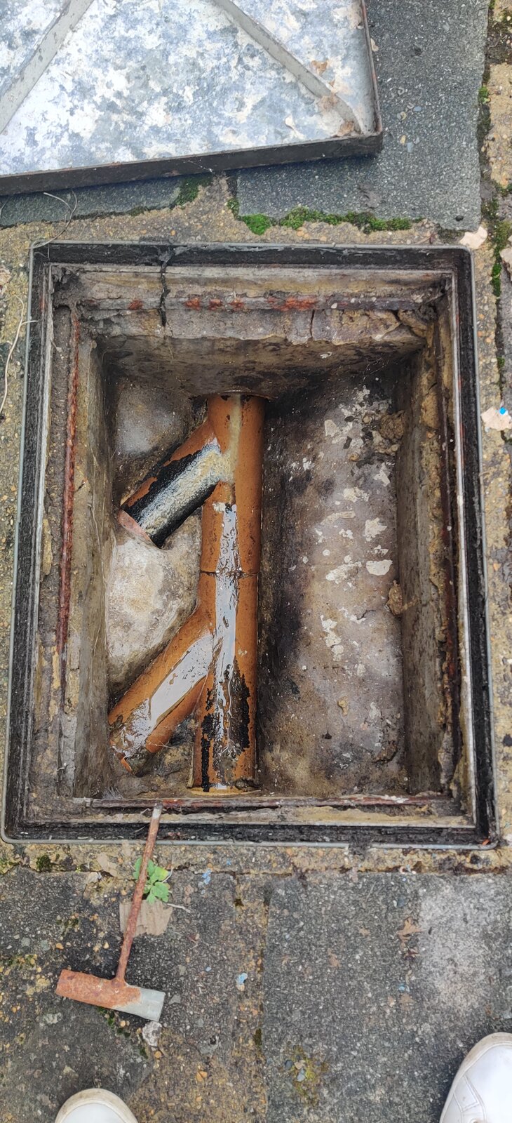

I have no idea how deep the drains are but my inspection chamber isn't that deep. I was able to get a tape measure down there so it's arms length. Here's a pic of my IC, but it's running away from where the maps say there's a sewage pipe in the back gardens. That's why I thought that slab was weird and wanted to know if it was a covered IC

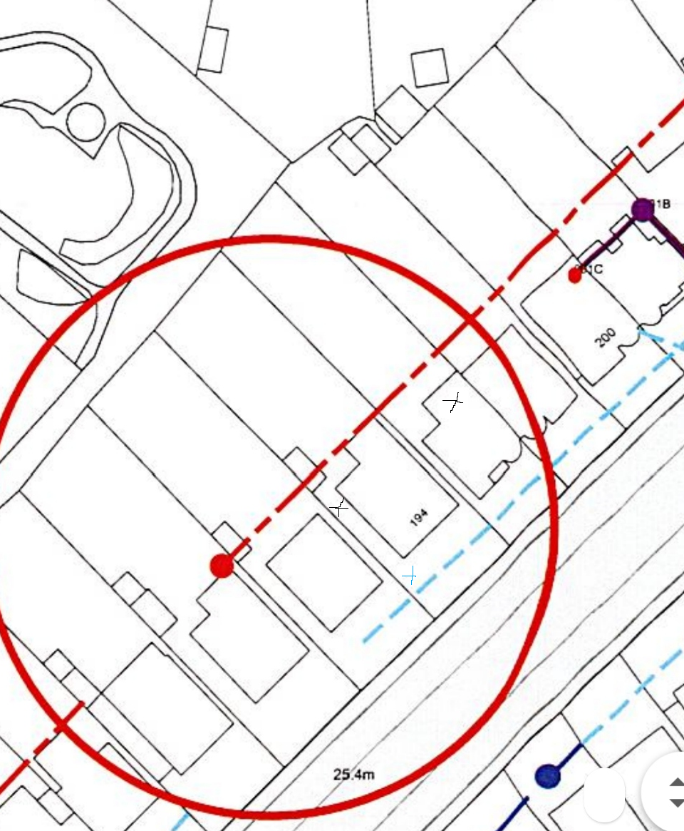

Just to add to this here is a Thames Water map. The red line indicates there is foul sewer pipe running in the back gardens touching my property. yet where I have added a 'x' is where my Inspection chamber I posted pic above is which runs to the front of the property not to the rear. The 'x' on the right hand is my neighbours in their conservatory - they were reluctant to open it as it was under their rug but I saw it there. I have added a blue 'x' on my property which is a manhole in front garden - which i believe is is not foul sewer I can't get it it open its a bit stuck.
So it seems both my waste and water go to front. I could get a CCTV but its not going to show me where that red line is and why I am not connected to it is beyond me. That's why I thought those slabs could be inspection chambers but actually its not in a line with me neighbour.
Does this make sense or am I confused? Apologies all.

It's possible that there is a sewer there, it passes through your garden but you don't use it.
As suggested above, it could be for rainwater only and you are using soakaways or are putting the rainwater down the sewer at the front.
Alternatively it may be that one is newer but both are still in use.
