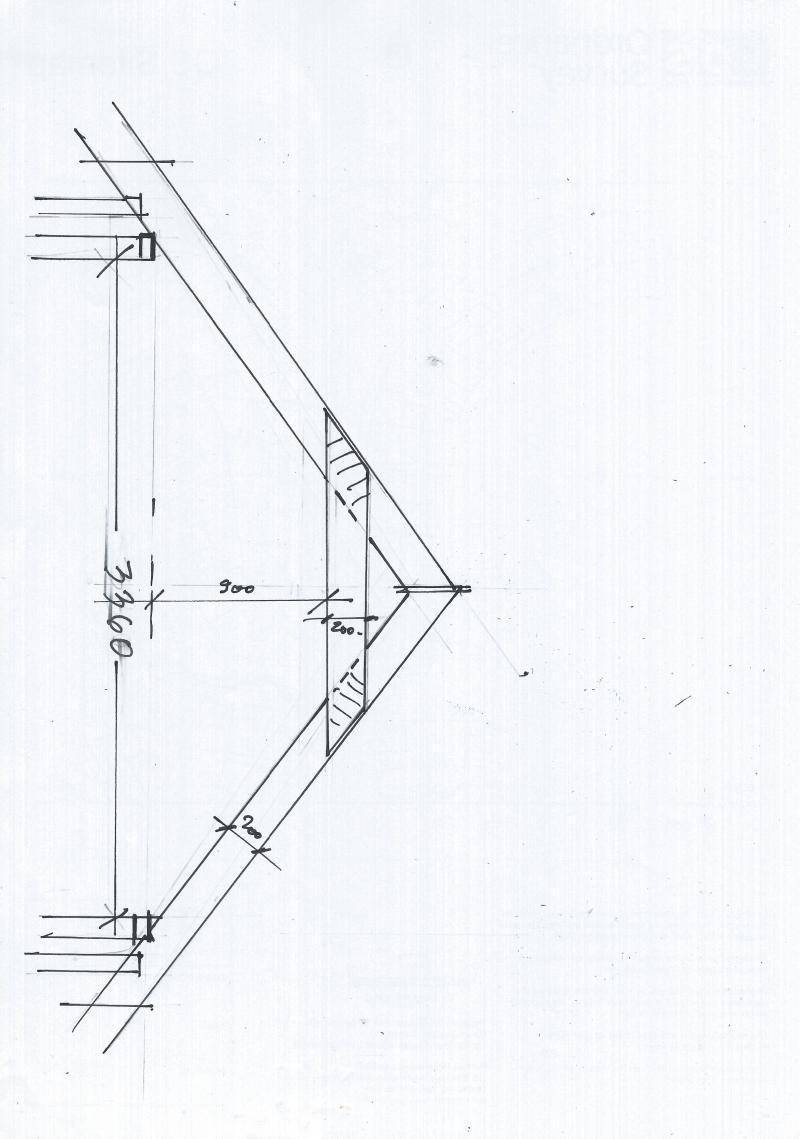

oldun, I have drawn a diagram of the rafter you recommended and uploaded it to my album on here (beam and rafters/rafter) I think this should clarify whether I understand what you are saying.
The only thing I am not sure of is “450 down all pairs of rafters” I have googled it but not come up with anything

Given all of the above am I right in thinking I can dispense with the ridge beam and just have a ridge board and 50x200 rafters at 600mm with collar ties on every rafter?

While I respect the views of Ronny and the old fella, I'm still not convinced you need a ridge beam as such.
If your rafters are 200 deep (and imo they coud be less), and you have a good strong fixing between the ceiling ties and rafters, you would not need a ridge beam, just a thin ridge board.
Just my humble opinion.
This is an instance where a glide shoe would be useful then; to take up the displacement as the rafters are loaded, and to prevent forces being transferred into the walls?
letterem; just seen your sketch. Unless you had much deeper ties (to get more and better fixings to the rafters) and/or moved them further down the slope, you may be better with a ridge beam after all.
Or.... After also veiwing your sketch, why not just use raise tie trusses ? Surely costs of materials, ridge beam would not be less than pre manufactured trusses?

Regards ridge beam, if you feel that a pair of commons with a collar two thirds down stood against a ridge board is almost akin to a truss, then by all means tell the OP that the way we would go about it is a load of old b*llocks. No skin of our nose, and we will take no offence, as we will still carry on doing it the way we were taught when we were a lad.

Well Emma the 450 the oldun is reffering too is builders band over your ridge beam and 450mm down each side of the rafters

Oldun; I certainly wouldn't say that what you've written is b******s; I admire your knowledge, style and directness. But we are all entitled to our opinions and there is always more than one way to skin a cat.
It's easy for everybody to get bogged down in debate and none of this helps the OP.
For what it's worth, I've attached my own scale sketch of how I would do this. 8x2 spars at 600; ties of 8x2 offcuts about 1/3 down from the ridge. We are losing sight of the fact that this is not a very big roof and so subject to relatively small loads.
I did some quick timber calcs, and under maximum load, the 8x2s would deflect no more than 1mm. If the OP firmly screwed/bolted the timbers in the shaded area the whole assembly would be very rigid and any theoretical outward spread of no practical importance. On this scale, no need for glide shoes either.
(You might have to turn your laptop on its side!)

The point is that no SE wants to put anything other than the most nominal horizontal forces into the top of a masonry wall, as masonry doesn't like bending and tends to crack...
Hence the reason most SEs will specify a ridge beam. It just looks like a nice alternative to a ridge beam to me, to allow for a bit of horizontal movement, without having to build the wall out of reinforced concrete! I think 5 or 6mm would not be unreasonable.
Tony, are you talking about the deflection in the member or the lateral displacement of the member at its base? I was expecting 5 or 6mm horizontal displacement, especially with the elongation of the tie.
