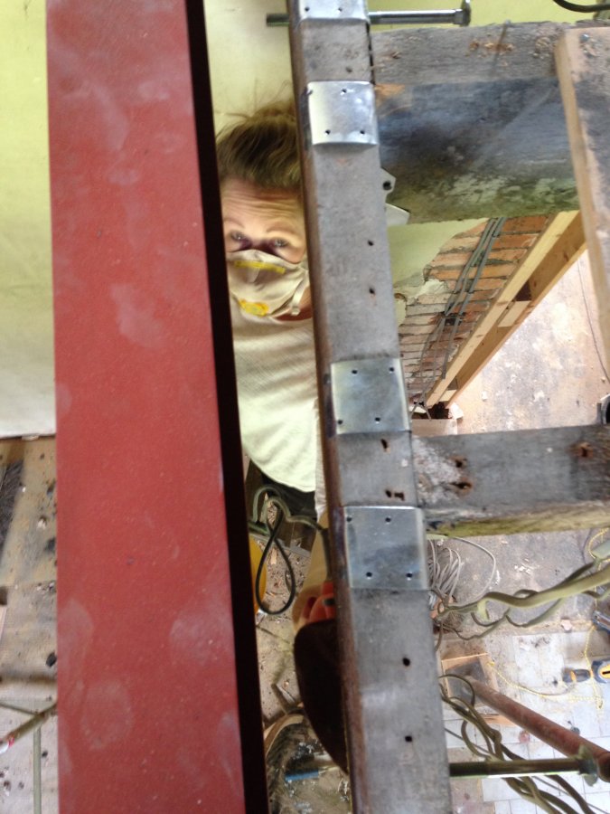

If your missus frets, just make her stand under it while you bolt it up ;)
ha ha nice , answering your previous question yes it will go into the first skin of the external wall but i was hoing to cut out the joists and insert wood and hang from that , your span is about the same as mine, how do you work out the loading on it ?
The online calculator.
I but in that it was supporting:
2.15mtrs of timber floor and plasterboard ceiling.
A 2.4mtr tall block wall.
A point load from a second RSJ in the loft.
A point load from a post under the purlin (which is only temporary but added it on anyway).
Then it gave me a list and I chose one closest to the size of my joists.
Although having said that, if I need an SE it was a waste of £30 for the online service. It's been in there fully loaded since June. Daft thing is, the wall we removed didn't quite touch the joists anyway!!!
