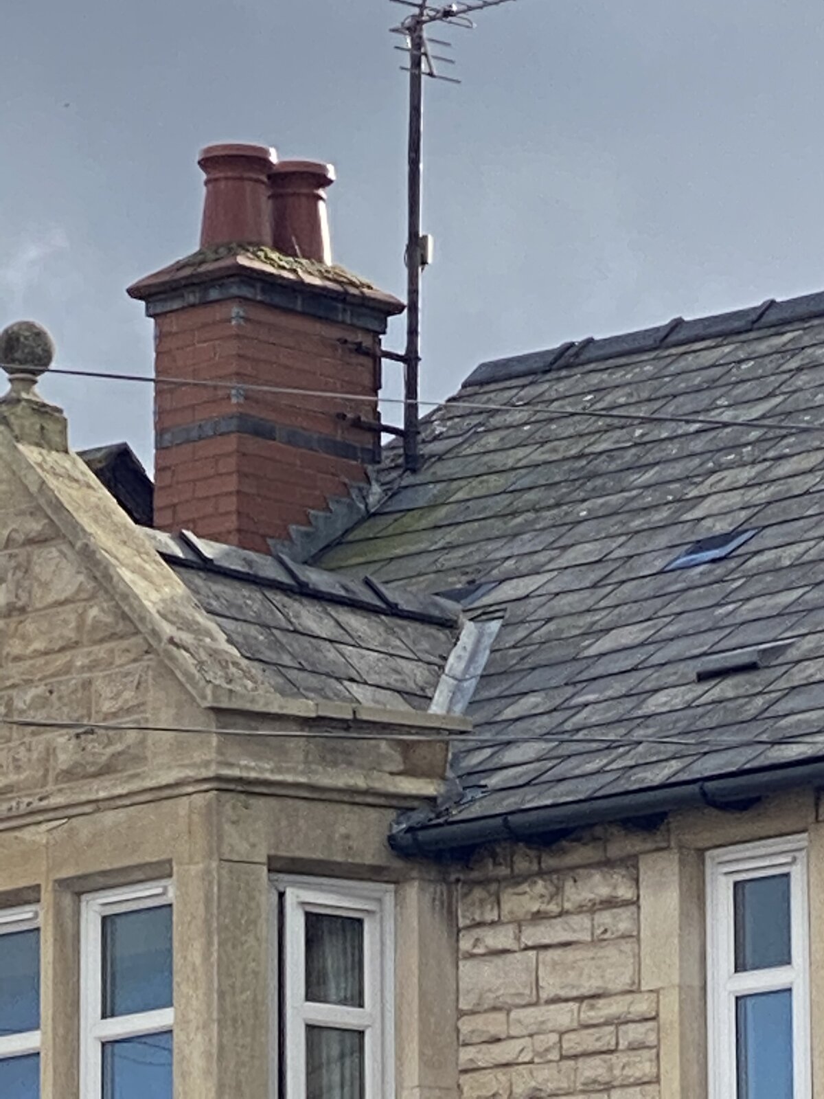

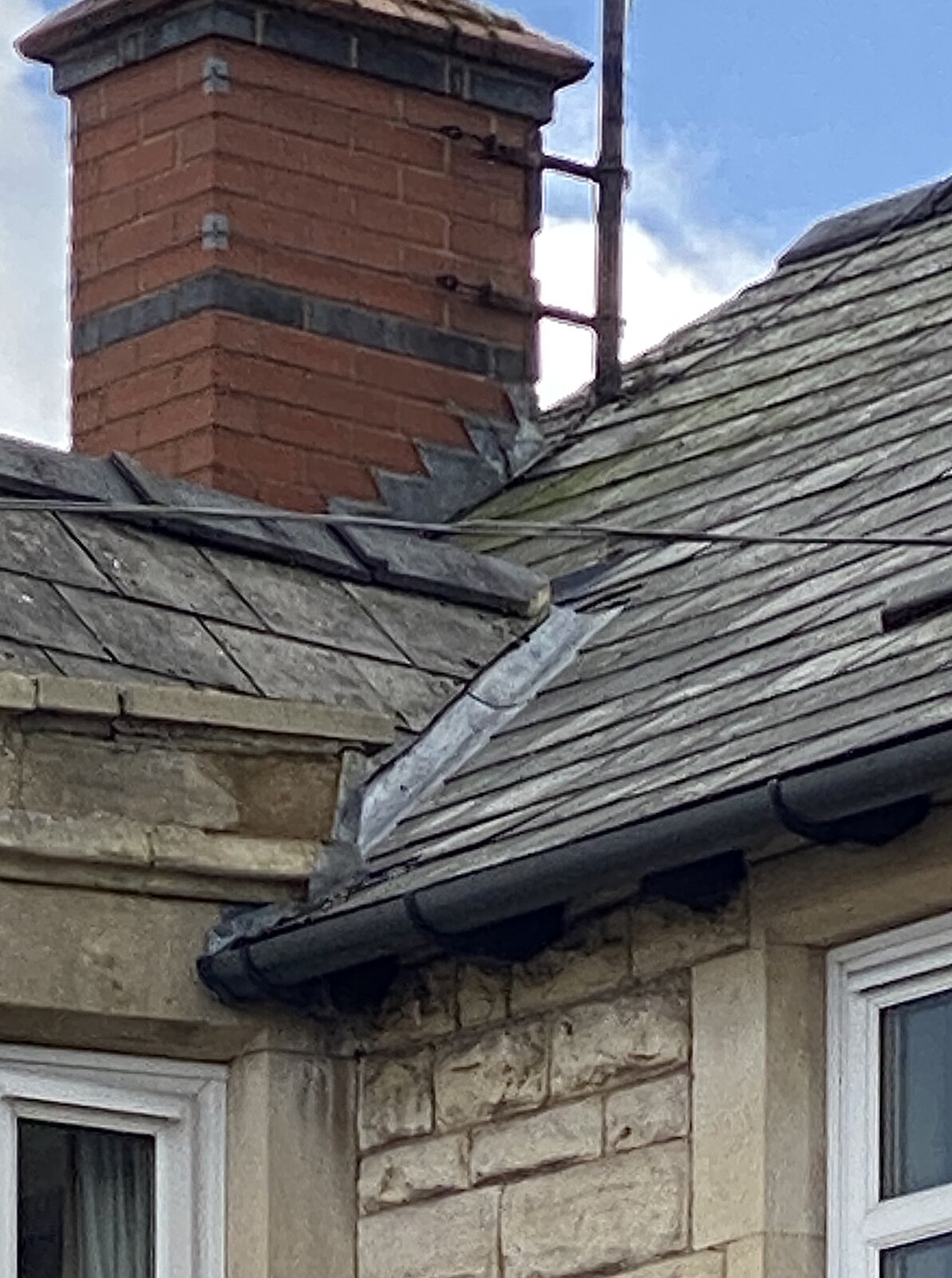

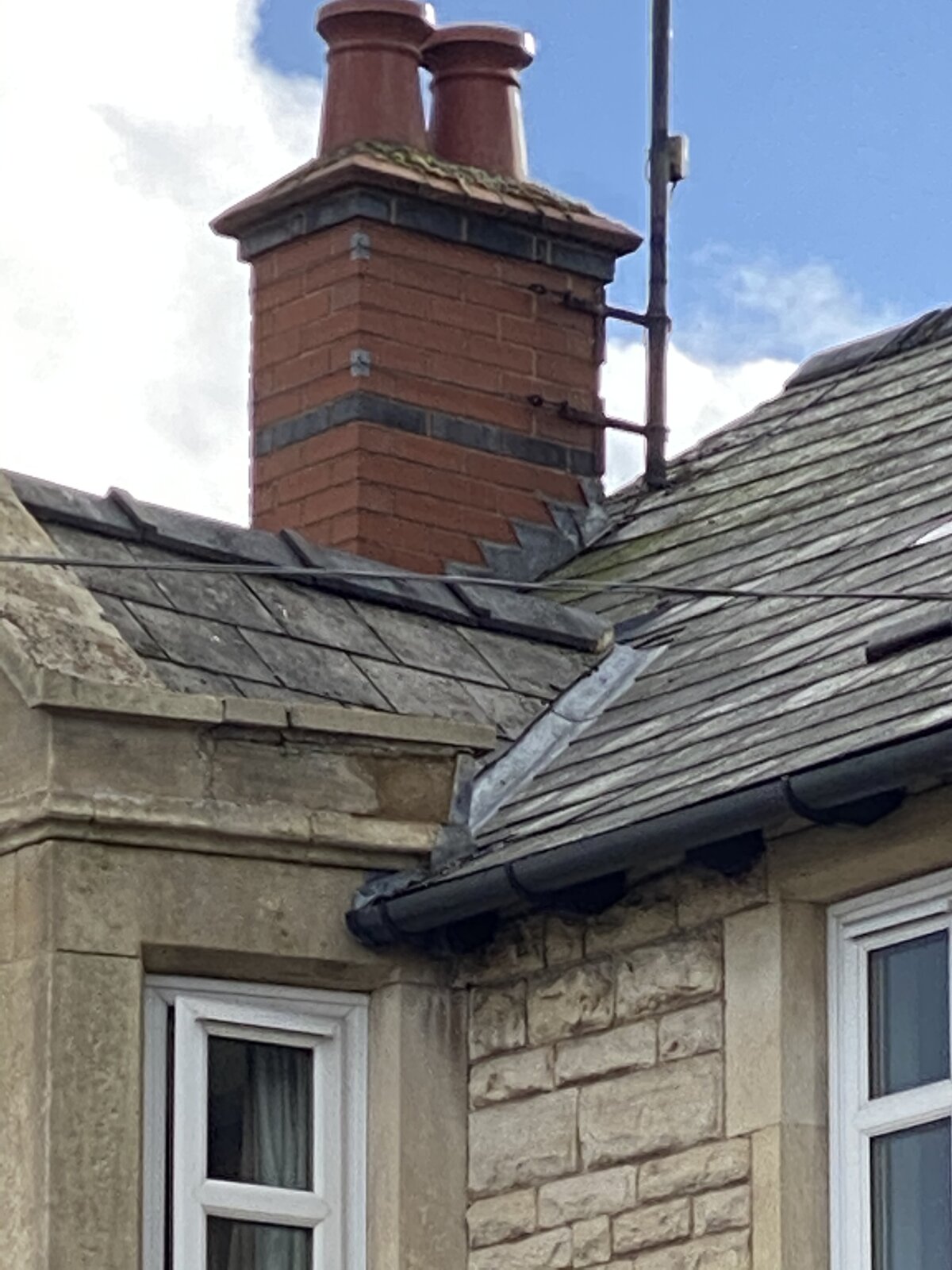

Took a couple of pictures with the camera zoom.
That valley doesn't great has it definately been replaced ?.
The ridge hasn't been off.
It needed to if you were replacing the valley lead.
Coping stones require work
Slate is actually asbestos slate
The fact it took a couple of hours is only relevant if they cut corners - the scaffolding costs probably the same as for 3 days - also not much different between 2h and 1 day as far as labour goes - unlikely they'd start another job on the same day as they'd have had to allow extra time in case of difficulties.

the job in the pics looks awkward to me -its got a ridge abutment to a pitch tiled roof, short stretch of valley and finishing with what looks like a parapet -lots of nasties to uncover.
