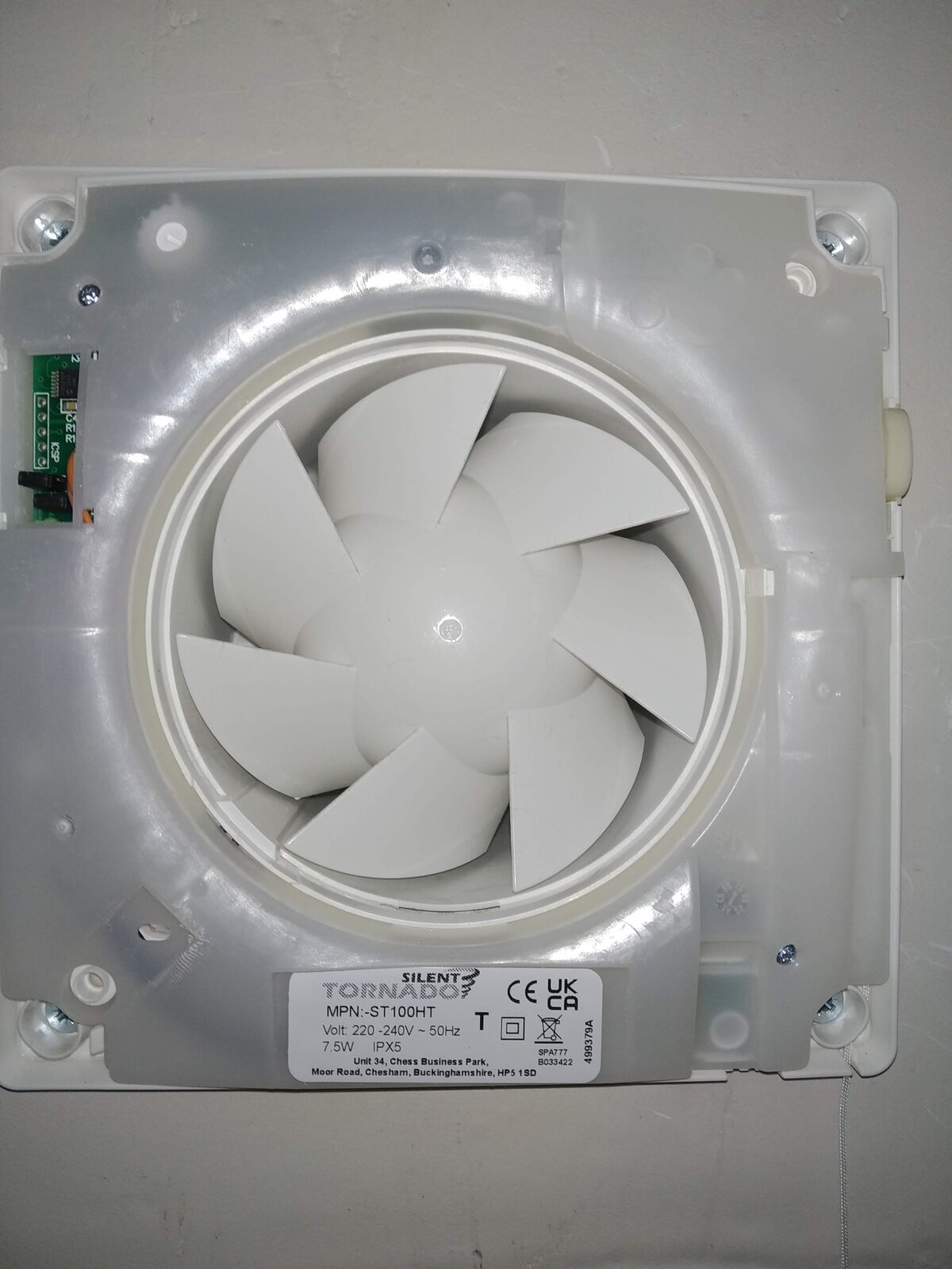

I had a Silent Tornado ST100HT put in on Friday evening by my electrician:
I specifically asked that the fan was not connected to my light switch - as such, the humidistat only comes on when humidity levels reach beyond the set level or you pull the cord (which sets the timer running for 20 minutes, regardless of humidity).
I did not touch the humidity level on the fan, so it was put it in at its default (and lowest) level of 60%.
Since then, the fan has run continuously.
According to this (point 6):
" It is also important to note that when a humidistat fan unit is first installed it can run continuously for a few days as it settles into the new environment."
I suspect that something is now wrong as it has been over three days, now.
It may well be that my bathroom is consistently over 60% and will therefore never turn off.
Is there a suggested way of getting humidistats to the best level? I was thinking of turning the humidistat to its maximum (90%) and perhaps turning the dial back a tiny bit each day until the fan comes off and on - which is going to be very tedious to get right.

Well there should definitely be two adjusters inside unless the wrong model has been fitted. A picture of the innards would confirm.
Yep - had a look and there is only a single dial for humidity only (top left of photo). Nothing for adjusting timer, which is odd.
