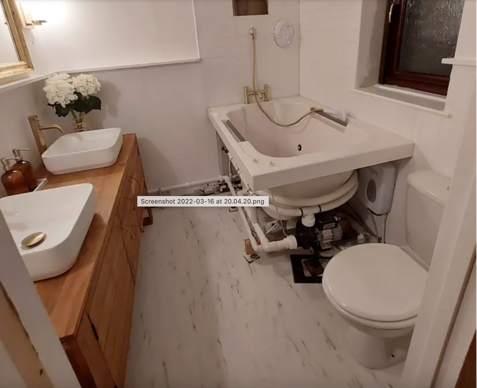

This is mine during reno (in projects) The floor area is a tad over 4 sq m. We have a deep bath, shower over; vanity unit with 2 sinks; and a loo. It's about how you use the space really.
