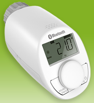

To my mind biggest problem is TRV marked *123456 we know we want say 20°C but we have no idea if that equals 2 or 4, and in real terms there is no exact number that = 20°C likely around 2.5 but depends on room size and radiator size. If you take a standard TRV and try blowing through it, at 20°C you will realise it starts to close at around 4 and fully closed at 2 it is an analogue device.

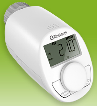

With electronic TRV heads even the cheap ones at £15 each 61dmtMm13BL.jpg it shows °C. This means you know setting on TRV so now it is simple, if temperature over shoots you close the lock shield valve a small amount, and repeat until it does not over shoot. You only have one variable. Once lock shield set you could return to old type TRV and these work great, unless you want a programmed change, but you need one set correct so you can set the other.
With electronic TRV heads even the cheap ones at £15 each View attachment 251959 it shows °C. This means you know setting on TRV so now it is simple, if temperature over shoots you close the lock shield valve a small amount, and repeat until it does not over shoot. You only have one variable. Once lock shield set you could return to old type TRV and these work great, unless you want a programmed change, but you need one set correct so you can set the other.

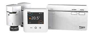

Be it EvoHome EVO-home1.jpg or Wiser Drayton1.jpg or Tado each have there own plus and minus features. Main point is the TRV controls the room, the wall thermostat or hub just collects the information and decides what to do with the boiler. Within the limits of the boiler software, and the way it can interface with thermostat software.

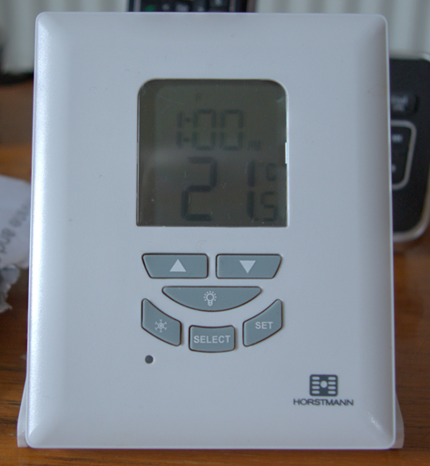

I have myself failed to set TRV heads correctly, in my mothers house I used a wall/free standing thermostat IMGP7319_20_21_tonemapped.jpg with the idea the living room was important and it did not really matter what happened to the bedroom, hall, kitchen etc, as long as not freezing.
What I failed to do however was also set the living room radiators TRV and lock shield valves, and the wireless link was lost to thermostat shown, so walked into her living room and the heat hit one at 32°C which should have never happened even with a faulty thermostat.
After this event I did take some time and effort to set the TRV and lock shield valves, and actually fitted an electronic TRV head.
But we all make mistakes, and I can see how a limit of 22°C for the "demand for heat" system is a good fail safe, specially where some one has not fitted a TRV in the room where the wall thermostat is fitted.
