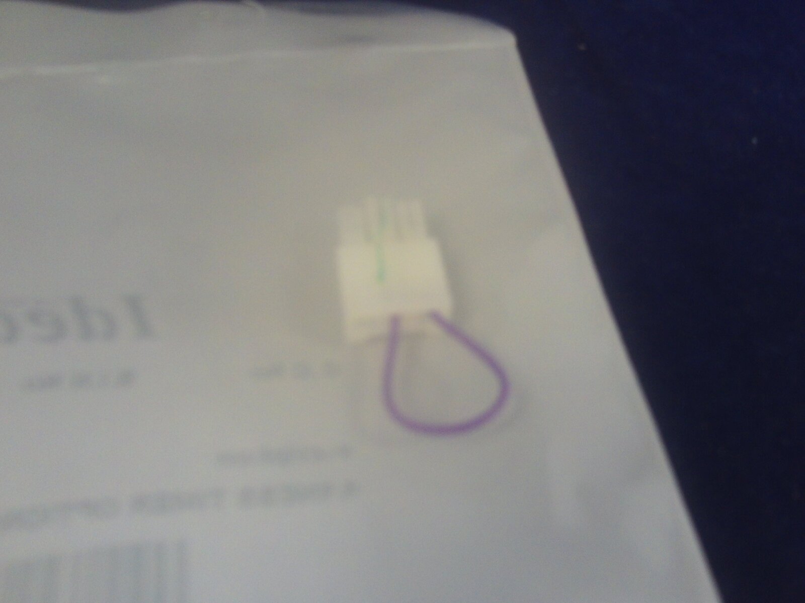

The old receiver uses Opentherm. A Hive receiver does not.
With the mains power to the boiler switched off:
Disconnect the old receiver wires, and either link the two Opentherm +- wires together, or buy the link plug which does the same thing.
The Hive receiver connects to LNE for power, and the other two switched connections go where the red link is in the 'thermostat' terminals as in the original photo.

Got this coming tomorrow, hope it works
