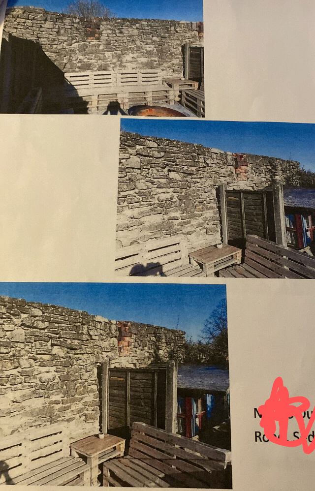

The engineer /surveyor turned up ( approximately aged 65) with a spirit level with a Wilco’s sticker on it . Did nothing but look at the wall from the ground lvl .
Was he a real surveyor, or someone acting the part of?
The proposed date of the meeting on the letter was 10th November, is that the meet which has just happened?
My suggestion was to check that the “surveyor” is one. If he claims to be, and is not, he’s in trouble.
(Depending on what he claims)
The above photo is from either side.of the neighbours who have no problems with the wall. Only the guy at the rear seems to be bothered I think he just wants a nice pretty new wall
He wont get a prettier wall than that, it has character and patina.

First job (if not already done) is written cease and desist notice to neighbour- wall is not his property, leave it alone.
Second job- land registry, your deeds and neighbours deeds (cost you £3 per address). If you're lucky the land registry plans will show the wall within your boundary and outside neighbours boundary.
Third job is local history - look for pics or plans predating the neighbour house going up, hopefully they'll show wall is there. If there's a local paper, have a look in their archives for any pr shots of the council estate going up. Also drag yourself to the town hall, have a look for the planning drawings for the council houses.
Once you've proved ownership you can get on to the unlawful attachment to the wall.

Along with our deeds is an Indenture dating from 1917 which described ########## as being sold to Arthur and Emily Small. The detached property bounded to the front by the road leading from Wolverhampton to Dudley and bounded on both sides by other parts of Perks Furlong - a piece of land, The sale included all the messuage or dwelling house and outbuildings erected and built on the plot of land known as Vine Villa. At this time Perks Furlong was grazing land according to historic Ordinance Survey maps of the area.
When the property became residential in 1917 and no longer used as a public house the outbuildings and large nail workshop were demolished from the plot of land leaving their outside walls which created a boundary. They are tall due to being originally a 2 storey building - a large brew house with malt house over the top. This was never built as a dividing garden wall between properties but actually the existing buildings external walls built on the boundary of the plot next to the open grazing land.
After seeking professional advise on this matter, It is our opinion that the wall that bounds the property is actually the remains of existing outbuildings from its previous use as a public house. It would have enclosed the yard from the grazing land long before any other properties were built, so cannot be considered a party wall.
When we purchased the property we were notified by Mr. Hyde by letter and emails that the wall was our responsibility according to his deeds, Our own deeds and Indventure confirm this ownership. Our offer of getting the wall repaired facing ####### Road still stands, we will take responsibility in getting this existing wall repaired in due course.
