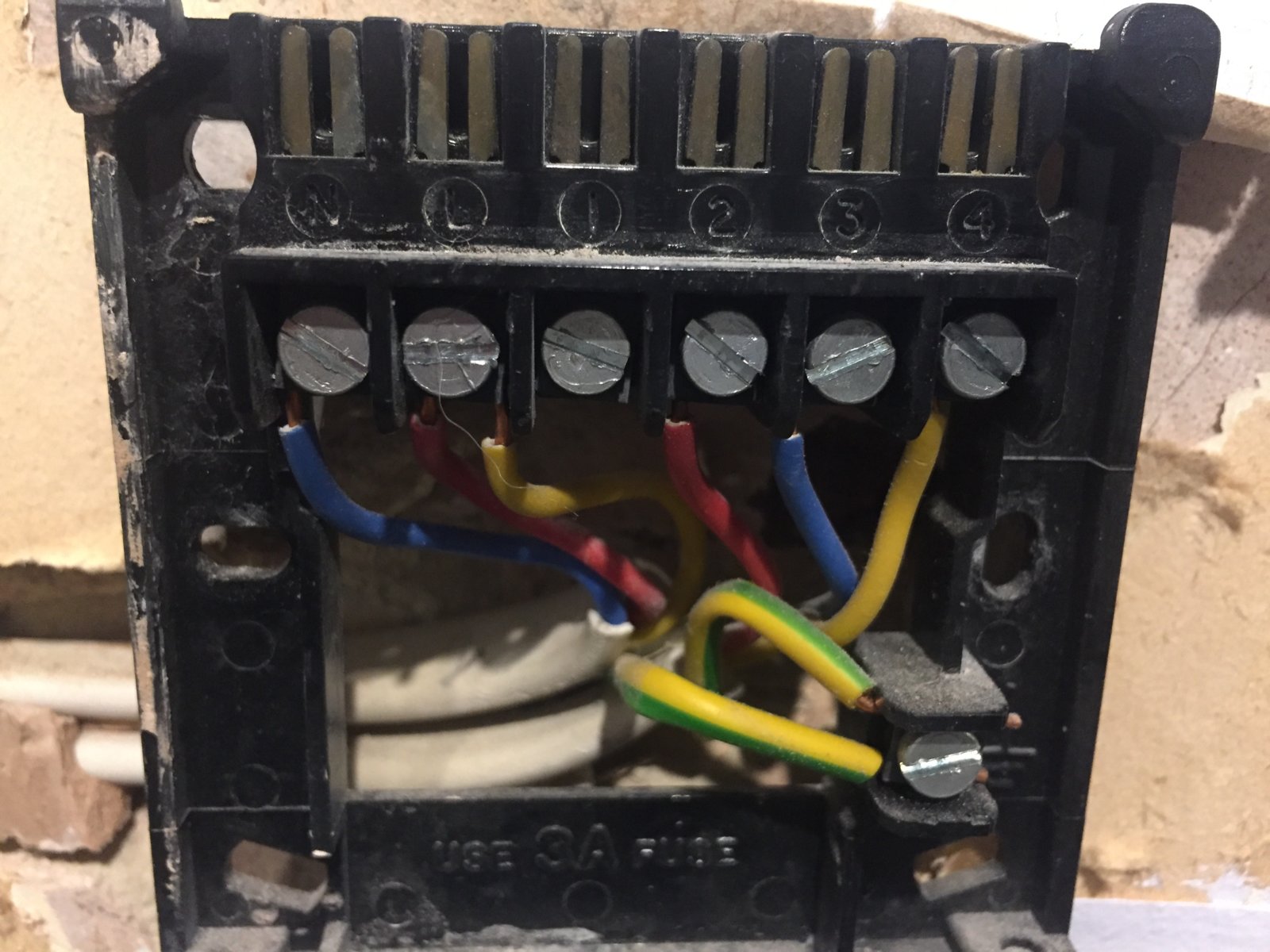

One final question. The current programmer, has 2 earth wires attached to it (see attachment). The new Heat Link doesn't have a place for earths, can I just blank these off, or do they need to be earthed somewhere?

Heatlink earth terminal third from right.
Not sure how I missed that, it's been a long day!

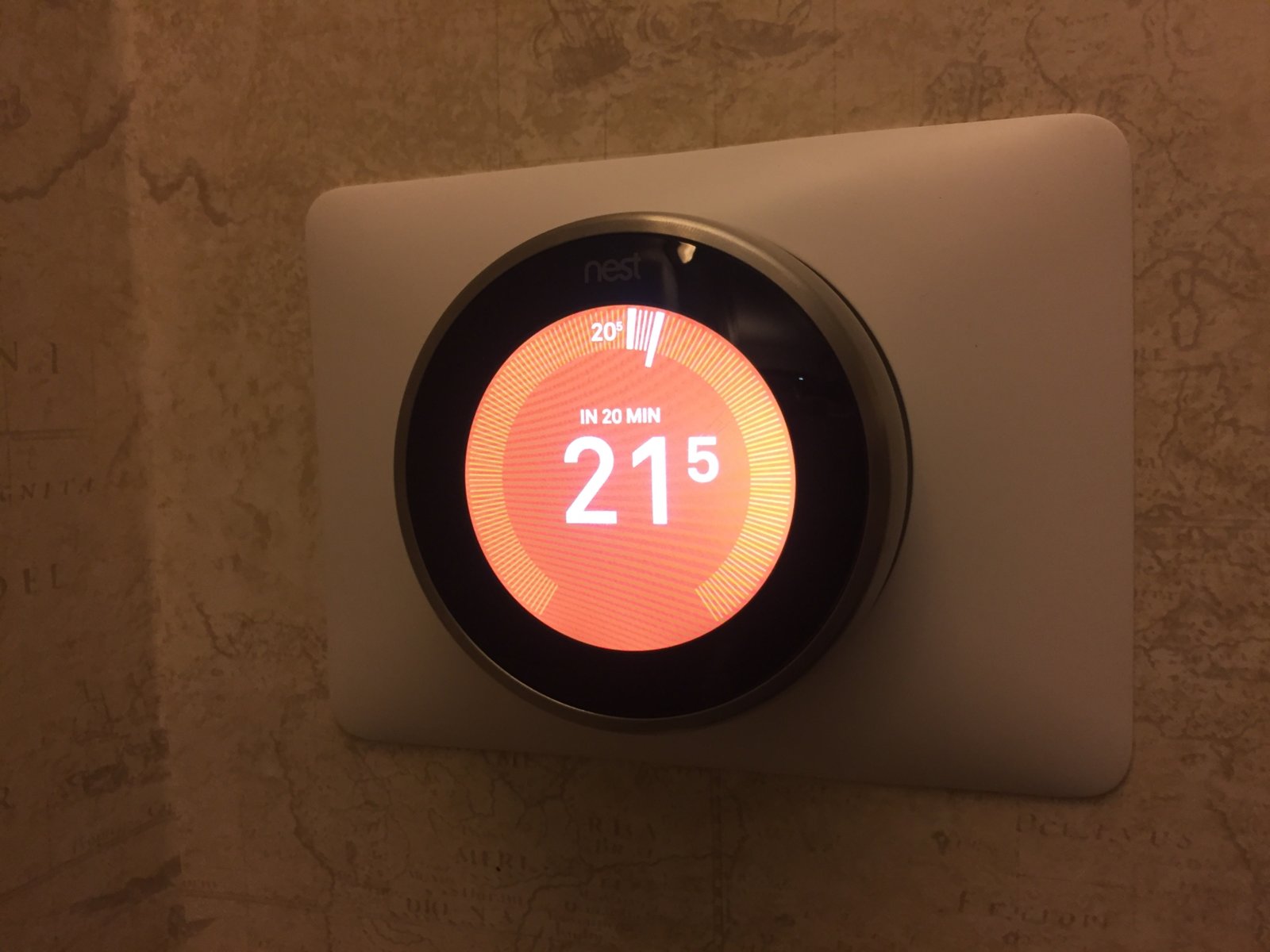

I then moved the yellow MOMO cable from terminal 3 to 4 as you explained and removed the thermostat cable. Finally I used two of the thermostat wires in the T1 and T2 terminals of the Heat Link, and used these to power the Nest Thermosat which is now sat nicely on the wall where the old stat used to be (see image below). I had to use the included blanking plate to cover the unwallpapered area left visible form the old stat.
All in all, very pleased and a big thanks to Stem for all his help and advice. Having everything figured out in advance made it a breeze, I just took my time and followed the steps required.
