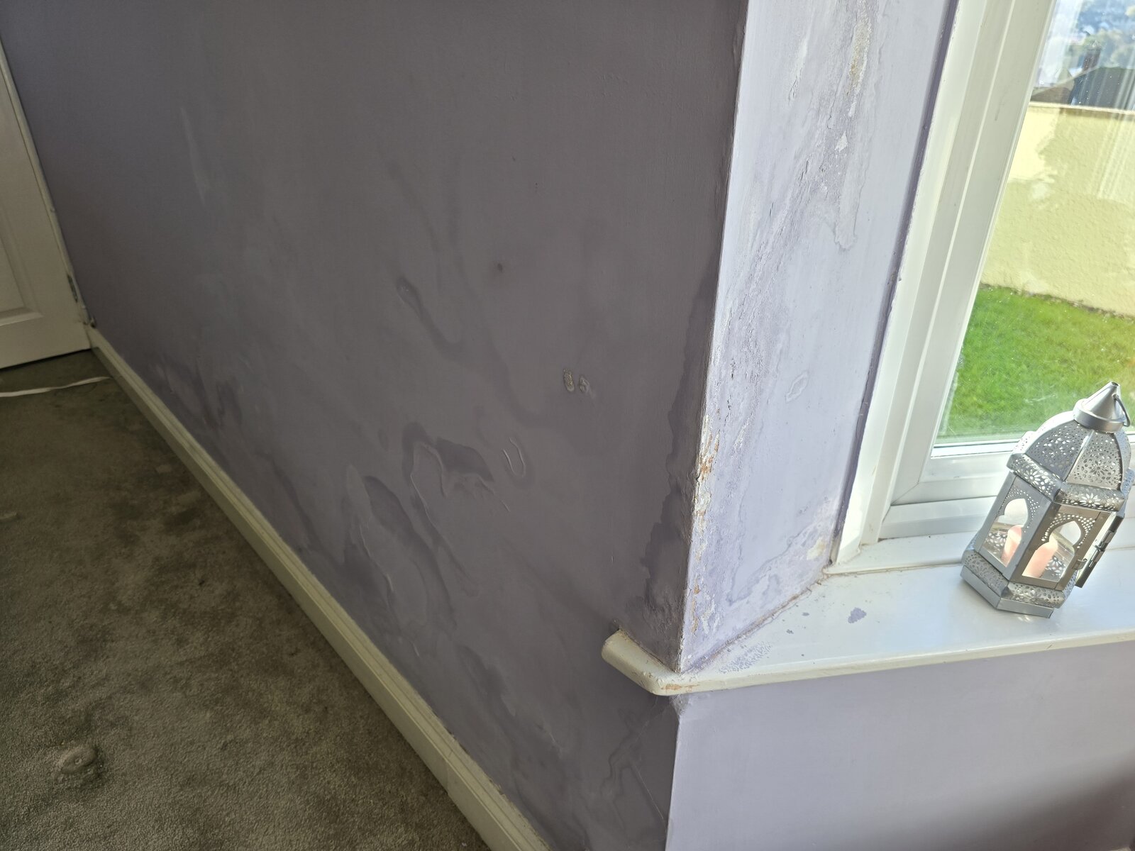

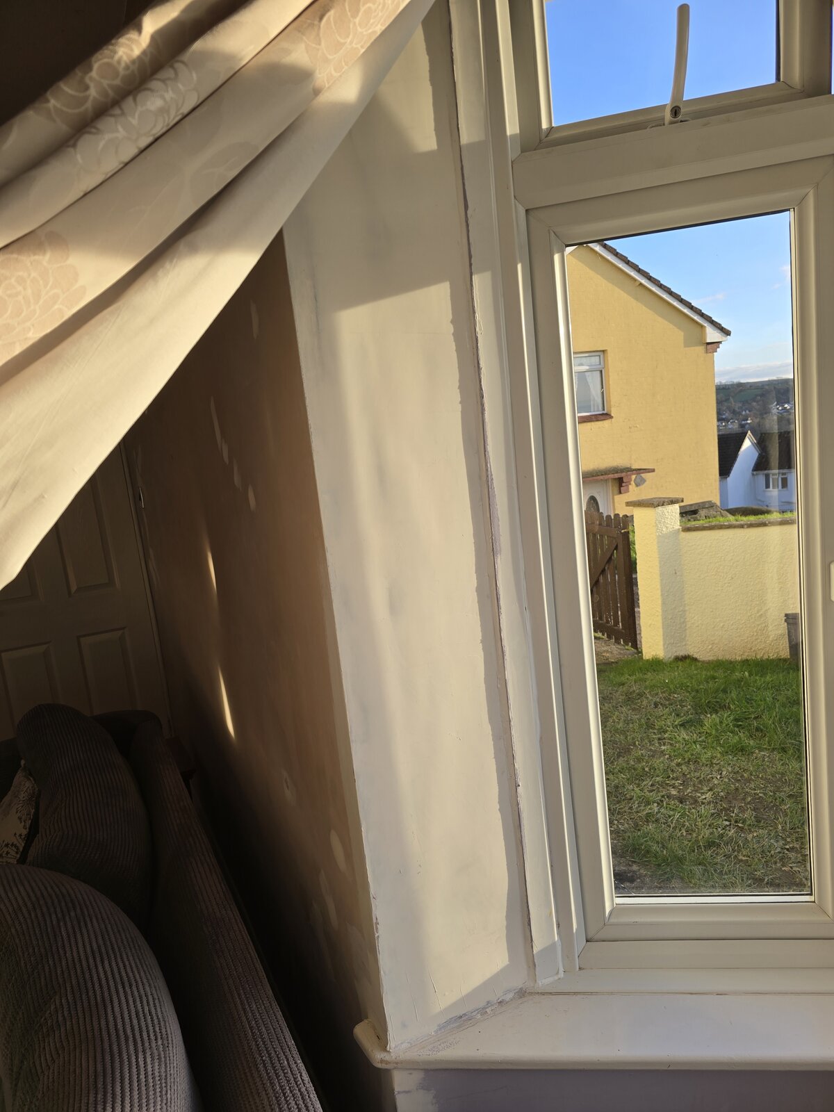

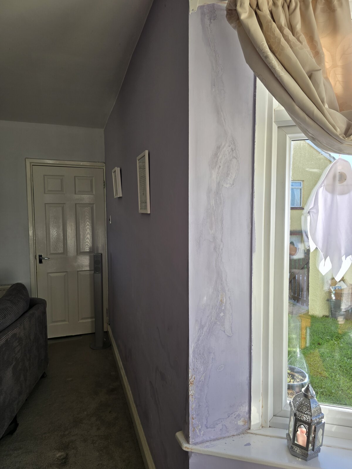

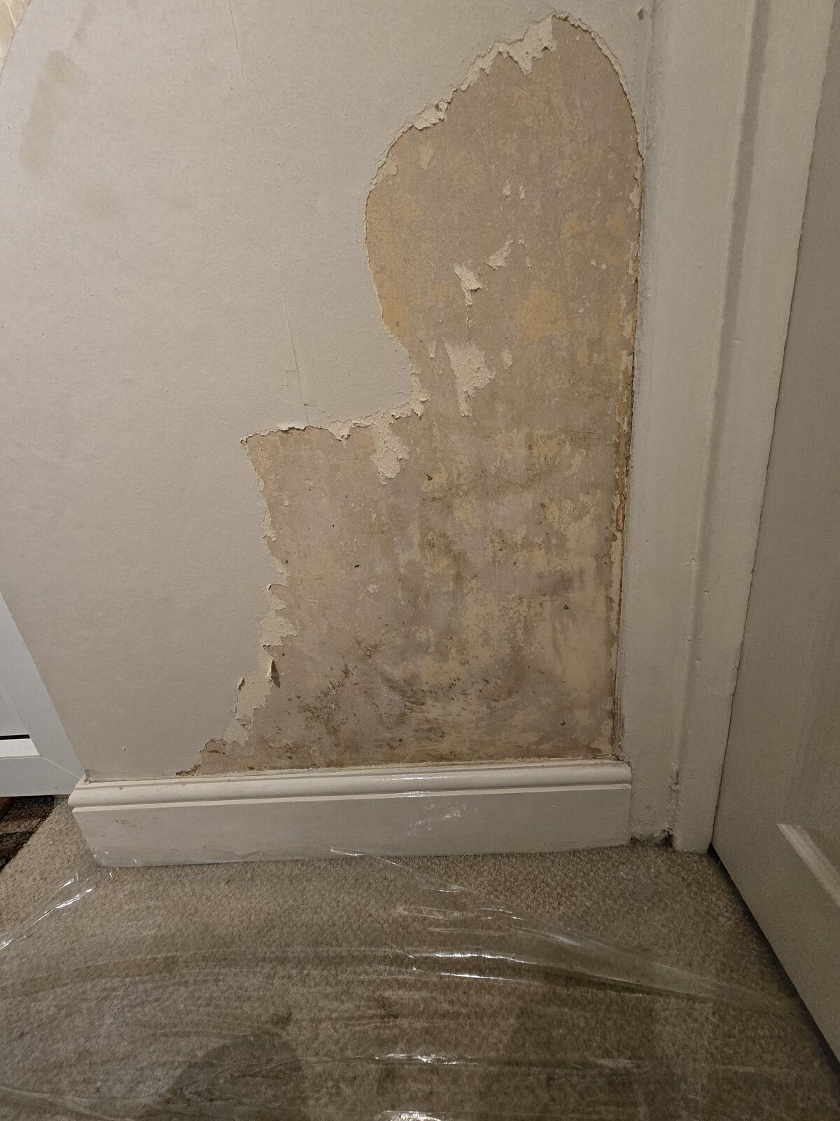

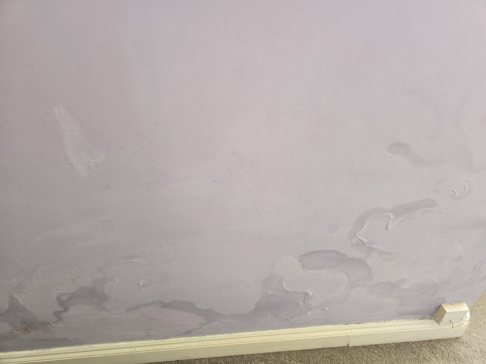

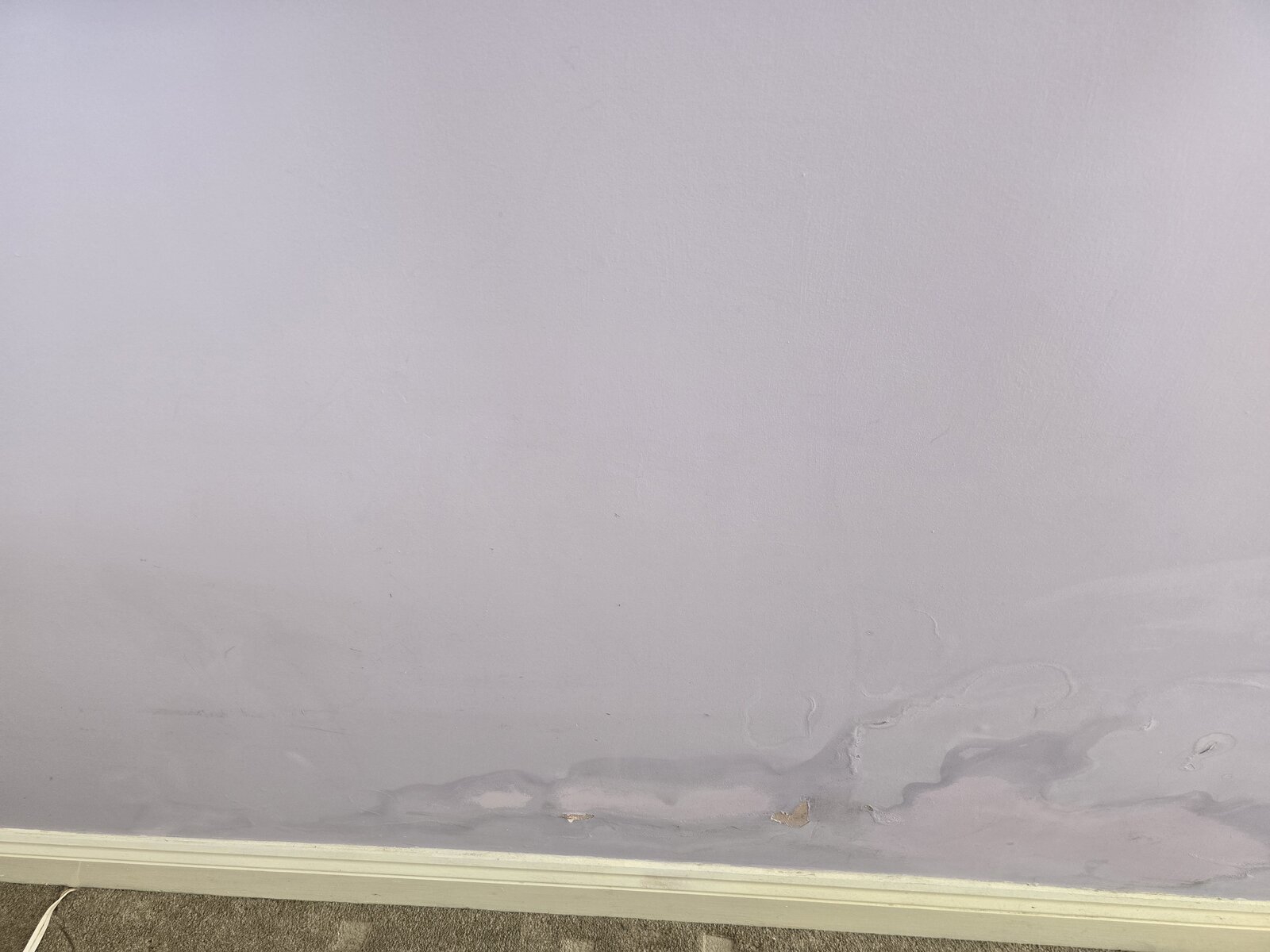

On the ground floor of our 1980s ex-council terraced house, we had quite a bit of damp/water damage to the wall from the bay window ceiling to the window sill.
We also had what looked like damp/water damage coming from the ground between the bay window and the main entrance to the house. This would be the lounge and part of the downstairs hallway.
See the pictures for the internal damage

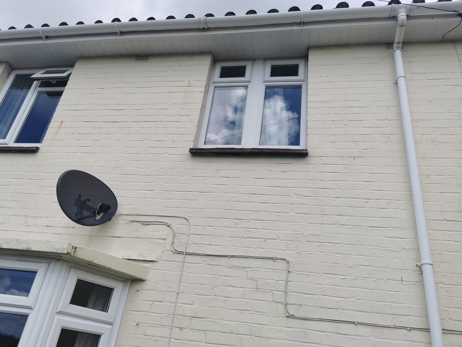

In August 2024, I contacted a general builder company, who identified that the water was coming in from the corner of the roof bay window, and travelling down the bay window wall, and then following cracks in the wall across towards the main entrance.

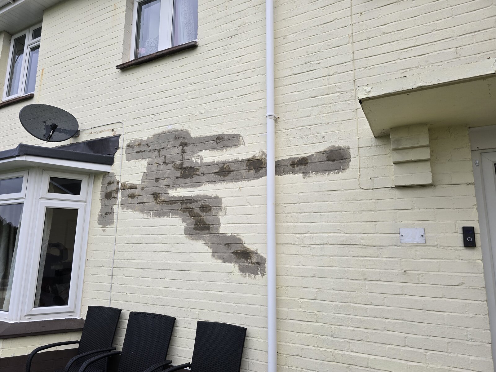

Only a small section of the bricks on the outside wall were raked out and repointed.

I don't have anyone I can check this with, and I feel that £1968 for 10 hours work (and possibly another hour on Wednesday) is a lot of money.
Especially as they were £2600 with the roof fix, which ended up costing me £1550 with a trusted roofer.
I attach all before photos, followed by the completed repointed/sealed exterior brickwork and filled in/sanded interior walls (and the part in the hallway they said doesn't need treating).
Thank you for reading this. All advice welcome. Even if you think this is good value and that I am over-reacting.
The last 4 photos are of the finished areas.

So the first roofer didnt turn up, leaving a net quote of a grand or so which was doubled for extra work they then said wasn't needed. However you have accepted the quote and the variations.
Replacing the bay roof was probably needed as it was leaking, but was the random tracking of rainwater the cause of damp above the skirting. That could be rising damp on the inside.
They said it wasn't rising damp, as it didn't seem to be behind the skirting. Just slightly above. Which coincided with cracks in the internal plasterwork that ran from the window sill and down the internal wall.
The skirting is dry, and the wall behind it was dry.

The way they have filled the plaster doesn't suggest a continuous crack the full depth of the cavity, more a surface crack.

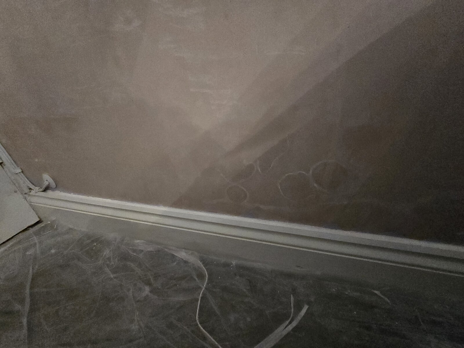

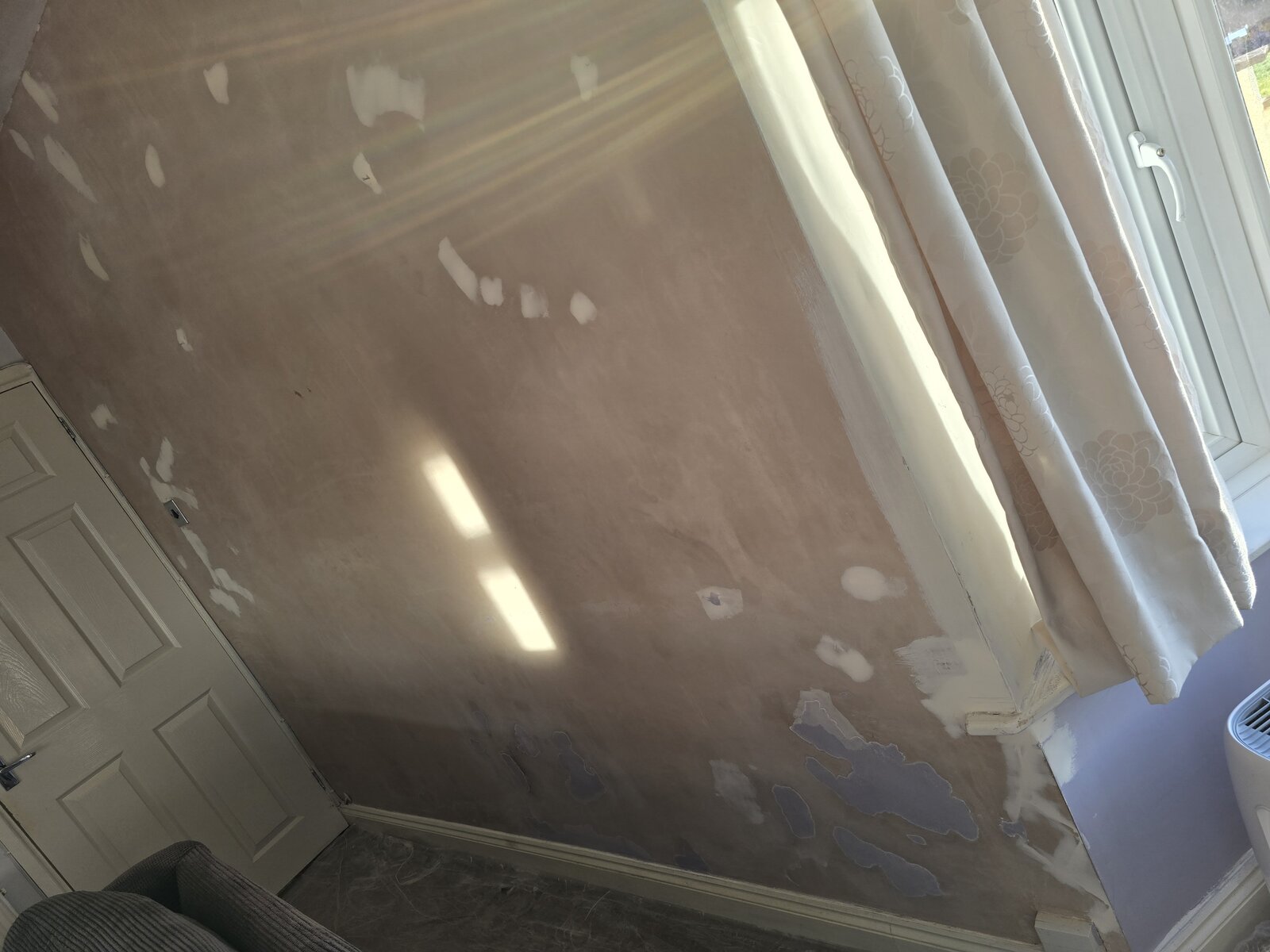

I've just checked, and a week on, since they've removed the paint to show the plaster, there are these white circles appearing (that can be wiped with finger):

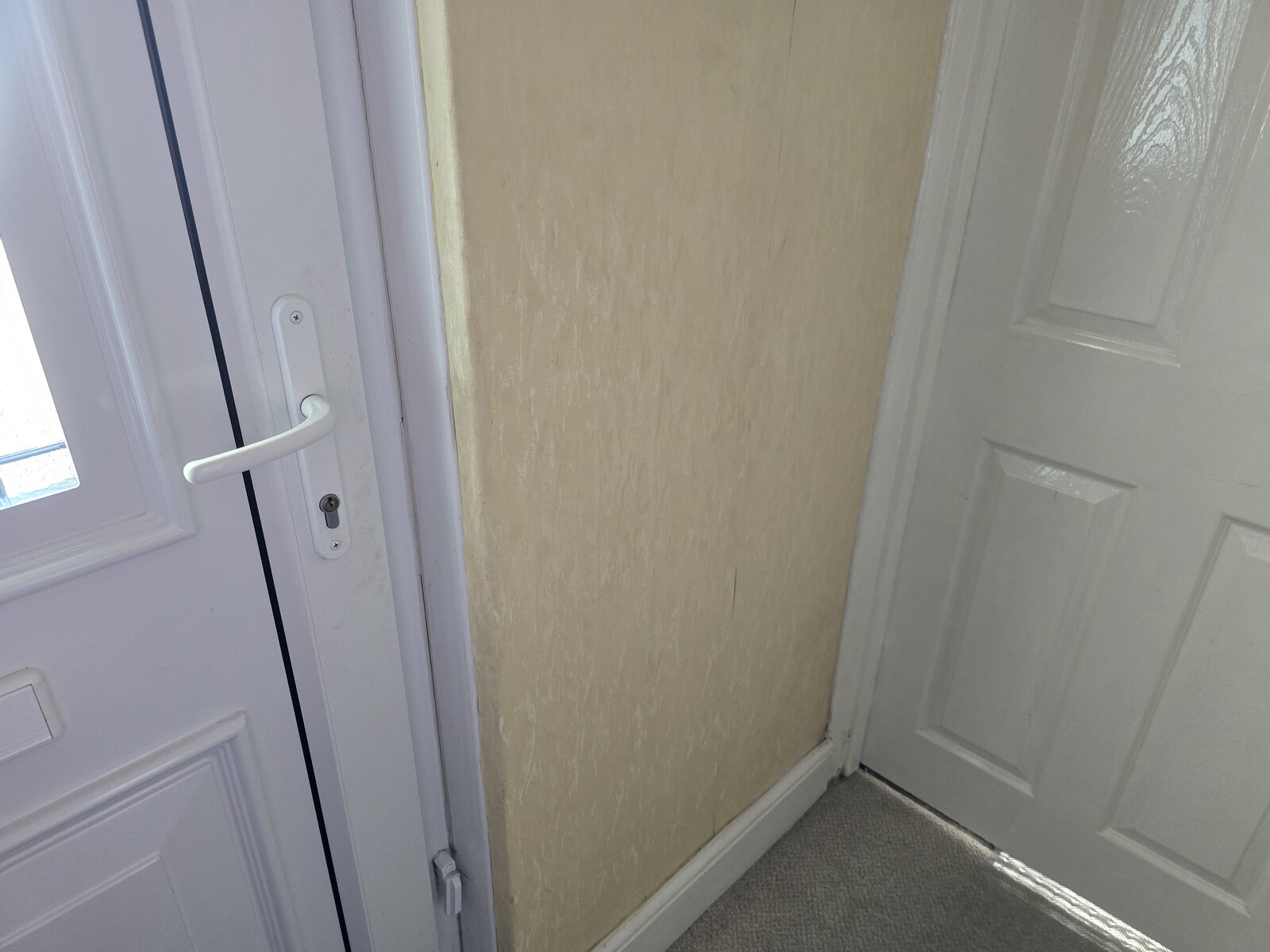

Also, this section, by the front door, they said doesn't need any action now (even though they did at first, and is covered in the quotes). However, the wallpaper was coming away in the bottom right, and the skirting looks damaged. They said as it's being covered by wallpaper, it should be fine and won't need treating / skimming:

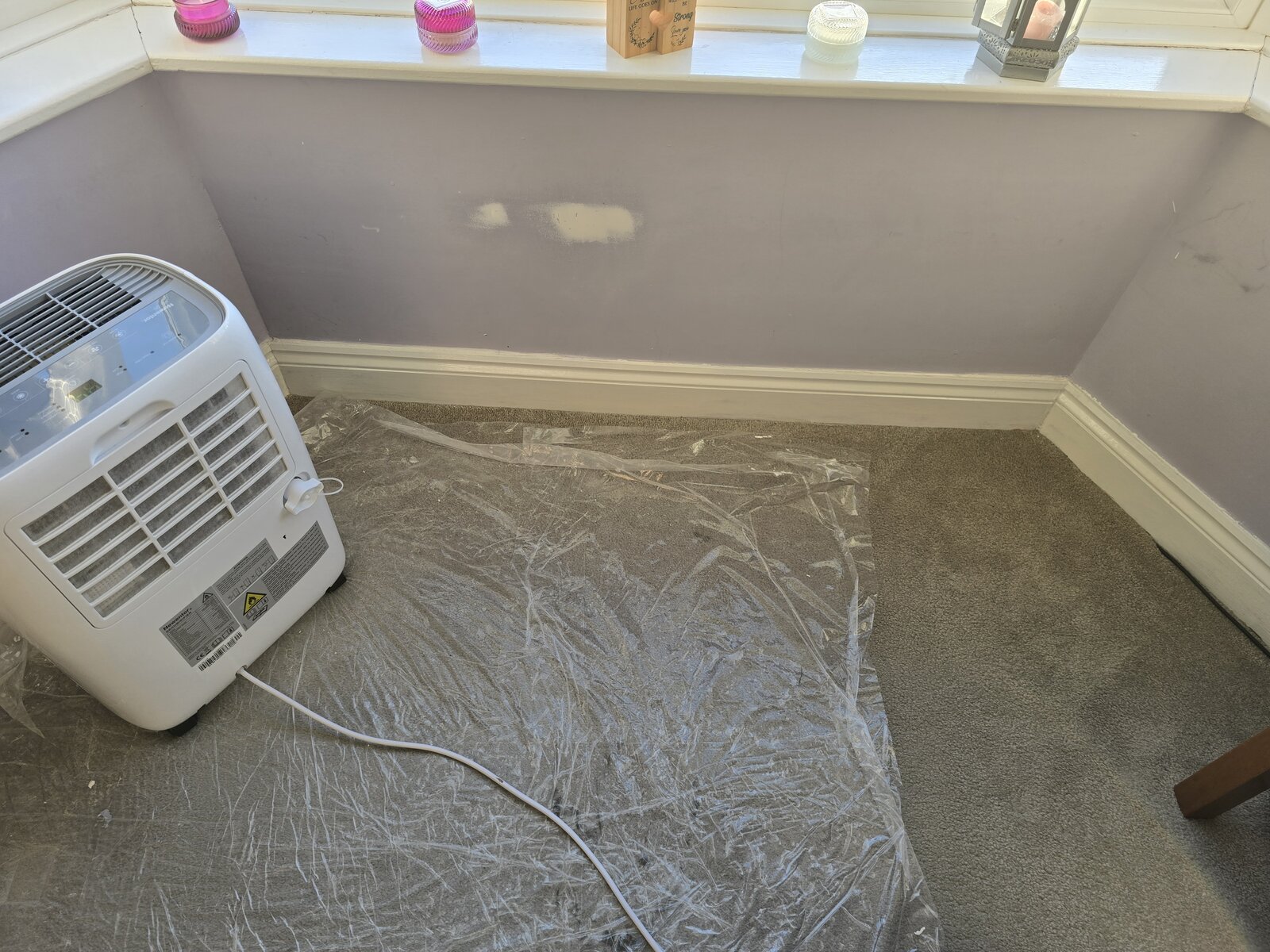

I am running a dehumidifier in the room, under the builder's advice. To help dry out the section from the bay window ceiling to the window sill.
Probably salt from the damp or when tne plaster dried. Tne plaster and external paint look newer than 1980 so probably a previousattempt to cure the problem
It will need new wall paper now
Keep the room heated, dehumidifying can prevent moisture build up but doesn’t completely remove damp which may still be present in the wall/plaster
