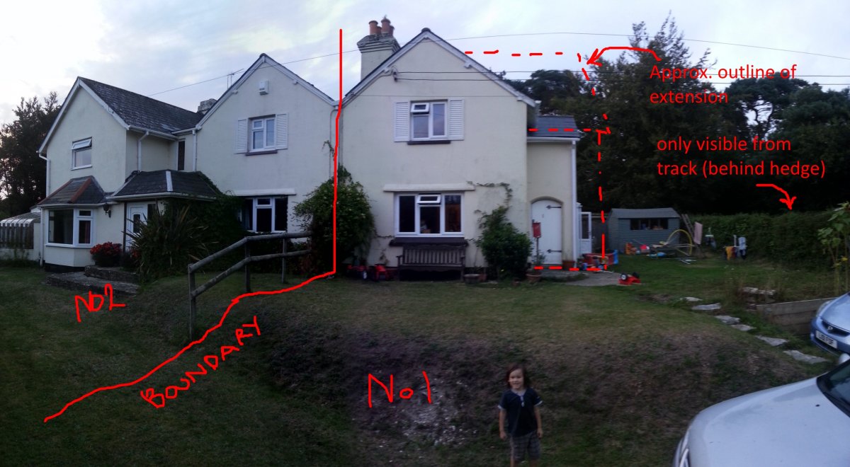

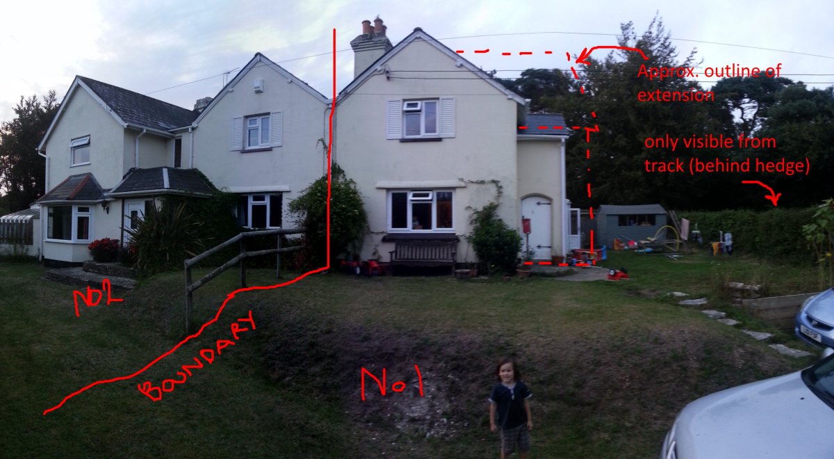

Any chance of throwing up a picture of the front of both of the properties.
Here's a shot of the front - it's a bit distorted as I couldn't get far back enough, so had to take a composite.
I did actually take a peek on google maps and didn't think that there would be an issue with overbearing, though to be fair that wasn't really their issue. Armed with your calculations, showing them the error of their ways and maybe a quick letter from the planning consultant then a resubmission might be the way to go
