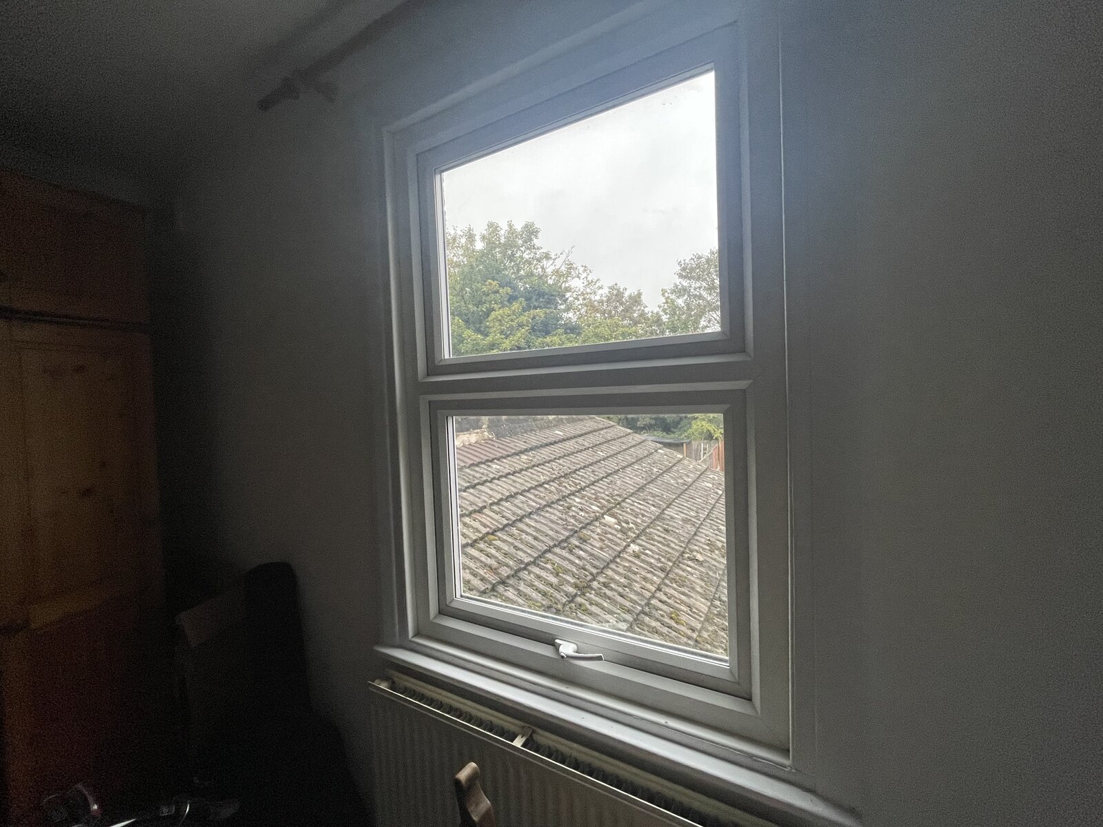

We moved into a Victorian conversion flat late last year. (We are the middle flat of three) Two bedrooms. One of the bedrooms is an outrigger extension. It has three external walls & a small attic space above. Solid external walls. It is also at the back of the building & only gets a tiny bit of sun late in the day.
We quickly noticed that it was colder than the rest of the flat. We’d love to do something about it sooner rather that later, but don’t want to lose to much space (it’s 3.4 x 3.4M) or spend a whole lot (We’re not positive how long we’ll be here.)
I also understand that with solid Victorian brick you can’t just stick plasterboard on to it? I understand that it needs to breathe. (Are there insulated plasterboard panels that can just be attached to the wall with adhesive?) I’ve been reccommended some 12.5mm Vapor Panels, by a decorator but not sure they’re right for Victorian walls.

I spoke to speedline and they stated that their insulated plasterboard was OK to dot and dab on a solid brick victorian house.
Using knauf adhesive and knauf boardsealer for wall paper.
With the caveat that the room be dry, free from damp and that the pointing be in good condition.
It's always a bit of a gamble with this sort of thing because each house is different and suffers/experiences different effects.
We eventually 50mm on following their instructions its noticably warmer already. But only time will tell if it suffers from any problems, there's no guarantees with insulating solid brick...

That has no insulation, so it's pointless. To make a meaningful difference you'll really need 50mm PIR (the type bonded onto plasterboard with built in vapour barrier, and a back face that will stick to the adhesive). You could go thinner but it will take a long time to recover the cost of it. Wickes is not a cheap place to buy insulation boards.
Yep the foil face will do practically nothing for insulation and very little as a vapor barrier, as how are you going to Tape the foil when it's on the back of the board?
If you were doing it absolutely as best you could you'd battern out about 25mm, then a complete taped air/vapour barrier, then enough insulation (50mm min)to stop the warmth of the room meeting the cold of the solid brick.
You ensure you insulated the window reveals/sill and that plug sockets/lights witches were mounted in shallow boxes that didn't breech through the insulation.
Also you'd ensure when the room wasn't actively being heated that there was enough ventilation for moisture not to accumulate.
No. Thats a nonsense repeatedly banded about.
Put insulated plaster board on with the required adhesive and it will be fine.
Or batten and insulate between and over and that will be fine. Leave no voids, and if foil backed insulation board, tape all the joints.
