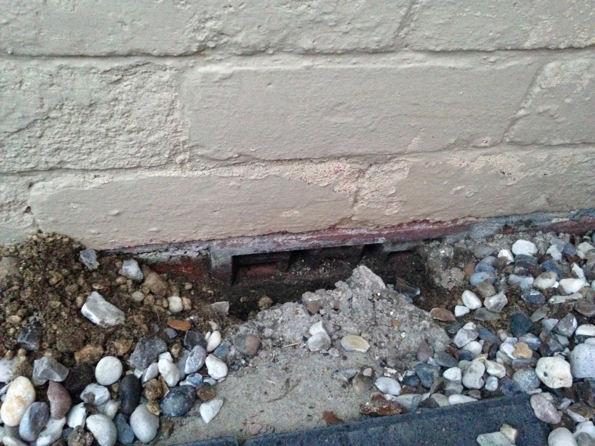

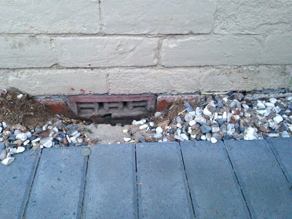

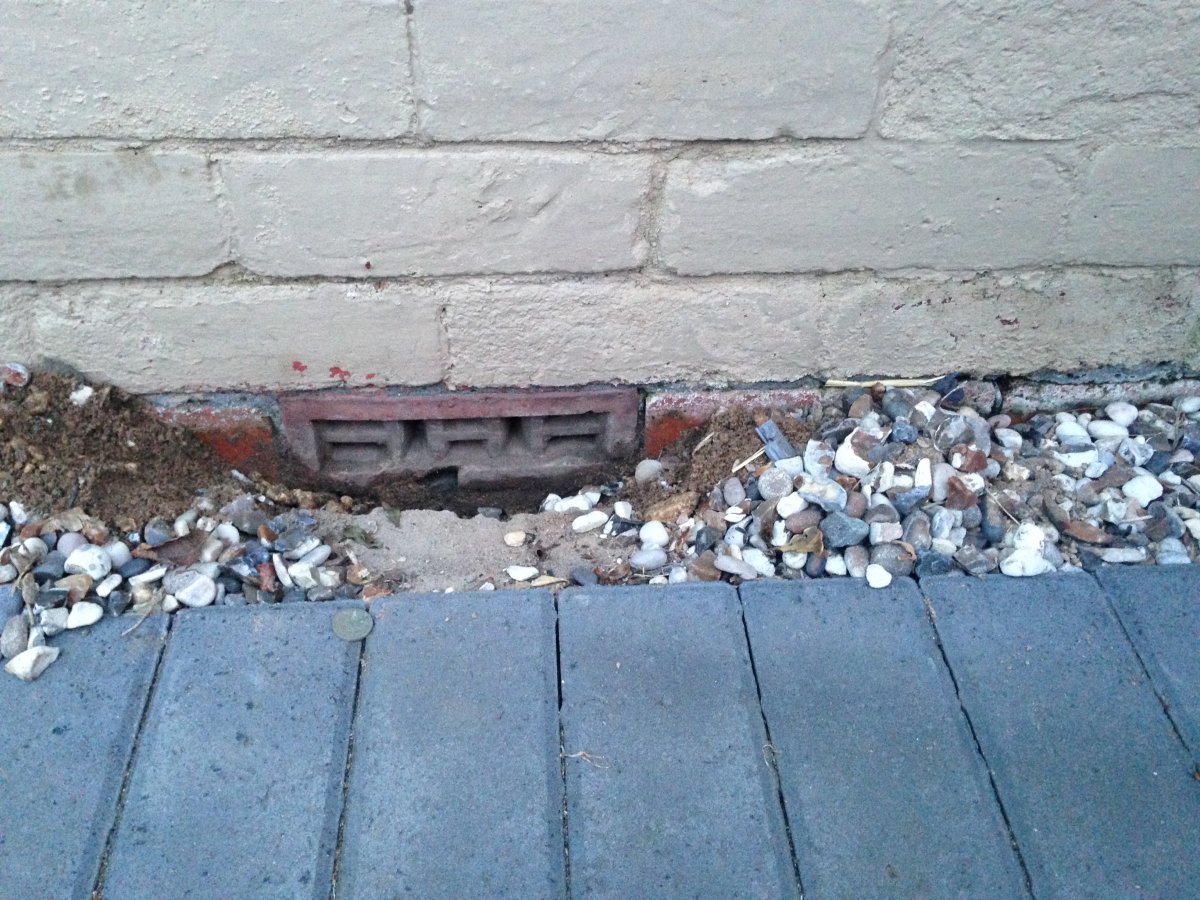

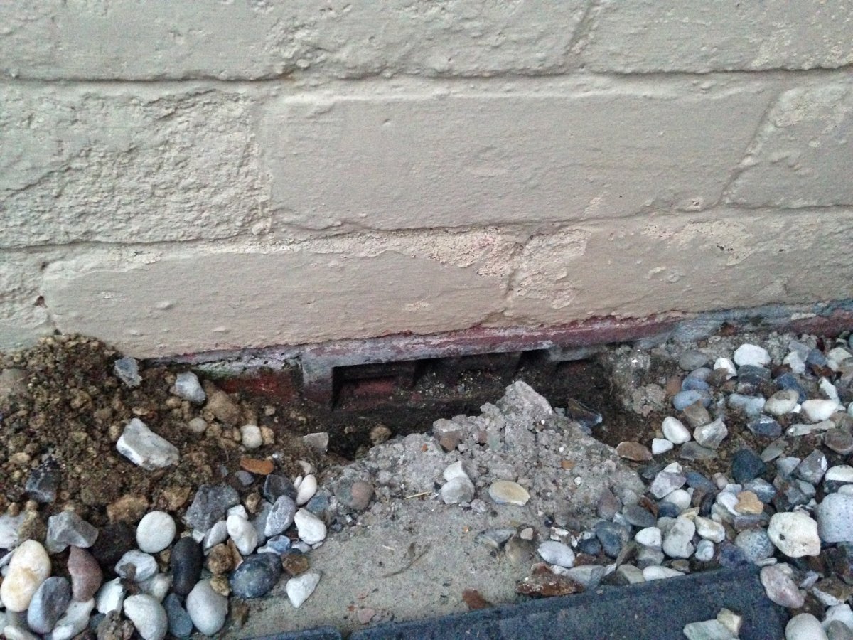

Hi everyone
Little bit of background information.
I live in an ex council house, built 1935.
Recently taken the carpet up to find one corner of the floor was slightly damp. Walls showing no sign of damp.
The floor is concrete construction with asphalt covering. I believe the asphalt was used as a dpm back in the day. The only area where isn't covered with asphalt is where the old stone fire hearth used to be which seems to be concrete. This too has shown slight dampness.
Because the corner of the house was showing signs of damp I went outside to investigate. I found two air vents which were almost buried and blocked up with mud and stones. These don't go all the way through to the house so not really sure what they are for? I also had cavity wall insulation attempted a few years back and was told that they could barely get any insulation in the cavity and they blocked other air vents up.. is this ok, should they be unblocked... I don't have any vents at all on the inside of my property so not sure what these vents are for.
Any help would be greatly appreciated.oxy acetylene

The external ground level might be too high & bridging the outside wall DPC, and the shallow cavity might be blocked thus allowing moisture to penetrate across the cavity and affect the inside floor.
If the floor is damp then its almost certain that damp has affected any nearby skirting and plaster.
Pics of the damp areas might help.
Hearth and fireplace areas are always vulnerable to rising damp - and your posted pics show damp soil.
They also show bubbled paint - which usually means moisture vapour behind the plastic paint. Masonry paint should have been used.
Spalled masonry also indicates previous moisture connected damage.
If you only have two air bricks then they would have had no part in ventilating below any possible suspended floor. The air bricks are original BTW.
FWIW: CWI "surveyors" should have examined the cavity & wall construction suitability prior to any attempt to install CWI.

I'd start by clearing all that crap out of the gap between your house and drive to at least the bottom level of the airbricks.

Airbricks are ventilating the narrow cavity. As to the floor, we have a tarmac/asphalt expert here, why not search through some old threads.
