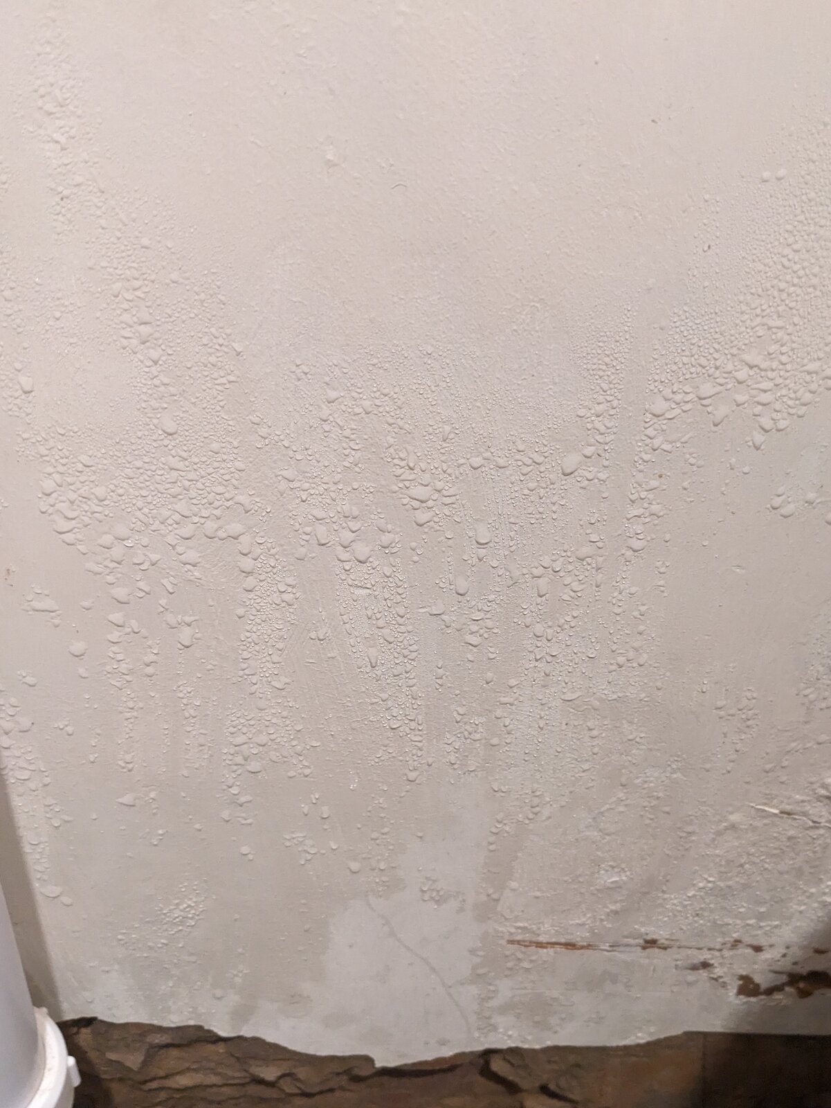

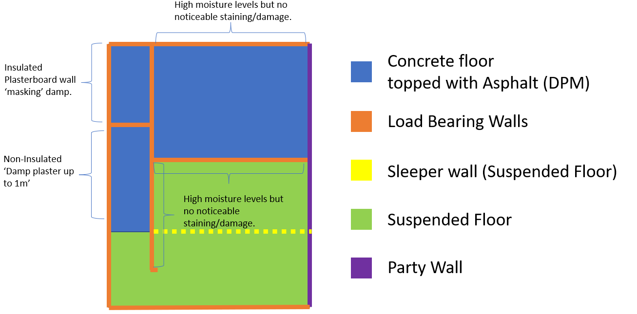

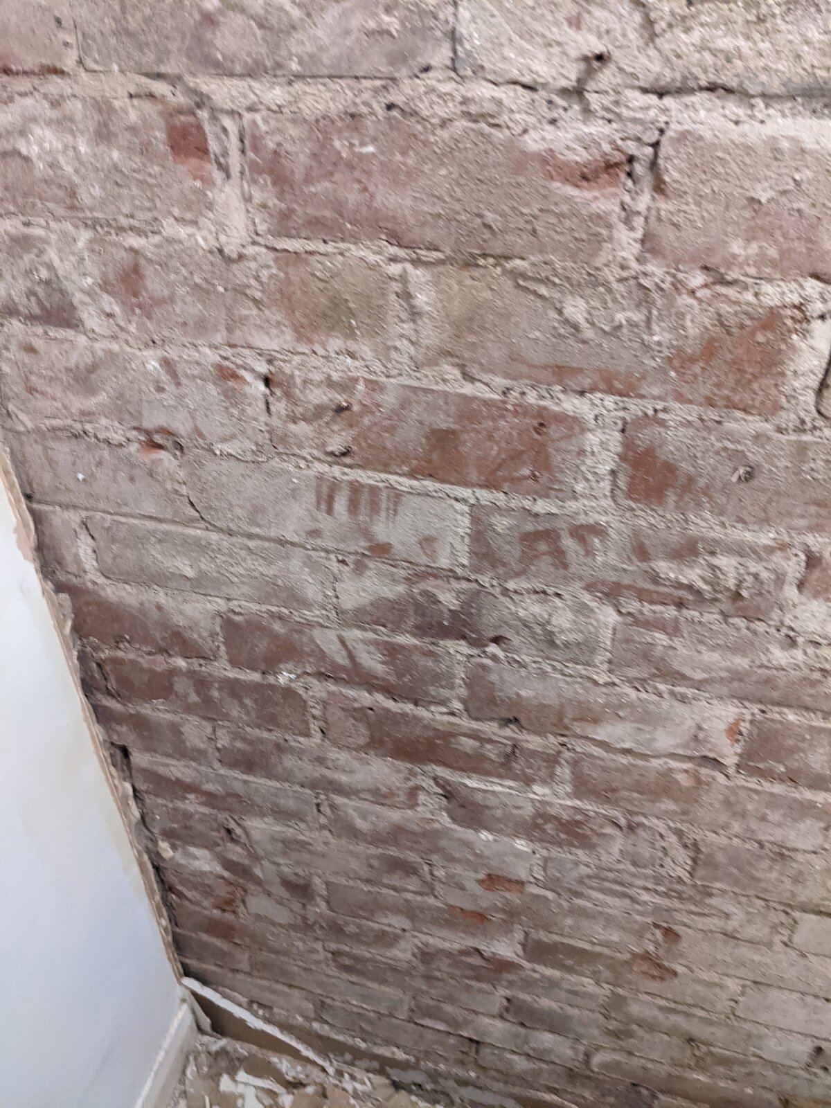

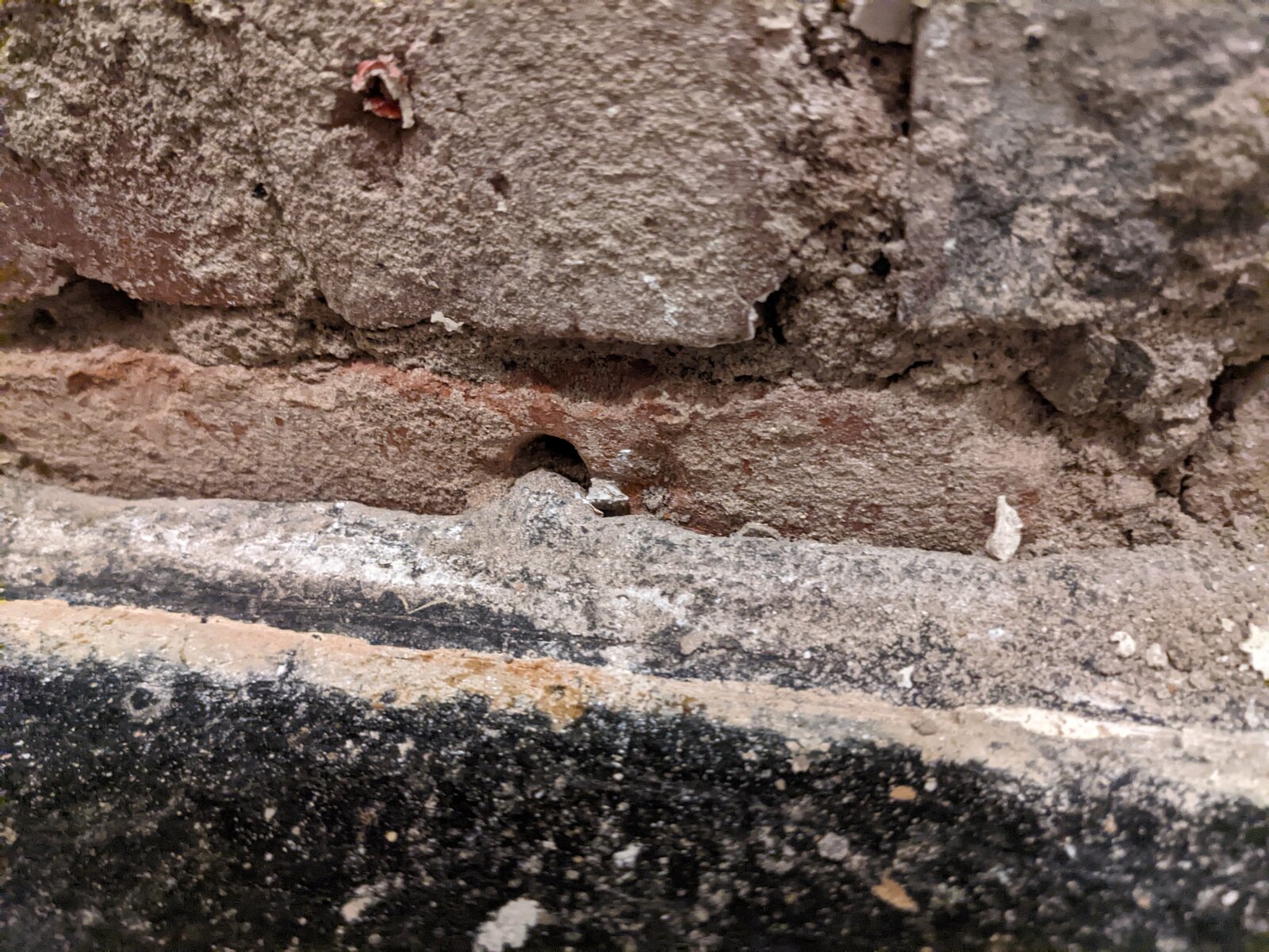

~1930’s semi, cavity wall construction, built with no DPC, ~50mm cavity, insulated with blown fibre. Insulation (from wall tie check) appears bone dry. In my personal opinion, if it’s useful to know, the house also potentially has externally applied (StormDry like) masonry cream. The house floor sits ~1m above ground level on all sides – aside from party wall. A previous owner has applied a (waste of time most likely) retrospective chemical dpc externally around the floor level of the house. The rear wall of the house is quite exposed.
The moisture/damp appears to be around the perimeter of the concrete floor. It is causing noticeable staining/damage to the side elevation. Going by what the damp surveyor has said and my own reading, I suspect the solid floor base material is wicking up moisture which is travelling through the concrete floor. It then hits the asphalt layer and is pushed sideways and comes up the plaster in the walls. Although, feel free to tell me that moisture is unlikely to be wicked up that far and the moisture is coming from elsewhere.

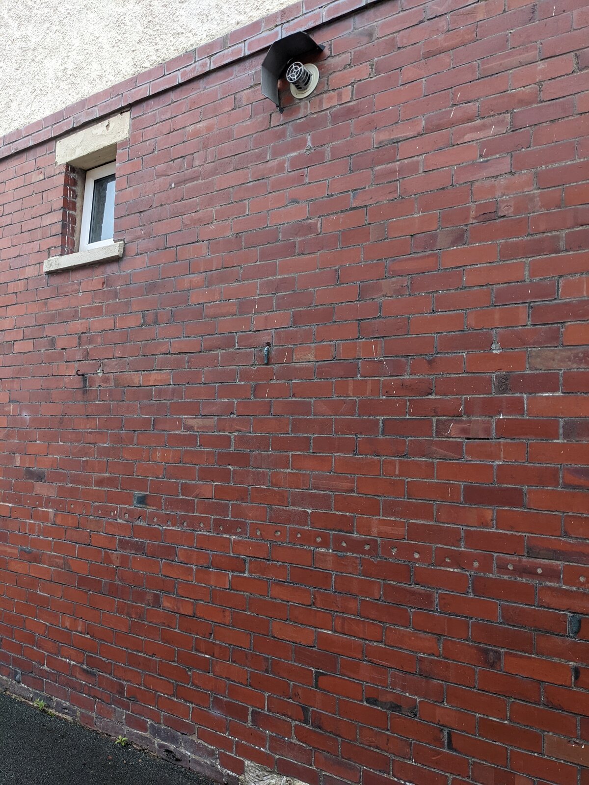

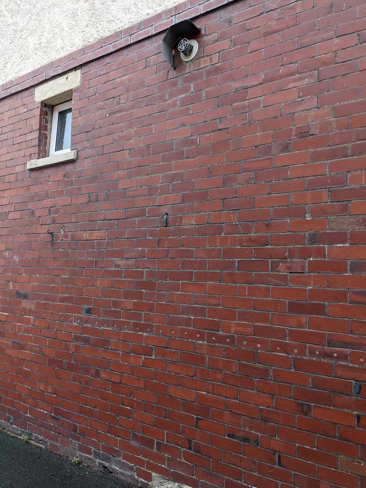

Here's a picture from outside that wall. Nothing immediately obvious aside from the boiler overflow / vent and the brick 'lip'. Oh and the poor pointing.
Just done a quick measurement assuming the overflow runs in/out of the same height/course of bricks.Where is "internal floor level" on that wet wall?
Thanks. Will arrange a drainage survey / check (access is poor) and do a thorough listen with a helper on the water inlet.Let's suppose the solid floor was very wet
The wall would look like that
Let's suppose there was a leaking pipe in the floor
It would make the floor very wet.
