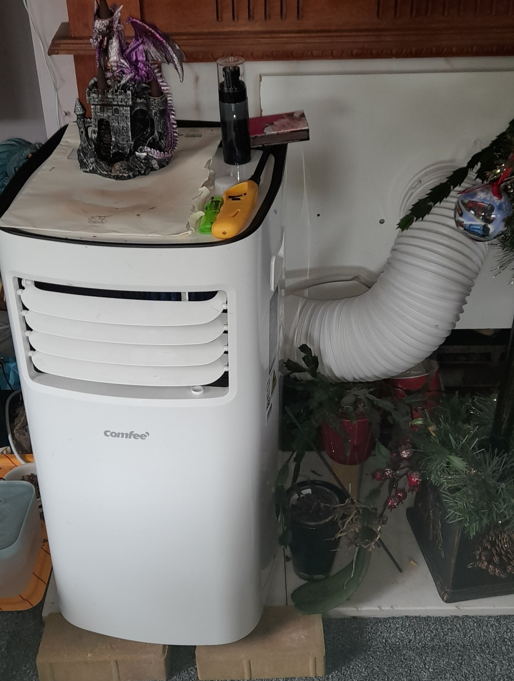

Also, a problem with security, leaving windows open is not the best idea. The tumble drier, before we had cats, used the old cat flap as the vent. That worked well, as we did not need to use that door, but the AC is hardly large enough for the room, 24 x 32 foot, with two windows and a patio door onto the veranda.
We have to decide, windows and doors wide open, or closed and AC on, and this will change through the day, so windows hard to reach from the outside, depends on how athletic someone is, so the windows are not really an option. The chimney works well, as no need to change anything, when opening or closing windows or doors.
But if the house has already warmed up, the AC is not large enough to cool it, so in the morning we need to decide, windows and doors open, or AC on. We are looking at about 10 days a year, when we want the AC on. So using a core drill for 10 days a year, seems a little OTT. This 1720868427128.png is ample for the few days the AC is used, I have it powered from a smart socket adaptor, so I can switch it on before returning home on a hot day. The main problem is having to empty the water, if not for that, we could leave it on to keep room cool, but don't want the bottle to overflow.
