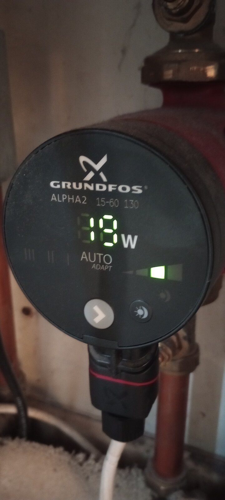

What is the pump make/model/mode/setting? If its a A rated pump with LEDs and you are not sure of its mode&setting, post a photo of the pump+LEDs, pump running.

OK, take a picture of the running pump ASAP and post it on, if its a grundfos UPS3 running at full speed then you will definitely get air ingress, but once we see a photo we'll get a good feel as to whats going on.

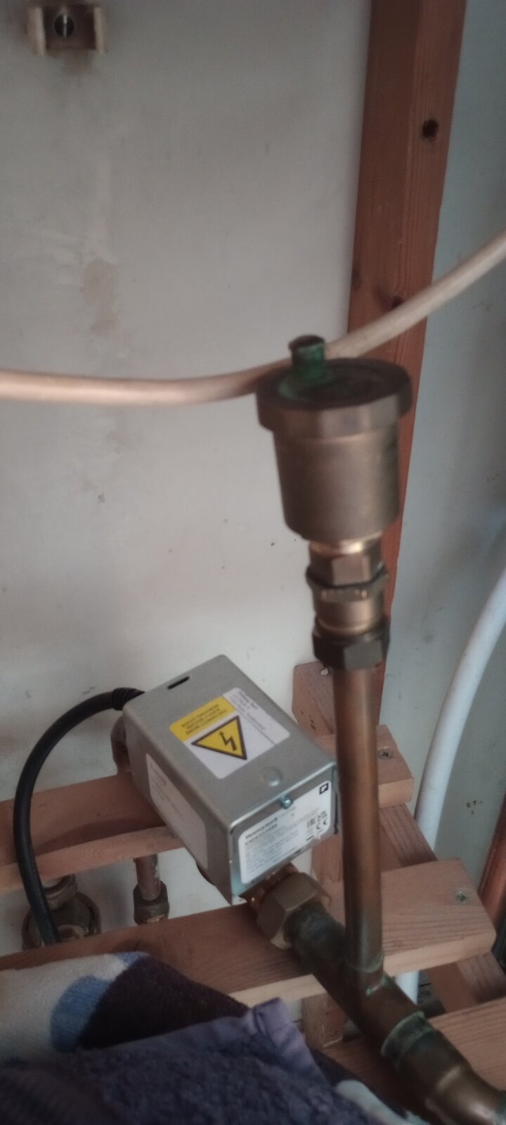

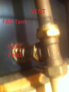

The vent thing in airing cupboard is on the way from actuator to bottom of hot water cylinder

Thanks, I'll have a look at the pump curves later but 19W indicates that it not running with a unduly high head so this is unlikely to be your problem.
The vent we are talking about is a pipe that goes right up and over the F&E (header) cistern, if you look first at the pipe going into the bottom of the pump and follow it back a bit you might see a biiger (22mm) and smaller (15mm) pipe teeing (joining) into this pipe, if not follow the pipe from the top of the pump (it might be pumping downwards) and ditto, post a photo if you locate them.
