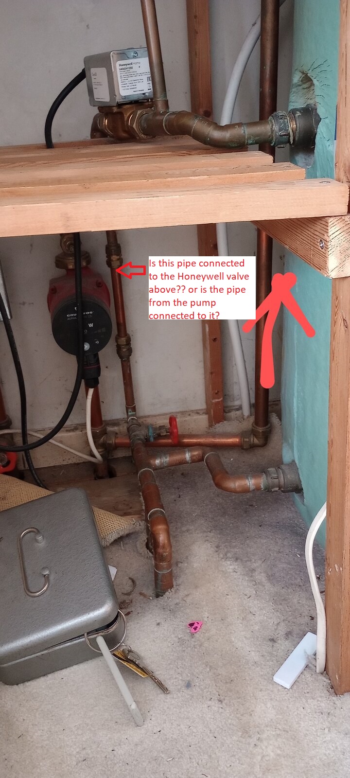

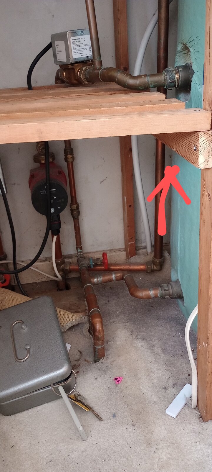

This is the jumble of pipes, the red arrow on one photo leads to the other red arrow where the pipe seems to split to two sizes

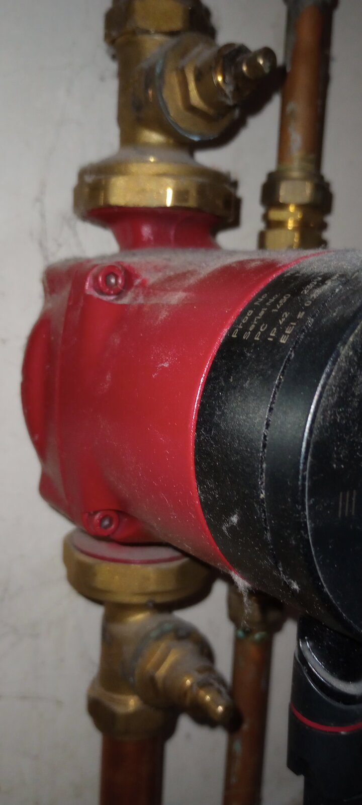

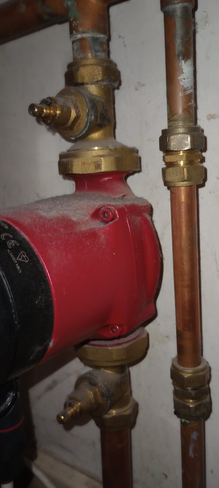

Can you look on the sides of the pump (red) body, you will see a indented arrow(s), is it pointing upwards or downwards?
No obvious arrows

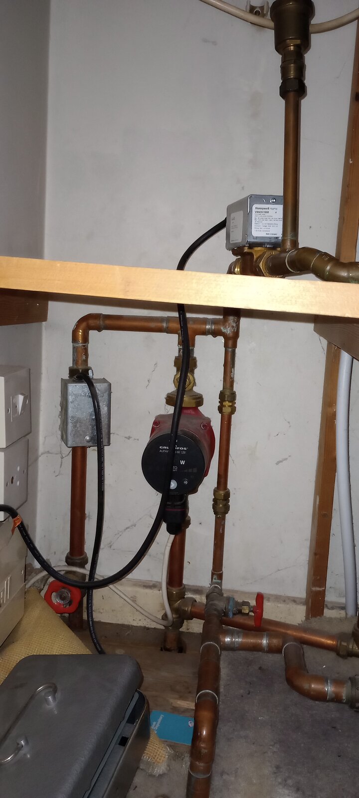

Can you see which pipe is going to the Honeywell motorised valve?.
Hope this is clearer? You're not near Reading are you? ;)

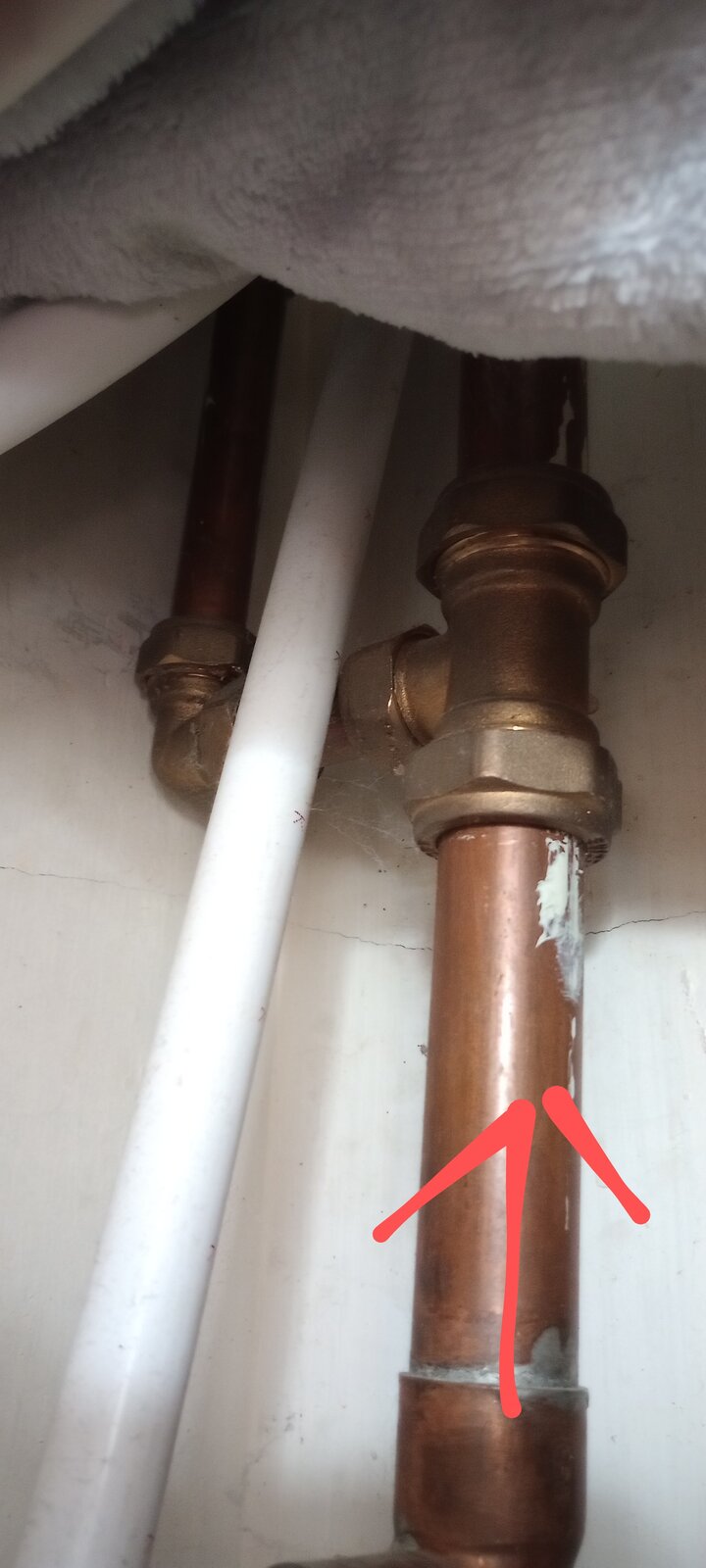

Is the pump located upstairs or near the boiler? (downstairs?) If you go to the boiler see can you identify the flow pipe, it will be the hotter of the two, follow this and see if you can see a 22mm vent pipe with another probably a 15mm pipe, the cold feed, very close to it, within 150mm or so, both teed into the flow pipe. These would normally be much closer to the pump than to the boiler.
Startng to lose me now. The pump is upstairs but about 6' from the boiler.
