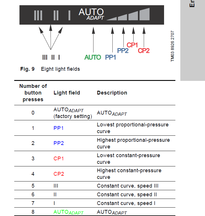

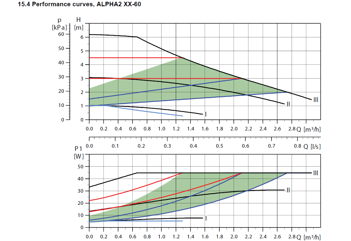

Problems I'm afraid, the pump is set to max, ie LED III illuminated which is over 6M, even if pumping NIL, the power output should be 33W but its only indicating 14W so, either the pump is knackered or one of its inlet or outlet valves is closed or the pump is completely dry (unlikely), it's easy to check the inlet and outlet valves, these are located immediately below the pump and just above it, get a adjustable spanner or the like and turn the valve spindles, there should be 3 to 4 full turns between fully closed and fully opened, full opened is 3 to 4 turns anti clockwise from fully closed and vica versa.
When you have checked the valves fully open you might just change the mode by pressing the setting button until the 3rd LED on the right is illuminated, that mode is CP1 which is a constant 3M head, check the power W, if not reading at least 13W then no flow, should be reading ~ 18 to 20W, 0.6m3/hr, 10LPM, typical flowrate at a 3M head.
Depending on readings, above, the pump should be isolated by shutting the inlet and outlet isolating valves, the complete pump head can then be taken off by removing the 4 securing stud bolts and the pump ports and impeller inspected for sludge/scale etc.
EDIT: Just read your post and based on your findings then it points (now) more to pump problems which can fairly easily be identified as per above.
ok ive just refilled and bled the rads again and turned on the CH & W ill go take a look at pump again. at present its on the III and 36w
You are pumping ~ 2 to 2.5LPM, not a lot.
Just in case I'm looking at the wrong version of the Alpha2, when next its pumping showing 36W or near that, just shut the pump outlet (top) valve
briefly for about 5 secs or so and see and note if the power falls off, then re open it.
Will do, at present all rads apart from 3 boiling hot and water slowly getting warm but I'd expect that with an immersion tank from cold(I hope)
Very good, think you have a 36W pump but your test will soon confirm.

I would first establish if the pump is performing properly by just shutting that outlet valve briefly as suggested, if the power falls to 20W or so then you know that the pump is working to its max capability of 35/36W and move on from there.

ok shut top valve power dropped down to 29/30w then when opened again i could here water flowing back into pump and its gone upto 35/36w again, one of the three radiators is now working, ive still got to finish closing the working ones off.
