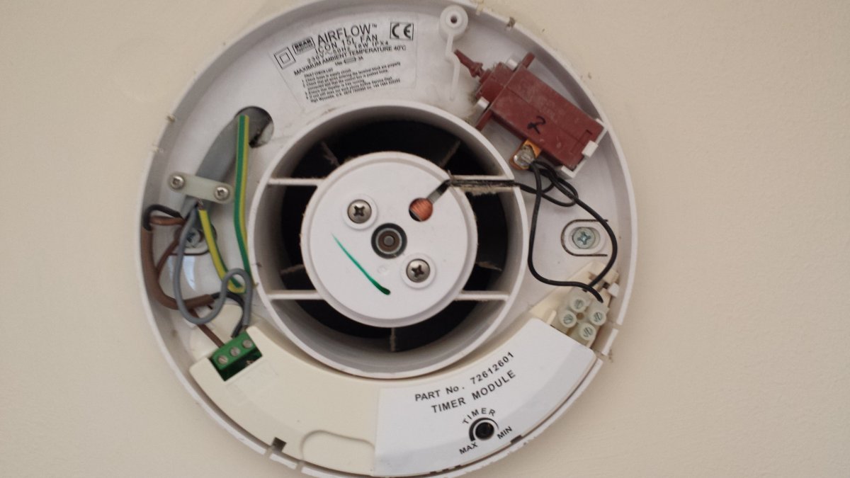

Hi
I have a airflow icon timer unit and all is well it turns on when i put my light on but as soon as i turn the light off the fan goes off? Is this right i thought the timer bit is supposed to run the fan a bit longer after switch off?

Hi this my fan....Just wondering if its wired right as it goes off when i switch the light off and does not run on must mean theres no permanent live?
Hi this my fan....Just wondering if its wired right as it goes off when i switch the light off and does not run on must mean theres no permanent live? Thanks
As you've been asked (by implication) did it ever work as expected? Without the instructions, it's impossible to tell whether it is wired correctly.
If you had got the permanent live and switched live feeds connected to the wrong terminals of the fan (i.e. 'swapped') it would function as you describe - since the feed to what is meant to be the permanent live terminal (which is what makes the fan work) would only be present when the light was switched on (since it was being supplied by a switched live conductor). If that's what you've done, then just swapping the L snd S/L wires ought to cure it.

The top (green) terminal block should be right to left N, L, SL - looks like it is 'possible' your L and SL are the wrong way around.
The correct way is not to guess but test the purpose of each wire and terminate correctly.
Indeed - and, as I said, that would result in the functionality the OP is describing.
Agreed. However, in this case, I think a valid test of which is permanent live and which is switched live is to connect them (both ways around) (and together with a neutral) to a timer fan (any timer fan :) ) and determine which 'worked'. Alternatively, another valid test would be to link together the L and S/L terminals of the fan and try connecting, in turn, each of the available conductors to one of those terminals - with one (perm L) the fan would come on permanently, with the other (S/L) it would only come on when the light was switched on. 'Testing' does not necessarily requires meters or voltage indicators :)

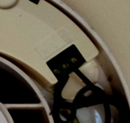

It IS. The markings are just visible.
Better eyesight than me :)
I agree. It's not as I would have connected it.
I also agree. As I said a few posts back, it's about the only single fault/error that would result in what the OP is experiencing. As for not being as you would have connected it, you are presumably assuming that the sleeved conductor is the S/L. That's certainly the way that I would do it (and probably also you), but ..... !!
Kind Regards, John
Yes but more the other way round - brown would be permanent live.
Well, yes, that's what I meant - so (assuming that grey has been used as neutral, albeit not sleeved) the black sleeved with brown would be the "non-permanent" live :)
