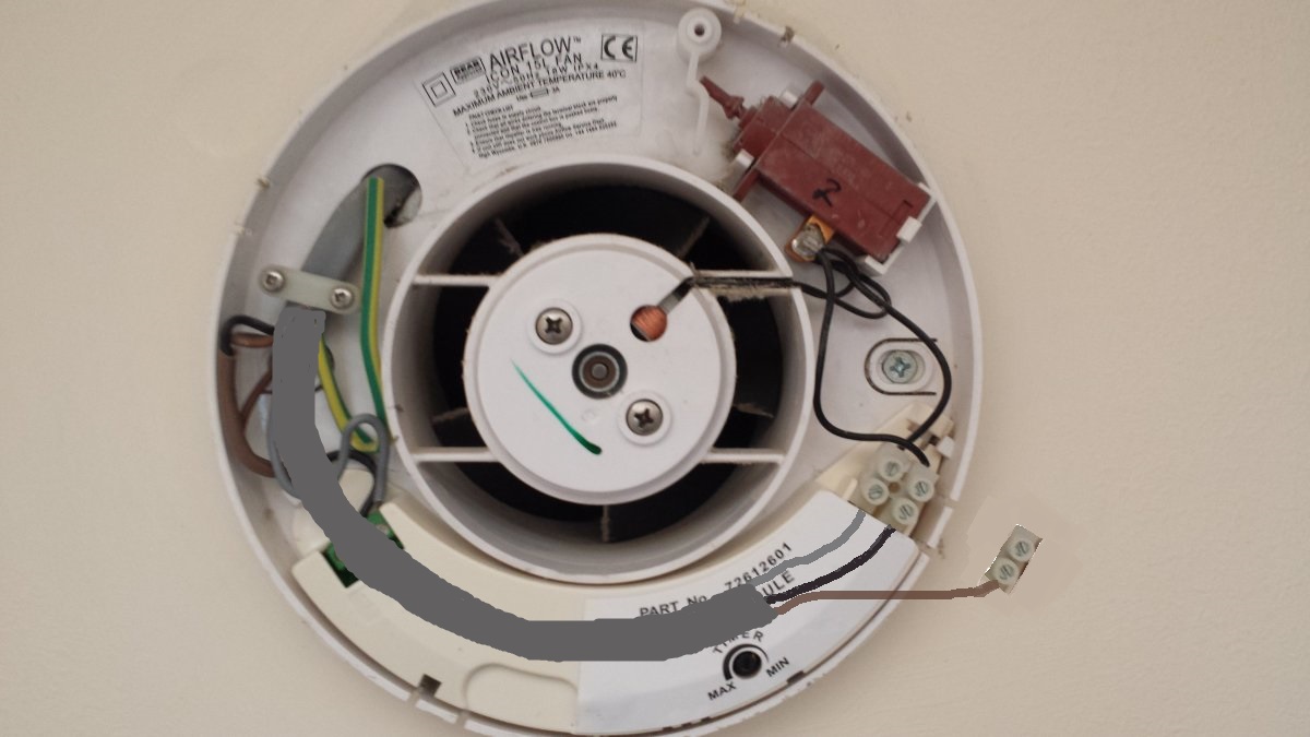

These fans can be used without the timer module (you have to buy it seperately in fact). So, isolate everything and undo the cable restraint and see if there is enough slack in the loft to pull some extra cable through and connect it like this....
(brown sleeve should still be on the black BTW. And the CPC can go into a connector block also)
...without the timer module in there at all of course and with the permanent live in it's own seperate connector block. If the fan works fine wired like this, then yes, you need a new timer module.

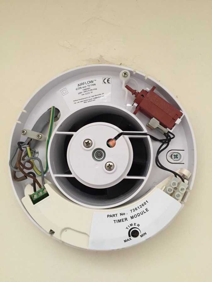

Hi
My icon airflow fan has just died in the bathroom so I bought a new control unit still did not work so i bought a new fan wired it in and still not working??
So now I'm stuck would it be the isolation switch to the fan that is faulty or is there a fuse somewhere ?
Any help apprieated

Is that on the input side of the timer module?
I cannot see how those terminals are marked.????
You should have brown in L, grey in N and the black (sleeved brown) in the T.
Then. With the light off - you should have mains voltage between N and L and nothing between N and T
Then, with the light on, you should see mains voltage between N and T
Does that check out?
Hi it checks out until you put the light on there's nothing showing between N and T
OK, so thats where your problem. T has to go to 230v to start the fan.
You could try linking out L and T with a short bit of wire just to see if the fan&timer work.
Then you'll have to trace the wire back and find where the black wire goes. Check in the isolation switch first, the 3-core&eart cable may be connected at the light fitting…
