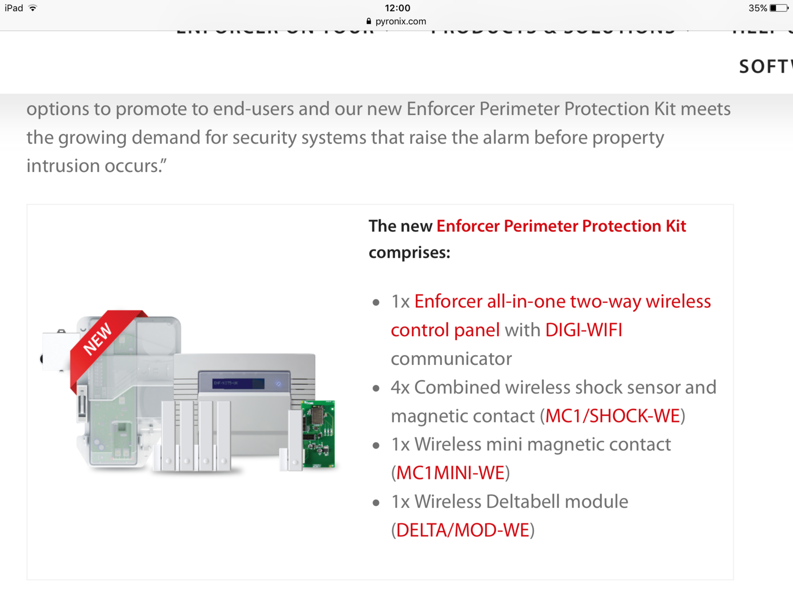

What pet ? To be honest found most wireless pet sensors to be rubbish , hardwired I would only use Bosch or Optex pet detectors , Pyronix have just launched a perimeter kit with 4 shock/ contacts, plus contact , this may be one of the easier panels for a diyer !
