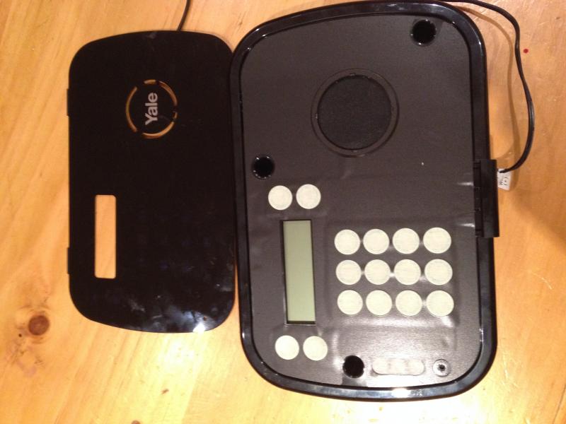

What is in the wall fitting kit 3 screws and 3 wall plugs?
Nothing in the manual to suggest how it would be fitted to the wall, but are the screws long enough to go all the way and into the wall?
That's right. Three screws and 3 wall plugs. Using them I can mount the wall plate perfectly.
The engineers manual lists the wall mounting screws/plugs in the contents but make no mention of doing so (or dismantling the display in any way)
I suspect it's not going to be possible, But if anyone's done so, I'd be extremely interested to hear.
Okay.... so in case it's of use to anybody else with or considering one of these panels, it turns out to be embarassingly simple;

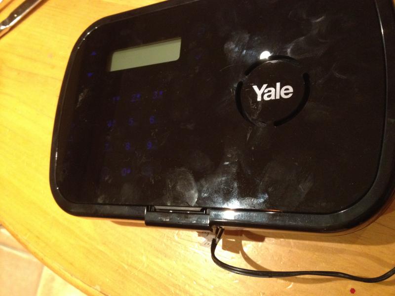

locate the small tab at the bottom of the panel;
pull it down:
voila.. the front panel lifts off, revealing access to the wall-mounting points!
