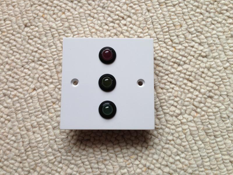

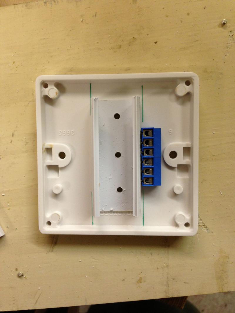

Alarm status traffic lights

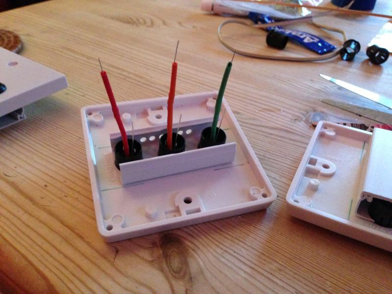

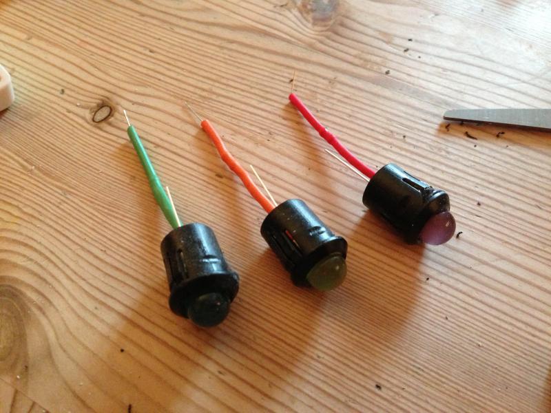

Thanks, the resistors are inside the heat shrink.
Green ones are slightly higher value as the green LEDs were brighter.
Thanks for your comments, I'm pleased with the results

Yeah, I always use a bit of two part epoxy to hold led clips in.

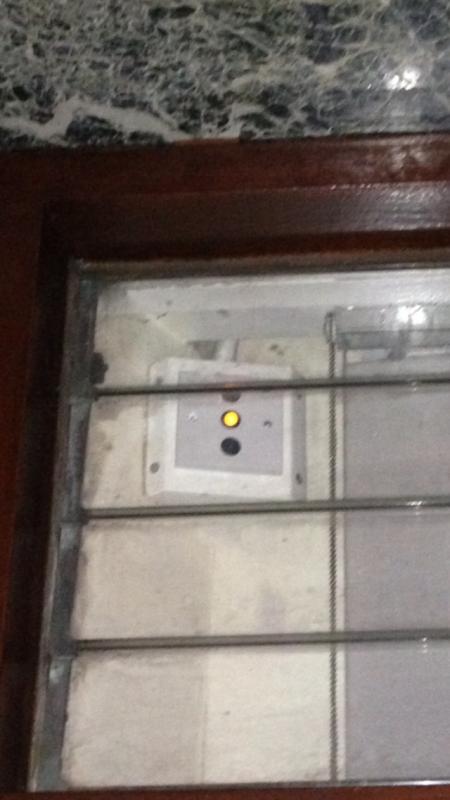

... At least my ones look authentic!

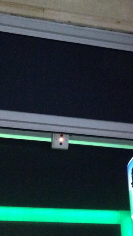

Just wandered to the local, past two banks and they both have these panels on show through the front window.
Hope you're not on the local CCTV, you might be getting a visit when you have been identified. Taking close up pictures of a bank!
