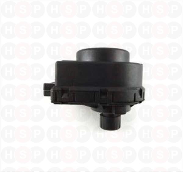

Part 30:
https://www.heatingspareparts.com/boiler-spares/partno/1.018064?id=316792

if the gland is passing water there is a good chance that it has damaged the actuator and that is what is causing your problem, remove the actuator and switch the heating on , note the position of the piston then run a hot tap and see if the piston moves, if it doesnt you need an actuator too

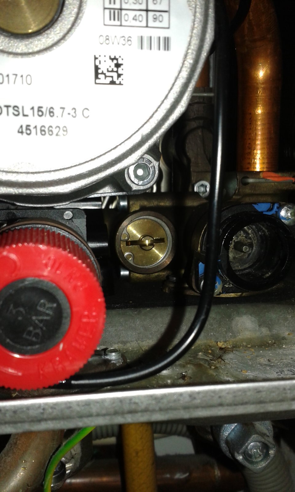

The actuator is dry but i will check it. Having a problem undoing the drain valve, see pic. It won't budge. It should just be 1/4 turn shouldn't it ? I'm now thinking i might damage seals in it if i try too hard. should i just drain down at radiator drain cock ?

The actuator didn't move when hot water running but heating outlet was getting hot. So i turned the wall stat up and left it running. All rads now getting hot. I can push the actuator pin in, it's got a strong spring (i thought it would be just motor driven in or out) when the heating switched off the pin pushed against me and when flush with it's body, went click. Can't push it back in now. So it could be sticking.The strong spring maybe a problem when i look inside. I've got the repair kit for the diverter valve which is just the end cover/seal, rod and disk with two seals on it. I'm going to do this in situ. Hope i don't loose any bits inside when i pull the pin out. So the problem was/is the diverter valve or actuator and not the pump or anything else.
Just an update. I bought a aftermarket actuator that didn't fit. It looked identical to the original but was 3mm deeper and wouldn't fit around the casing. So check the size if you have a alpha CD28C. The body needs to be 70mm not 73mm. I took the original apart and found that the brass push rod had been fitted with a steel E clip which had rusted and come off. Got a box of E clips for £2.70 from toolstation and fixed in minutes. All working fine now. Many thanks to all those who gave me advise and steered me in the right direction as i probably would had bought an unnecessary new pump.
