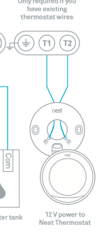

You need live and neutral to the heatlink which you have, leave to 1,2,3,4,5 and 6 empty, connect 0T1 and OT2 to 44 and 41 on the boiler, are you using the connections at the end to power your stat ? and leave the orange link in the boiler.

No, the thermostat will be kept on a table in the stand, powered by usb, my combi boiler had no thermostst installed any way, so no writing to use.
I will be back at the property tomorrow and will wire as your instructions:
41/44 on Boiler to goto OT1/2 on the Heatlink
L+N on Boiler to goto L+,N on the Heatlink. [Aside: this seems be just to power the Heatlink, I could just take 2 wires from a plug outlet and power the heatlink?]

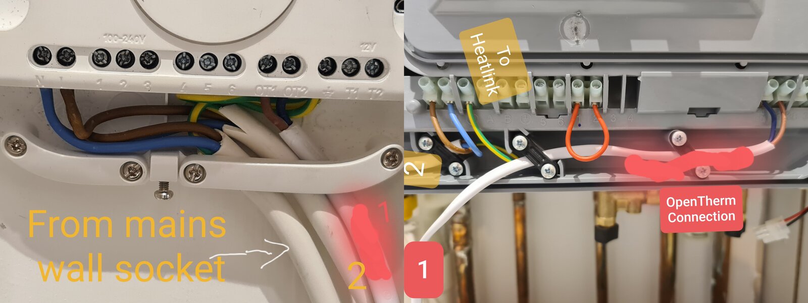

Ok, so, plumber connected things - attaching pics...
1) From the boiler OpenTherm connectors (41/44) direct to correspondong OT1 and OT2 on the Heatlink
2) L/N/E from Boiler to L/N/E on Heatlink, and from there to power socket. (plumber har already cut the power cable on the boiler, so, found it easier to wire that way)
Picasso/Ian, everyone else.. thanks for your help - havent powered on the boiler yet - can you please give a once over before I flick the switch?
yes looks about right , have to say though it is a mess , why didnt you just buy some 4core or 5 core and get rid of that spiders web ? you will have to go into the boilers set up menu to tell it you are using non-manufacurers controls, it is just a bit of button pressing
Thanks Ian. I will turn on the boiler tomorrow when i get back to the property and change the settings to alternative control.
I would've used a Nest Pro Installer, but couldn't really get anyone where i am due to lockdown - the wiring is a result of the plumber deciding to do it all by himself - I will get some 5 core cable and redo the wiring once things settle down at the house.
